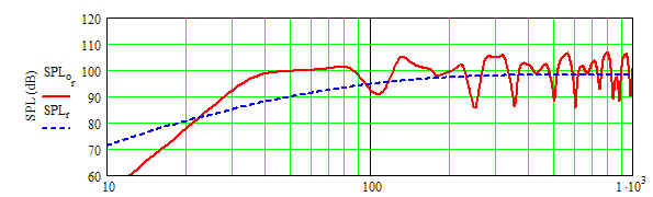

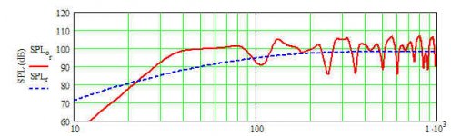

sorry not FR - Like to have good (not reflex if possible) enclosure for Beyma 12CX whose woofer section is at least as wideband as Beta 12LT - goes to ~7Khz on-axis. (tweeter is ~ like APT50). wonder if TQWT would work well? What enclosure might be good for this Beyma?
Greets!
L = 138"
Sm = 440"^2
zdriver = 30"
So, assuming 3/4" (19 mm) material thickness (all dims i.d.):
h = 69"
d = 24.96"
w = 17.625"
GM

Impressive. That Excel calculator you've put together is a Godsend BTW Greg. Many thanks.
