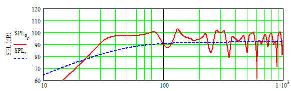

giantstairs said:
A question for the experts -- how does the beyma 8bx look as a bib candidate? Anyone familiar with this driver? i saw there is another thread about it but didn't see much of interest there. Is it unsuitable for a bib because it is coaxial? The specs look good, of course i'm not really sure what i am looking for with this enclosure.
Greets!
Not me, but I can tell you that BL, Mms, and Cms are off enough to make me wonder how accurate the T/S specs are, so as always YMMV:
L = 138"
Sm = 220"^2
zdriver = 30"
No, whether a driver is coaxial, etc. has nothing to do with what types of box loading are acceptable, and yes, from a BIB alignment POV this driver's PUBLISHED minimum T/S specs are near ideal.
GM

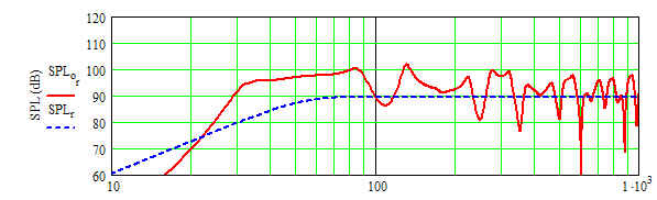

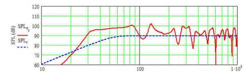

Greets!
Thanks! I wonder if these are still valid since he says the published Sd = 216 cm^2 and the current specs lists 220 cm^2.
Anyway, no real difference in the BIB except it's better damped, ergo rolls off a bit quicker at Fp:
GM
