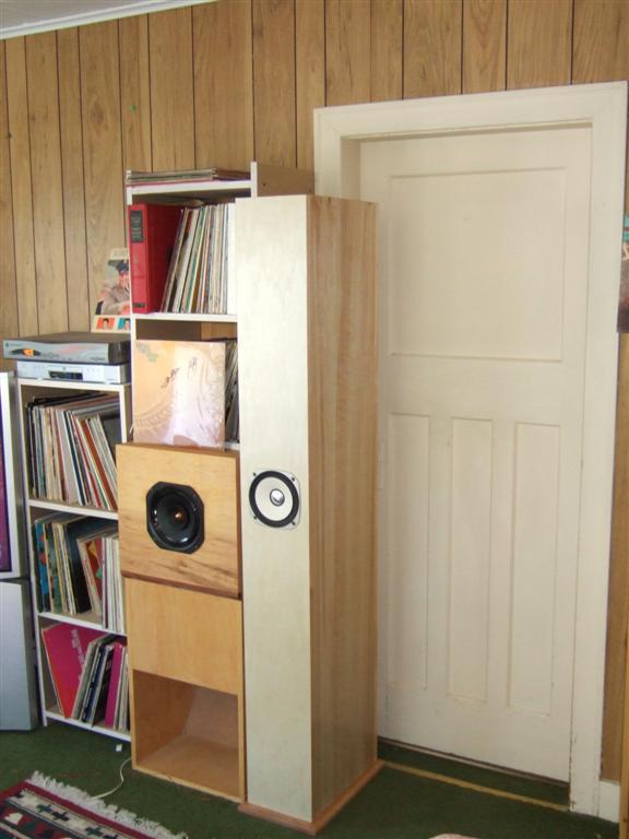

Just an update on my larger bib which were built according to scottmoose's initial size for the ff165k. They work really well, have heard lower bass than with any of my prevoius speakers. The midrange is also excellent, the bib design works. I tried wedging a short brace above the driver between front and inner baffle, but it sounded worse, so out it came. I use no stuffing and transformer wire for speaker wire.
Finished this one enclosure, poplar plywood, veneered edges, oak board base, 2 coats n-c lacquer, wet sanded with 600 paper.
Using Russ White preamp, ska gb150d amp.
cheers
doggy:)

how loud
A subjective answer Scott is: The bib reaches loud levels cleanly, louder you can hear more of the micro details, loud enough that it makes concern for the neighbours. I will have to pick a day when no one is around.

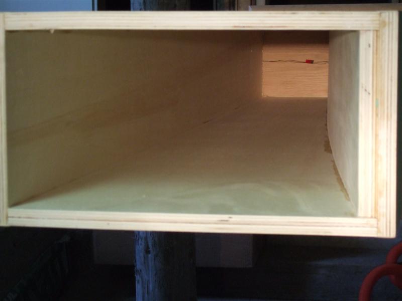

My construction is a little different also. The inner baffles have a natural curve, to give the back horn a little exponential flair.

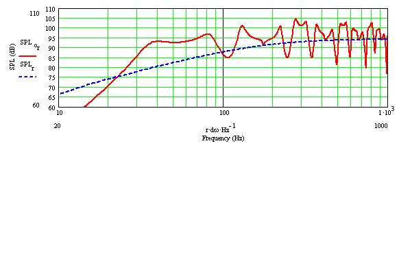

Have you sim'd this size bib to the ff165k? can it be done to check the response?

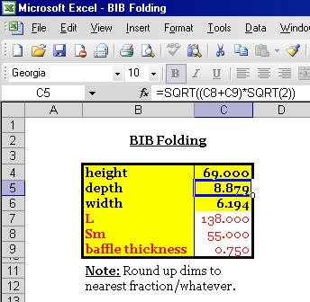

zek said:
Maybe I'm wrong, but an Excel seems incorrect.
How can you summ Sm in sqr inch (C8) with baffle thickness in inch (C9)?

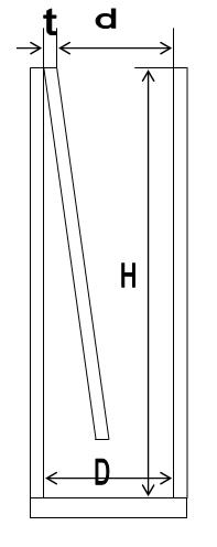

zek said:
My 0.2
D=depth of enclosure
W= width
H= height
t= baffle thickness
d= depth of throat
Sm = W*d
D= d+t
H=L/2
d=sqrt(Sm*sqrt(2))
W= Sm/d
D= sqrt(Sm*sqrt(2)) +t
All dimensions are internal.
p.s. Maybe I'm wrong or not
Nobody have any comment on my posts (#908 & #909).
Am I totaly wrong or not :smash:
http://www.diyaudio.com/forums/showthread.php?postid=945855#post945855
http://www.diyaudio.com/forums/showthread.php?postid=945862#post945862
Looks like you're on the right lines to me.
Doggy: your results with the 165 tally with mine -that miniscule Xmax doesn't seem to be an issue with this load. One of the few times I've ever heard an FR driver do a convincing job with rock. Yes, I have simmed this enclosure with the165 -I'll see if I can dig it out for you.
Colin -ditto. I think I abandoned it because I felt the Fs was too high to be really worth continuing, though as there seems to be an interest in baby BIBs, I'll recheck and get back later today.
Here's the 1/2 space response for Doggy's 165 BIB. Methinks he'll find a certain similarity at LF between the subjective sound of the BIB and his dipole -both Dan and I have found this in the past. Odd. But I'm not complaining!

Thanks Scott for response graph, and I will look for that cd. I don't seem to miss that 100 hz dip. The bib's amplify low freq. back ground info.really well.
