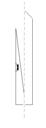

Scott,
In some other thread you once posted
"...and they really do need to go in corners as the rear boundary condition increases the mouth area and decreases reflections back down the line..."
Would it be an idea to put something like a "deflector" on top of the cab?
just enough to prevent any reflected wave from reaching the bottom
plate directly ?
so that'd be over half the cab, see dotted line:

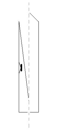

plate directly ?
well, to bad I haven't got the opertunity to corner-placement...
just a perfect flat, concrete ceiling wich I'm affraid will reflect
too much straight back into the pipe....
So I'm thinking of some way to prevent straight reflections entering the pipe
suppose I could make the backplate longer and than add a deflector
(no choking, just a boundary for reflections)

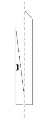

Hi!
I have tested the deflector as you described. I lost bass as it was pointing forward. Not qualified guess is that you loose loading that way. Becomes more like a front loaded horn.
I tried also having the deflector pointing backwards. No loss of bass but some resonances in lower midrange was more prominent. So I went back to the normal mouth.
My BIB's are standing at a wall, also concrete, no corner loading. So maybe it will different with corner + diffusors behind speaker with deflector pointing backwards.
Peter

OK, without going too technical, it's not really the ceiling that's going to cause problems -the ripple is caused by the under-sized terminus and even against a rear-wall will be dramatically reduced as the mouth CSA is doubled by the reflection-boundary condition. You see it in all hybrid BLHs, chamberless or otherwise, to different extents when you reduce the terminus / mouth size, so ripple increases due to the impedence mis-match & various other things. Yes, you'll get some reflections, but their influence is relatively small compared to other matters. & your rear wall is already deflecting the energy away from the terminus.
Hi Scott!
I never thought the ceiling would be a problem, thats was not why I tested the deflector. My test was to reduce the mids coming out from the mouth. I believe that with some kind of diffusors (not damping) on the walls/ceiling would work. (SAF is in play here) My goal is to take away damping in the speaker!
Cheers

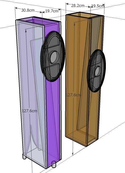

Hi
I have a pair of Fostex FE126 drivers, and I was planing to build Frugal horns for them, but after reading this thread (well, most of it) I changed my plans in favor of the BIB.
While googling for bibs I found two 3d models (done in google sketch up), both of them for 126/127 drivers.
One is normal BiB and the other one is inverted design with K slot which is mentioned earlier in this thread.
The designs are consistent with info on www.zillaspeak.com (and the excell sheet I found in this thread). So I will go for one of these.
I really need you opinions. Which do you recomend?
The inverted design looks nicer to me, but I don't know how the floor loading and K slot compares to normal design. The placement needs to be as close to the wall as possible (not in the corner) - and I don't know if that is recomended for floor loaded version (especially concidering the slot in the back)
I don't know who is the author of these models (google says anonymous) so I can't credit them. Sorry

cheda13 said:While googling for bibs I found two 3d models (done in google sketch up), both of them for 126/127 drivers.
For some reason -- even thou logged in google didn't capture my name ...
When i started thinking about the BIB for 126/127 the short hieght encouraged me to invert them to take advantage of floor loading since the ceiling would be far away (the brown render preceded the purple one). Further, the idea of k-slots had been thrown around (here or on the Full Range Forum) and i realized it might well work to ameriolate the one problem i had with the one set of BIBs i had heard -- ripple was noticable especially in direct comparison to A126, Frugel-Horn or Fonken.
The dimensions are taken right off Jeff's site -- IIRC these are the bigger version.
When BIB gets to the top of our queue we will be doing the iBIBk with side slots -- Dave Cigna suggested that IIRC.
dave
