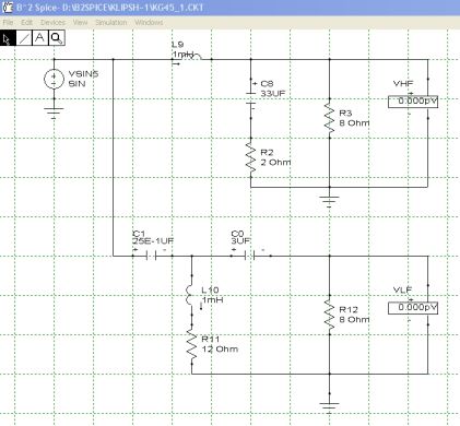

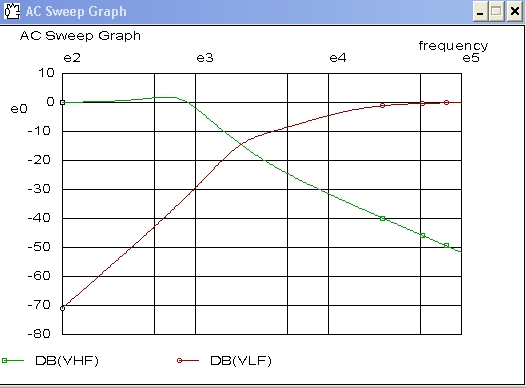

I did a Spice simulation on the crossover just to have an idea of what the transfer function looks like. For convenience, both drivers are at 8 ohms.
Crossover is about 2KHz (12dB/oct on woofer, 18dB/oct on tweeter). We can see the effects of the "tuning" resistors. On the woofer, it created a bump at about 800Hz. The opposite is true for the tweeter. The 1mH+12 ohm pulled the tweeter down before roll-off.
My guess is acoustically, the woofer is rolling off early leading to the vocal receding into the background. The extra lift brings the voice slightly forward.
The horn response, on the other hand, is not flat. Perhaps like a CD type. By pulling it down, it flattens the response.
How they sum acoustically is impossible to tell unless a FR sweep is done. However, we know that it's difficult for a 10" to reach up to 2KHz. I would speculate that the vocals, particularly male voices, will have difficulty.
With regards to the sibilance and sizzle, that could be attributed to some peakiness in the tweeter response.
Again, I am simply thinking aloud. I could be completely off the mark.
Wow, Michael. Thank you. (I have to get motivated to learn LTSpice!) BTW, the Re on the woofer is 7.2 ohms and the tweeter is 8.1 ohms. Does that mean the modeling with 8 ohms should be pretty close?
I'll bet the tweeter is being used about as low as it can go before getting really honky. The tractrix horn is probably not designed to respond down to 800 Hz. Its opening is roughly 185mm W x 110mm H (7-1/4" x 4-3/8"), if that's any help.
So the woofer's upper end is boosted to make up for that. I can see why putting the Zobel on the woofer only made things worse. If you diminish that electrical 800 Hz boost, the mids recede right where we're very sensitive to them.
The speakers are kind of "scooped." It makes them sound "warm" except for the aggressive nature of the upper mids from the horn. Not unpleasant.
This speaker has a tractrix horn. I read up a little about CD horns and the need for response shaping (high freq boost necessary about 15kHz?). But couldn't find anything similar about tractrix horns.
Considering the approx. 2kHz crossover point, it sounds fairly acceptable on male voice. Those Klipsch engineers were pretty sly.
