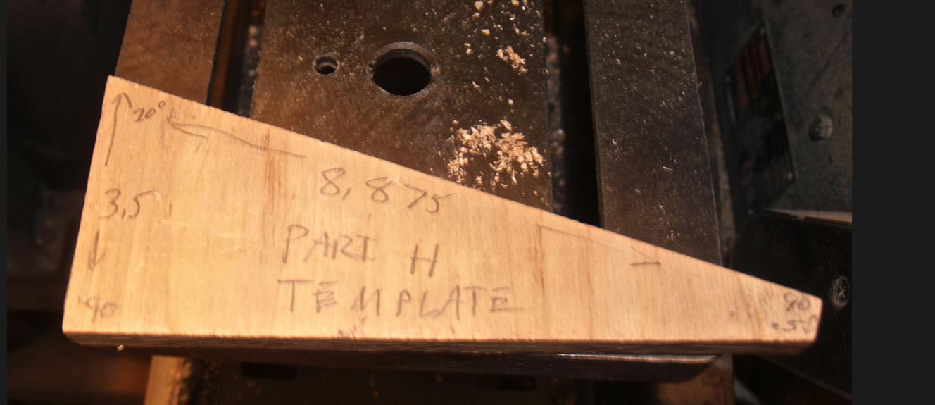

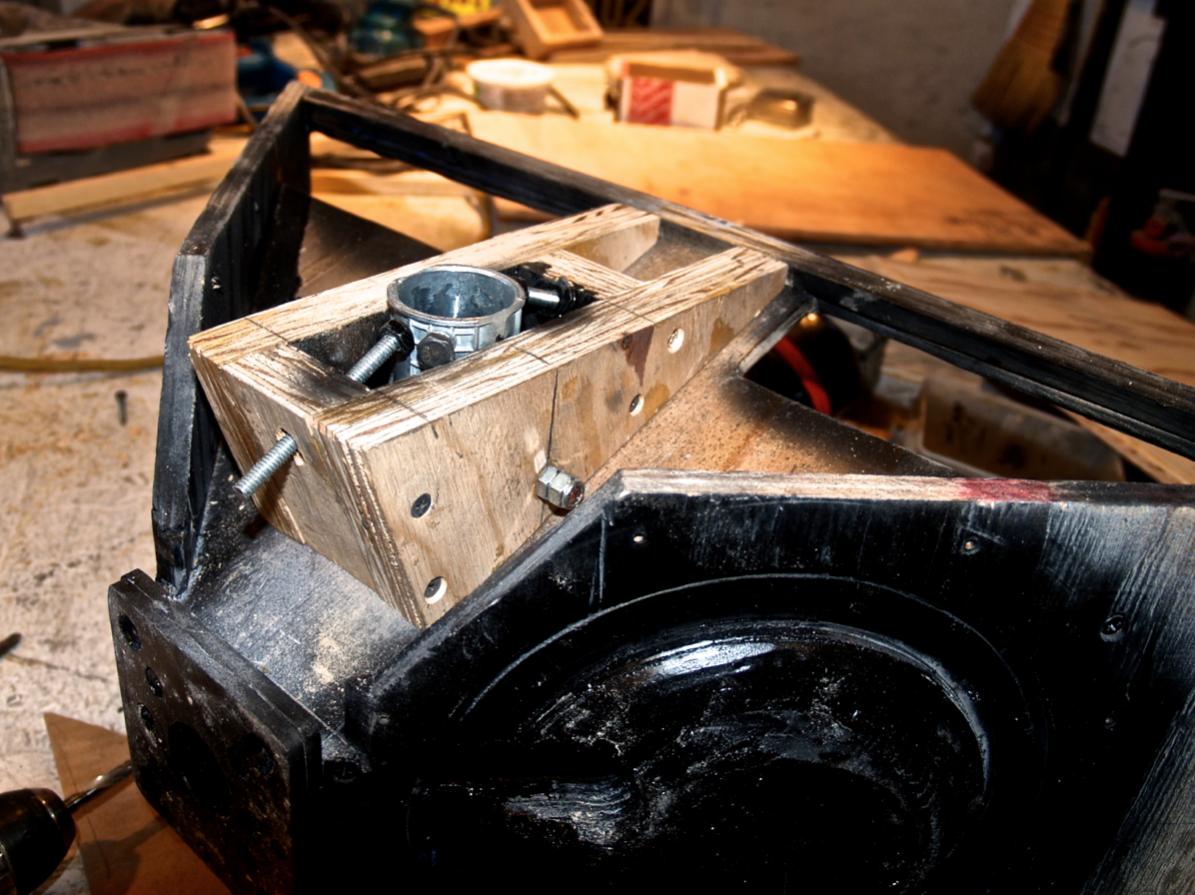

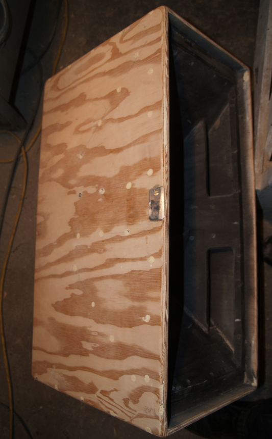

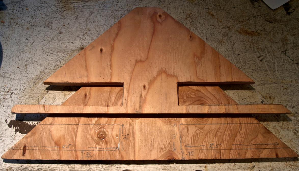

The drawing in post #41 shows the ports in red as built, the angled port walls would have interfered with the tilt assembly and would not have given the desired Fb (82Hz).
The pictures below may help you understand the port configuration. If you are not using the tilt assembly (you will want it for other applications...) just use four part "H".
