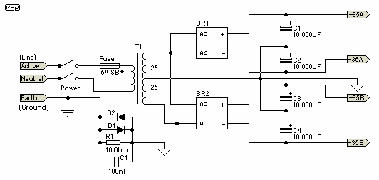

I would keep it all floating unless you have hum and noiseproblems,if so connect ground to main heatsink = earth. But not with a straight wire :
Power Supply for Power Amplifiers

The input terminal ground measures 9.8 ohms to the output terminal ground and to the PS ground.
The PS ground measures short circuit to the output terminal ground.
I think the amp is designed that way, the R39 lift the signal ground 10 ohms above the PS ground.

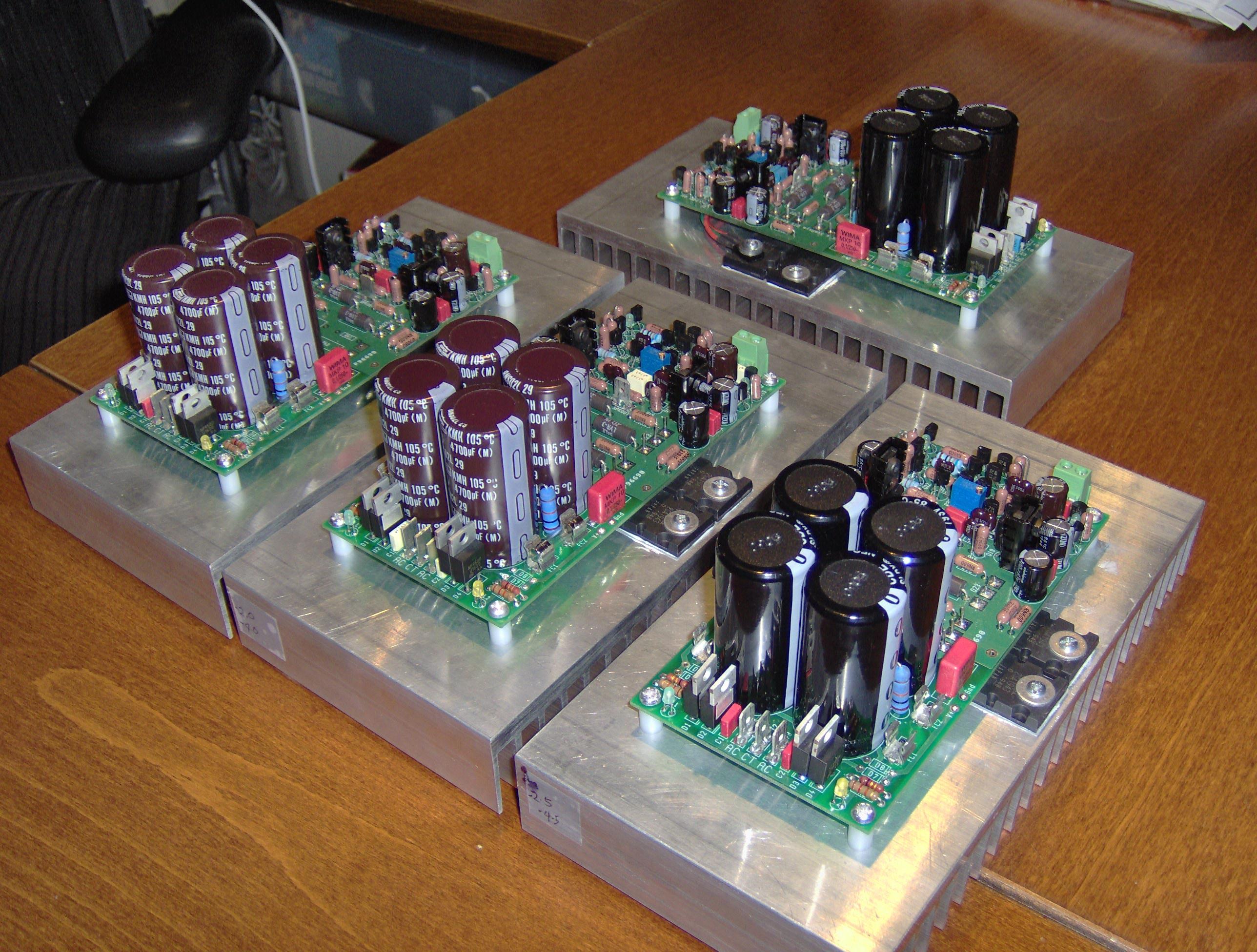

Thanks Al for your response. I did try played some music and its sonic performance is pretty good. I haven't tried for longer listening since I'm still working on three more boards. I'm done with 4 channels and three more to go for a home theater 7 channel amp. The four channels would be just the 60watt version.

No problem Al, I'll keep you posted. I still have a long way to go and one of my problem is the case for my amp.
I'll try experimenting as what you mentioned. One of my purpose in building a 7 channel amp is for biamping.
