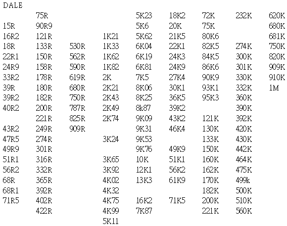

For people who can't get all of their Daleresistors, I have a good source :
eBay Store - SavvyAudio: Audio Military Resistors, UK Military Audio Resistor, JAPAN FUKUSHIMA Resistor
