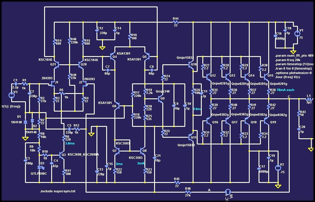

Referring to the post where I mentioned my new triple .. I did build it as well as simulate it . (those 2 things usually happen simultaniously ) I chose to use BJT's because when I do the final version, 5 pair of the 21193/4,s or the 0281/0302's are dirt cheap here. (2$ and $1.40 ea.) . With these OP's , especially the first ones , 10A of DC SOA @ 80V is all mine. 20$ a channel for that much "oomph" is a deal.
I have been using the amps in post #1 as the test bed for ,1. mosfet OP's.. 2. input stage / vas mod's and 3. ,the new T3T triple(BJT). The last mod (the triple) did the most for the sound , the bass especially. I have ran each variant that I have offered here for 2 weeks plus (movies / parties / general listening). My final choice is the last one (supersym -T3T) . It has by far the best value vs. sound and is ridiculously stable as well.
What has totally amazed me is that I have not burned one out yet. I am running on just 3 pair OP's with 1 OP pair as the drivers into 4R loads at hefty volumes.(shaking the house/windows) NO , not even close.

I already have the soft start , which I designed on it's own board with a external trigger connect. I also am using 8A rail fuses to keep from making fires.
I did drink the "grog" one night and shorted an amp (big spark) . NO blown OP's !!! , all it did was blow the 8A'ers. when I do the final one a month from now , it will have the higher current OP's .... this calls for some protection!
It was mentioned that this amp is like the Electrocompaniet. It IS !! I did look at a half dozen older schema's and there were great similarities (and differences).

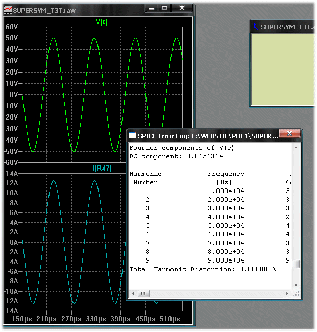

I also saw some one mention a lower CDOM. No problem, 47p and 82-100R LTP Re's will give the same 800khz UGP. Here is the "final" (yeah ,right!), Spice sim for this nice amp ... be sure to extract the .txt file to the same place as the .asc (models are there).

by eddelarue - the simulation presents lower distortion with R12=390R and R46=12k.
Yes , I submitted the simulation with class A bias ... r21 = 300R , it should be 485R (trimmer) , which equates to 80ma / per Op device. Changing R12/46 should be no problem either , I used a 680R/22k combo (better thd as well)...for the same gain plot response. All will equate to roughly 32db gain , but one might adjust the LTP degeneration to assure enough phase margin (stability is paramount).
OS
Edit , another point to make... the .0008 - .001 % is ALL loads and ALL frequencies and is obtained between 70 - 110ma per device (NJW21193/4 or NJW0302/0281) . If you increase the self type 3 driver current (R50/51 = 22R) , total distortion will not drop significantly, but H2 will be the only remaining component (H3/5/7 just "disappear")

Some say that is better (no H5/7), even mr. John Curl. 5th and 7th harmonic distortion products are said to be the main players in "harshness" or a "metallic sound". On the latest triple with the driver bias cranked up, a subtle smoothness appears that is missing with the standard 2 stage EF.
Another factor is the biasing , the T3T can stay within 1/2 mv Re on the Op's indefinitely. For these small improvements - 5 components... and it is as stable as an EF type 2. One could just build a standard DX type amp or self amp with a standard OPS , but there would be many limitations. BETTER ???, that is totally up to the application.

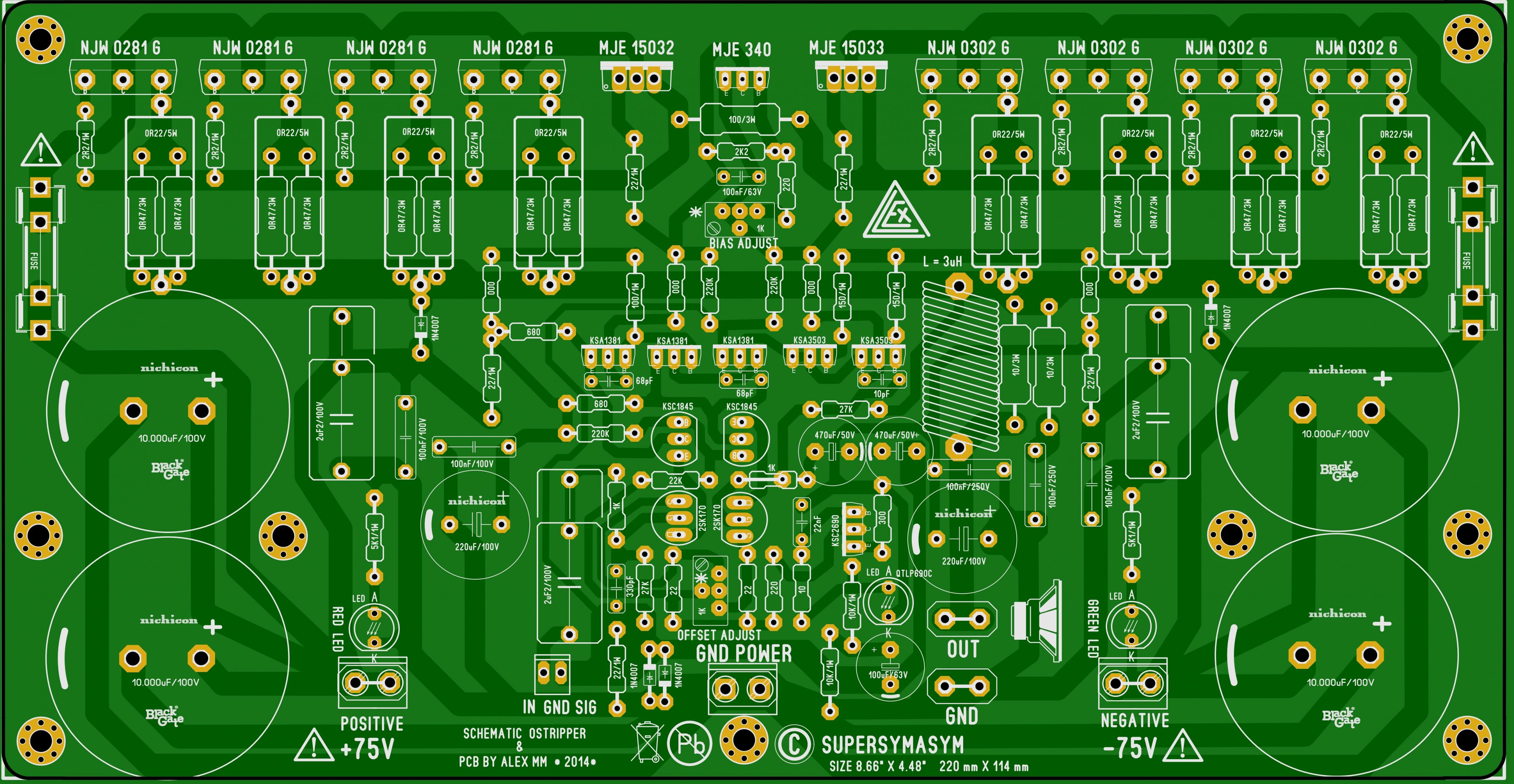

Hi Alex MM !!Hi MJL 21193 ,
I made for you the layout , I think It's acceptable http://i43.tinypic.com/2cx6d7n.jpg
Regards Alex mm .
PCB made great!

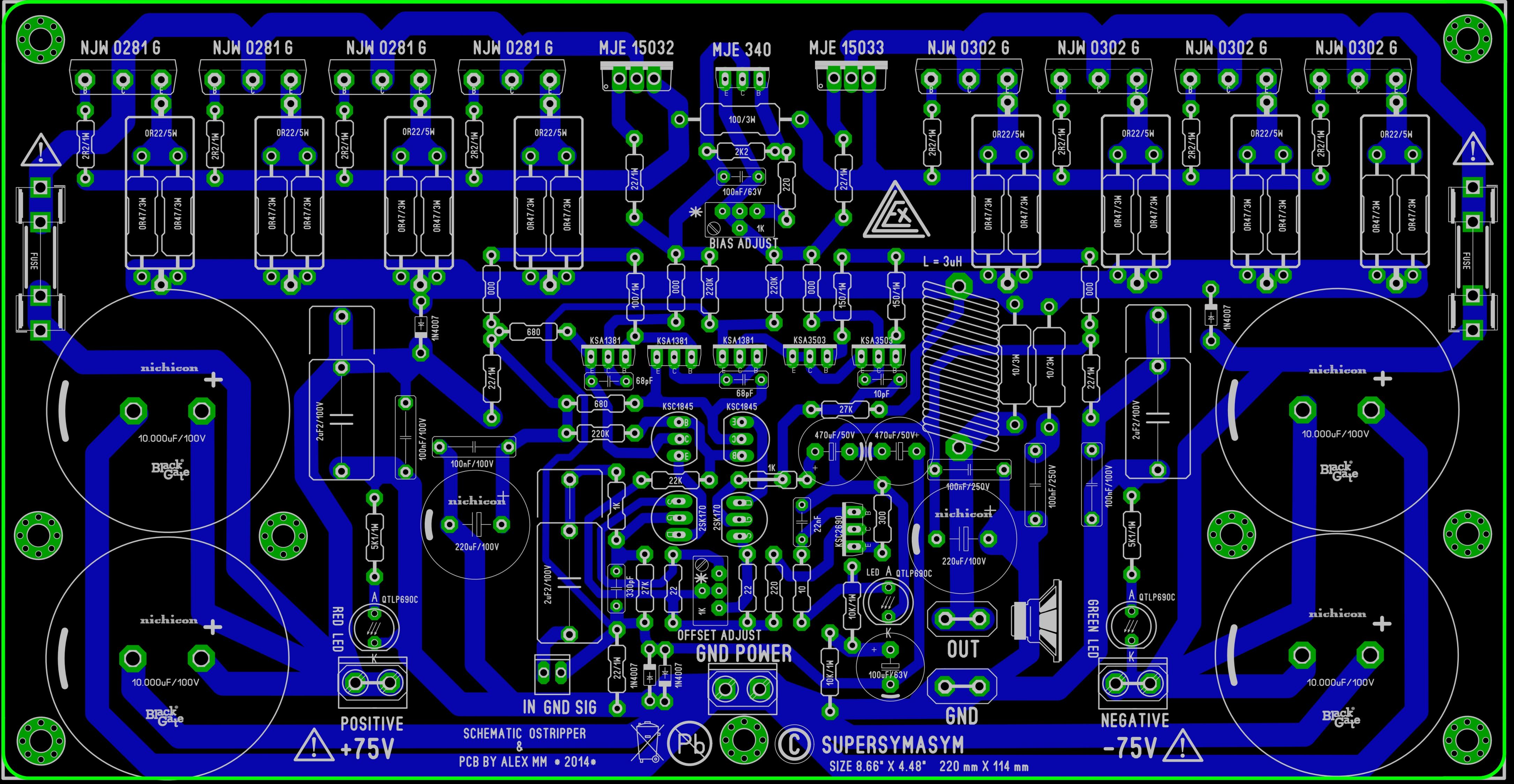

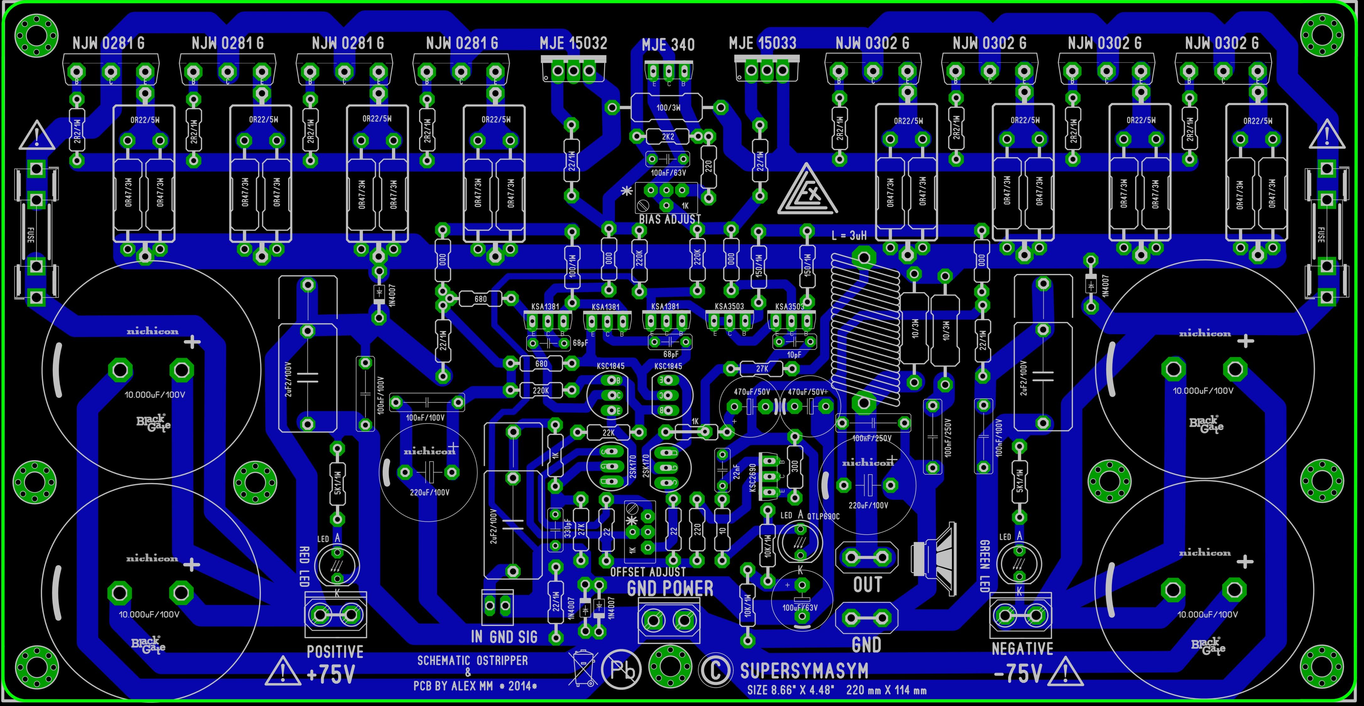

... OK @ maxpou attached you have PCB modified version ...
