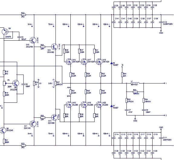

By homemodder - Anatech, try triple consisting of bjt drivers but mosfets as final outputs, gives very good performance and gets rid of the mosfets lack of deep down thump bass and involvement in low mid frequencies.
That is an interesting assessment , homemodder. Have you used the IRF's in this way?? I have been reading various info on MOSFET OP stages , and except for being biased "hard" into class A , many people (rod elliot - ESP) believe the non- linear characteristics of fet's in the crossover region make them undesirable as class B OP,s.
In the other camp , Quasi uses them in his NMOS amps , Ampslab and many others sell "hi -fi" kits using them. Using just 1 pair (IRFP240/9240), my scope tells me that at a much higher bias (120mA) , crossover distortion mimics a BJT pair at 60-70ma. Since I am making a separate driver board and have 77v available , I will try a triple. If you could , homemodder , could you just post a "clip" of this BJT-BJT-MOSFET triple OP stage (you can keep the rest a secret).
OS
Os I use them this way in several amps now, depends on the use, for subs I still prefer bjt outputs. I use the japanese equivalents. With this output and a frontend that is practically a copy of your design exept for cascoded fet input I get measured by a lab 0.009 thd at 120w output. With 3 pairs of 2sj200 youll easily get 150 watts 8ohm which is what I designed for, 4 ohm loads upto 240w load if you use good heatseaking, this is conservative but I have to think of extreme temp in car use. I dont see a problem using IRFPs for much higher power but I havent tried it for that. I find it more stable than bjt triple output and one gets good thd performance. As is I use in car amp to power mid and tweeters where I like the sound of these fets but it works just fine full range.

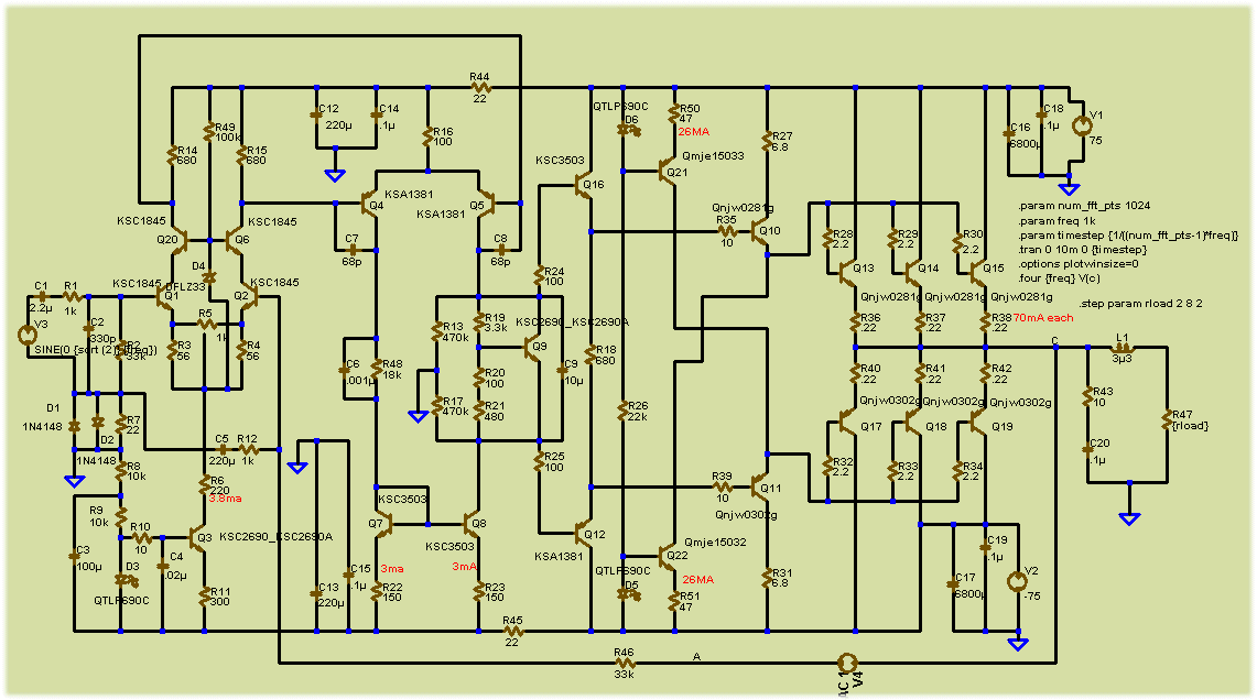

hi all,
I have this thing up and running for some time now, take a look at the cascode arrangement.......

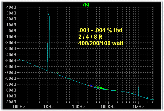

My latest upgrades have been implemented successfully with absolute stability. The most obvious thing that has changed is the bass "slam" with the "T3T" triple (attachment 1 ) .

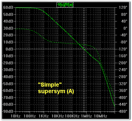

The other factors with the "new" version is the ultralow THD , which now is both load and frequency invariant . The cascode (I just added it) allows the use of SMD matched input pairs and lowers the initial offset to just .1-.2mV. FFT wise , I think one can not get much better (simplicity vs. low H3/5/7 - almost disappears). the OLG plot is very tame with no ringing or oscillation , even into difficult loads (10uf - capacitive).
I have yet to do the full upgrade with separate OPS / input boards and 5 pair of
the killer NJW21193/4's , but this will happen soon.
OS

Have you tried lowering Cdom from 68pf and connecting a 47pf between the 2 VAS collectors, as Rafael has done?
