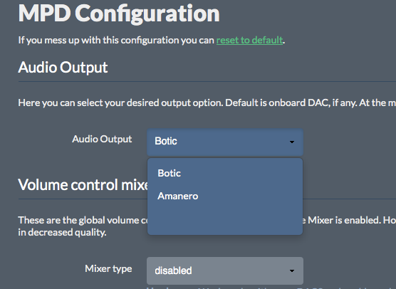

But will botic disable output through USB ?
Here is a screen shot showing Botic/I2S and Amanero/USB/I2S can both work under miero's boticized Volumio1.5BBB.
