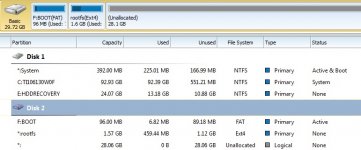

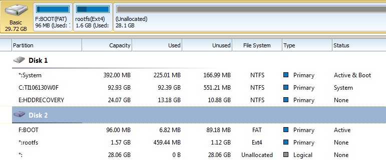

Well, no it does not work for me. Now, question is do I have a suitable image on the SSD? I have attached a screen shot from 'Mini Tool Partition Wizard',
please view it and tell me if it's right or not.
On a different note, after chasing around trying to get a debian OS back on the eMMC with no success, I discovered that their are .img files that are specifically for flashing to eMMC.

I had tried latest versions of Debian console flasher
BBB-eMMC-flasher-debian-7.8-lxde-4gb-armhf-2015-03-01-4gb.img
and others the ones that I was able to flash to eMMC have a password for
root, not the usual no password. So, could only logon as debian:temppwd .
Have been asking on various user boards about that and all I get is, 'that's unusual' comment.
Finally decided to try Angstrom, BBB-eMMC-Angstrom-flasher-2013.09.04.img and could logon as root:no password needed.
So, I put the SSD with Botic.img and tried mieros instruction
root@bbb:~# /opt/scripts/tools/eMMC/beaglebone-black-make-microSD-flasher-from-eMMC.sh and got a file/directory not found message.
Also, tried booting with Botic SSD holding the user-boot button, and
booting without holding the user-boot button.
Does the screen shot I posted of the SSD w/botic look ok? I do a complete erase/format of the SSD every time before loading any .img files on it just to be sure.
Thanks for any thoughts you might have on this.
