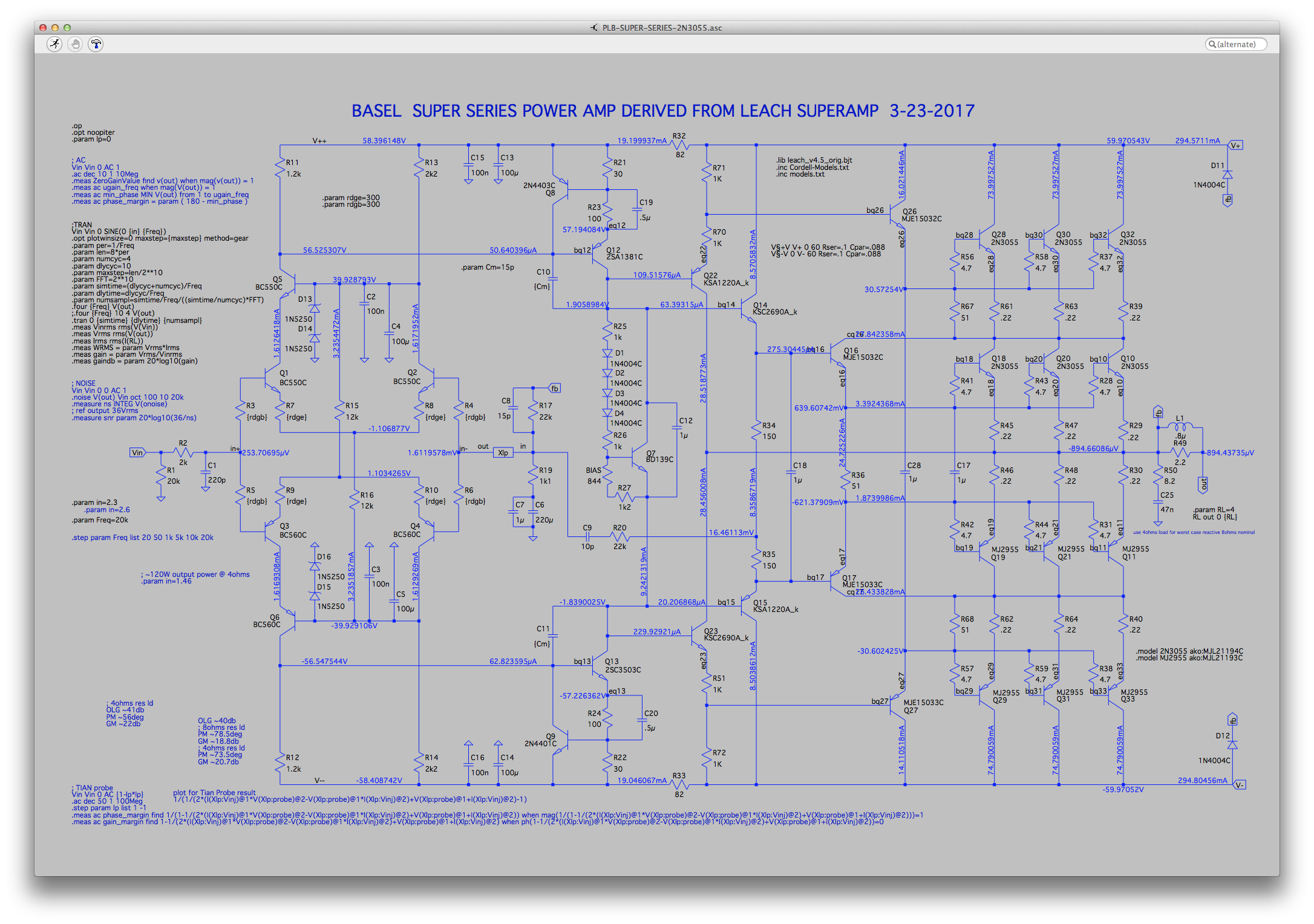

Why not for predrivers, as I said these are what I would use:
KSA1220A/KSC2690A - to126 R-O-Y 160V 1.2A 20W 19pF 150MHz 220mA @50V 90mA @100V
A little beefier than the 2SA1381, but they have twice the capacitance, per fairchild datasheet, I see 26p typical. That may vary among sources.
Would that capacitance not be an issue?
What about reliable models? I don't have any known good ones.

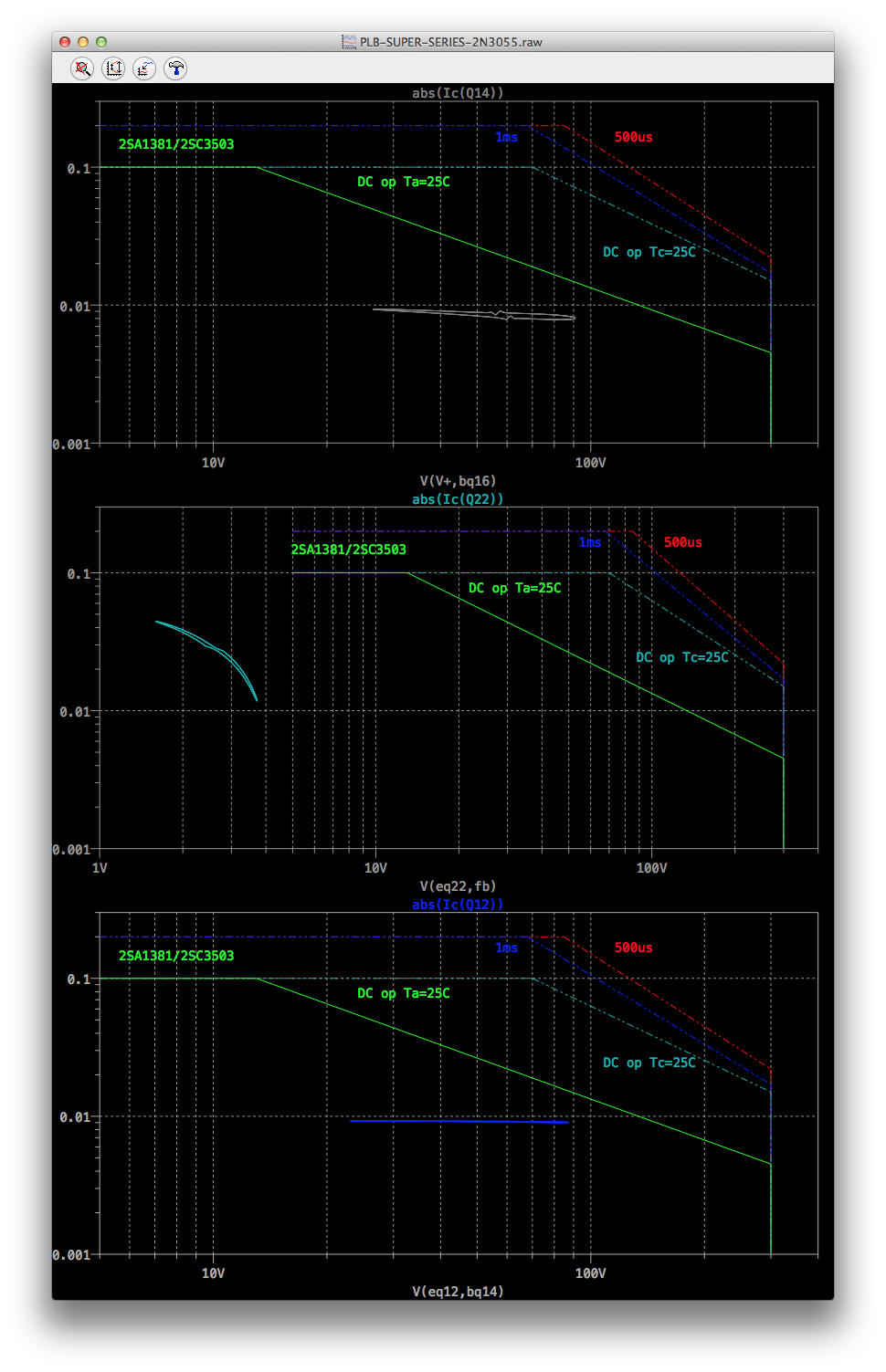

So the SOA rating plot is an overlay as I am following?
The SOA curves are in the plot file ahead of time, and stay there. The actual current plotted agains the Vce is on top of that, added after the sim has run.
The prepared plots have what's needed to go ahead with plotting the curves with the SOA already drawn up.
You must do the actual plot under some drive condition?
Nothing specific. It will attempt to draw the curve when running the sim, and of course would be wrong if attempted for a different type of analysis, like AC for example. In a case like that, the plot would want to switch to an other kind of analysis, which would remove the SOA plots in case of AC or noise analysis, but if a DC analysis was attempted, it would try to use the prepared definitions and it wouldn't mean anything useful.
So the only thing needed to have it work properly, is to run a transient as it was meant to be and prepared for that. Nothing beyond that. You can change all other things in the sim, like load, short, frequency, whatever...
Because all that is prepared, besides the tracing of the SOA chart and annotations, are the definition of what to plot on each axis, which is Ic on Y and the Vce on X.
As long as the plot file doesn't get overwritten, it can be reloaded at will.
And it does need to be either reloaded or at least refreshed because ltspice screws it all up when running the sim and doesn't put it back the way it was meant to be displayed.
Most of the time, I don't need to reload the plot file, only a space bar is enough to refresh it.

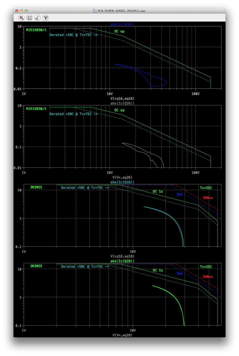

I have to think about this more, but I believe that you'd want to do it at about 39-40.5% of full power where dissipation in the output devices is a maximum.
Well, we can easily do that. I usually run sims at 1/3rd, 1/2 and 2/3rd output power to take a look at how dissipation evolves.
Taking the 2.3V input as a reference for nominal power, which is somewhat close, but not quite, to the true full power, we have about 300W on the 4ohms res load.
So aiming for about 120W would be roughly in the ballpark.
It takes 1.46V input to drive it to roughly that 120W output.
I put out the SOA plots at that level (posted). We're much lower than when clipping and when the glitches are there.
There are some glitches though, but nothing quite as bad.
I had to correct the power devices SOA plot file, since I named the important nodes, it all went wrong in the plot file, but now it will be stable with further changes.
To make sure you know which device each plot pertains to, just look at which Ic it's looking at for Y axis.

I found models from our friend keantoken:
.MODEL KSC2690A_k NPN ( IS=1.7783E-13 BF=132.5 NF=1.0 BR=8.495 NR=1.005 ISE=1.9953E-13 NE=1.5 ISC=1.5849E-9 NC=1.98 VAF=580.75 VAR=18.15 IKF=4.0271 IKR=0.0120 RB=2.98 RBM=0.001 IRB=0.6396 RE=0.0909 RC=1.4705 QCO=0 RCO=0 VO=6.587 GAMMA=2.8216E-7 CJE=4.0082E-10 VJE=0.6696 MJE=0.3296 FC=0.5 CJC=6.0404E-11 VJC=0.5 MJC=0.4266 XCJC=0.4955 XTB=1.2590 EG=1.2277 XTI=3.0 Tf=830p Vceo=160 Icrating=1.2A mfg=Fairchild)
.MODEL KSA1220A_k PNP (IS=4.7863E-13 BF=289.3 NF=1.0 BR=9.76 NR=1.006 ISE=5.2481E-12 NE=2 ISC=2.4909E-11 NC=1.5 VAF=98.5 VAR=6.7 IKF=2.7061 IKR=0.0759 RB=2.26 RBM=0.2308 IRB=0.001 RE=0.1908 RC=1.1748 QCO=0.02 RCO=3.9811 VO=11.078 GAMMA=5.01187E-8 CJE=3.4786E-10 VJE=0.9575 MJE=0.4694 FC=0.5 CJC=1.1224E-10 VJC=0.5761 MJC=0.4365 XCJC=0.4955 XTB=1.7978 EG=1.2255 XTI=3.0 Tf=970p Vceo=160 Icrating=1.2A mfg=Fairchild)
He's using those and he's doing good stuff with them, we can trust him as much as Bob for having checked his models for being as good as they can be.

If the VAS has enough bias current to easily charge its own and the load capacitance it
should be fine. For a 1A device I'd call those low capacitance.

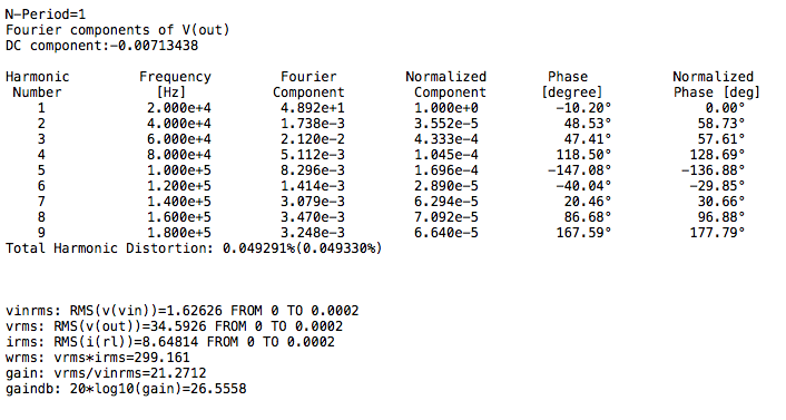

I swapped the 4 pre-drivers to those other devices, leaving the vas as is, and tried it, with the same 4ohms res ld and 20khz as usual, and 2.3V input.
The open loop gain seems to have gone up slightly, but not much, however the phase margin went down quite a bit, and the gain margin up a little.
Phase margin remains at about 56deg though, so it would only take a small amount of tweaking on the compensation to get some of that back.
One other thing changed, thd went up a fair amount.

I'm familiar with those graph capturing tools but not quite following why you need them.
SOA curves are flat at the Ic limit, then power limited (Vce*Ic=Prated), then SOA limited
but usually also a straight line. Very rare that they are different.
But whatever makes it easy.
Simply to get more accurate data and try to avoid too much guess work.
Most of those SOA plots have very thick curves and it's always hard to tell exactly where they cross or change direction. So I'm hoping the software will get it right better than my own eyes.
SOA curves are flat at the Ic limit, then power limited (Vce*Ic=Prated), then SOA limited but usually also a straight line. Very rare that they are different.
I just found it a bit difficult to guess the right spot where those curves change direction, and since it's almost always on log/log scales, when such an inflection point is somewhere between two grid lines, it's hard to guess exactly what the actual value is there. It's a best guess'timation...
I'll have to do this now for those new devices.
it has to be derated even with an infinite heat sink,
My SOA prepared plots have a DC (or similar) added derated SOA line, which I made for a 50C rise (150C max junction for TO3s)
Of course that's an extreme limit not to reach, and the heatsinks have to be calculated to keep those cases at less than that 25+50=75C
The more headroom we keep the better of course, with more long term reliability in mind.
That's why for this superleach with 3055s, I'd be tempted to use 4 sets instead of 3 for the outputs. And the type of protection still needs to be thought of.

I agree on the 4 sets of outputs but I'd leave this sim at 3 since the MJLs have more
capacitance than the actual devices.
I re-read Bob's SPICE section and I need to think about it a bit more but I have some new
thoughts. Why not start with Bob's MJL models, adjust beta to the correct peak value and
adjust the parameter that controls droop at high current for the best match. We are not
really concerned with low Ic droop of beta so just leave it, that way you only have two
parameters to iterate for hfe. Then adjust the junction capacitances to the correct value,
and TF for the correct Ft 2-2.5 ish should be fine. I need to think about this a bit more but
I agree but, for example, I was looking at the 2N3055 on the constant power section of the
curve thinking that at 40V the curve was very close to 3A but obviously the correct value is
115/40 = 2.875A.
Stepping back for a minute, as I understood it you were interested in the Leach because
many have been built it (is a proven design) and your impression was that it was low
distortion. Knowing now, that it has oscillated for several people, and that it has higher
distortion would you want to pick a different front end?
All you analysis of the output stage would still apply to any front end that you choose.
People seem to speak highly of roender designs, RMI-FC100 MKII or whatever.
I think that using ideal power sources is fine for most of the analysis, but with short circuit analysis adding a realistic PSU source resistance will help a lot.
I usually have resistance added, along with large caps, on the psu. In this sim, they got removed earlier, but I can add that back.
I usually have that in the order of 100mohms or so, sometimes more for smaller psus. Should that be more?
As I followed you, you want the SOA protection to cover a short?
Well, the shorts are just a part of it. I tried it with lower and lower impedance, to account for possible misuse of the amp with too many paralleled complex loads.
The shorts are sometimes not a dead short, with some resistance, sometimes even made temporary by a fusible piece of wire that the amp will blow up and then the short is removed by force.
I don't think that's easy to do properly and reliably.

Why not start with Bob's MJL models, adjust beta to the correct peak value and adjust the parameter that controls droop at high current for the best match.
It doesn't work quite that way. It's not like we have specific parameters to act on this kind of specific behavior.
I've been playing with this lately, and it hasn't been that straightforward.
There is the parameter that controls where the rolloff starts (very fuzzy) IKF, but nothing to control how fast the rolloff is, and I found I couldn't get the highest point of the curve where it needs to be.
Then playing a bit with the IS acts on the small current rolloff, but we can't really control where it happens, just its magnitude.
It's much more intricate than this, so not so simple. I'm working on it, but so far it's hard to get it right.
For the 3055, my tweaking ended up with 300p for CJC, which seems about right. And CJE could be a little more.
TF is a time and not a frequency, so it's a little tricky to find a good value because it also interacts with other things. Once you set that for a value that seems fine, then acting on other parameters screw that up.
Most 3055 datasheets state 2.5Mhz minimum, with the max at 6Mhz.
Curiously the PNPs are faster.
My tweaking led me to use 60n for TF and I couldn't figure out what TR should be.
However, there is also VAF to think about, which has to be quite different.
For the 3055, VAF at 150 seems like a good compromise.
But there are other parms that would also make some difference, such as the series resistance on each leg (EBC), and things like ISE and ISC (which also interact with XCJC/MJC).
So much to tweak.
Knowing now, that it has oscillated for several people, and that it has higher distortion would you want to pick a different front end?
Would the front end be a factor in this? Really?
I'm usually more inclined to use more standard dual ltp with current source and mirrors, and then sometimes either sziklai or cascode.
What topo would you have in mind?
I don't recall this. What kind of topo is this?
One thing I was curious about, especially since the change in the pre-drivers, was to cascode the vas.
But I'm not convinced that front end is what's bringing in much trouble.
We can go for a more common cascoding method there, but I think current sources and mirrors might do some good too.
I'm just thinking, if altering things like adding a cascode to the vas, changing the front end for something with mirrors and sources, cascode, sziklai or whatever, what we get is far more gain. Essentially transforming the leach concept of low open loop gain back into a larger open loop gain, which obviously would work towards lowering thd a lot.
But then leach's main concept of reducing tim goes out of the window.
However, in the more recent past, some people have found out that some of this concept was not quite right for low tim, although it did work in that direction, some think it's not necessary to have low open loop gain for lower tim.
As far as I understand it, the tim occurs when the front end gets taken "by surprise" by fast transients on the input, and the lag from the feedback comes too late to get the correction to work. And also the front end must never be put in a situation where it can saturate, which is why leach put so much degen there.
But I'm thinking maybe he went a tad overboard on that.
