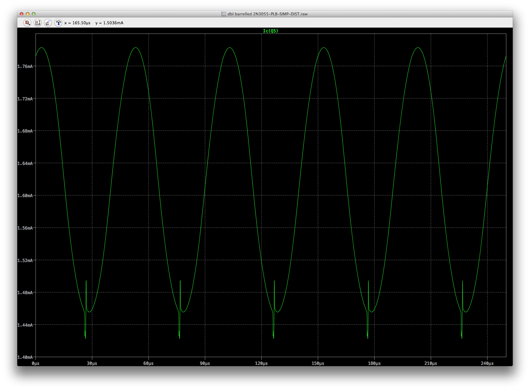

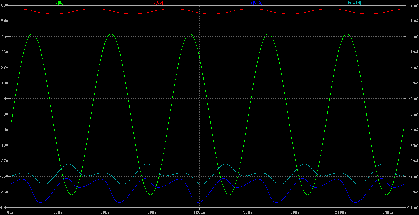

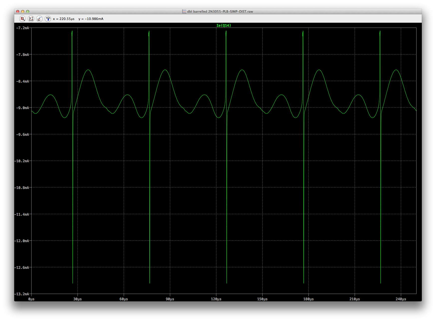

I tried the trick to move the feedback pickup to the vas and I totally uncoupled the rest after the vas, so nothing could come back from the output stages.
I only rerouted and disconnected, without changing values, and ran the same sim as earlier, so the gain isn't the same and the same sim gives a lower signal level output, taken from the vas output.
This was on that same sim as earlier, the 4 output sets version with tmc instead of the leach compensation. Plus the vas limiter remains disconnected.
And there we go, nothing ugly to report. It all looks good everywhere, right from the first ltp transistor, both currents and voltages look like clean sines from the ltp all the way to the vas output.
Those big spikes must be generated elsewhere, or whatever the cause is, it passes its effects on when the whole circuit is connected.
I didn't try keeping the predrivers connected to the vas and disconnect the rest of the output stage, that's rather complex there and I'm not sure we can really do this, because of the stacking and the setup that takes the output signal to bias the stacks.

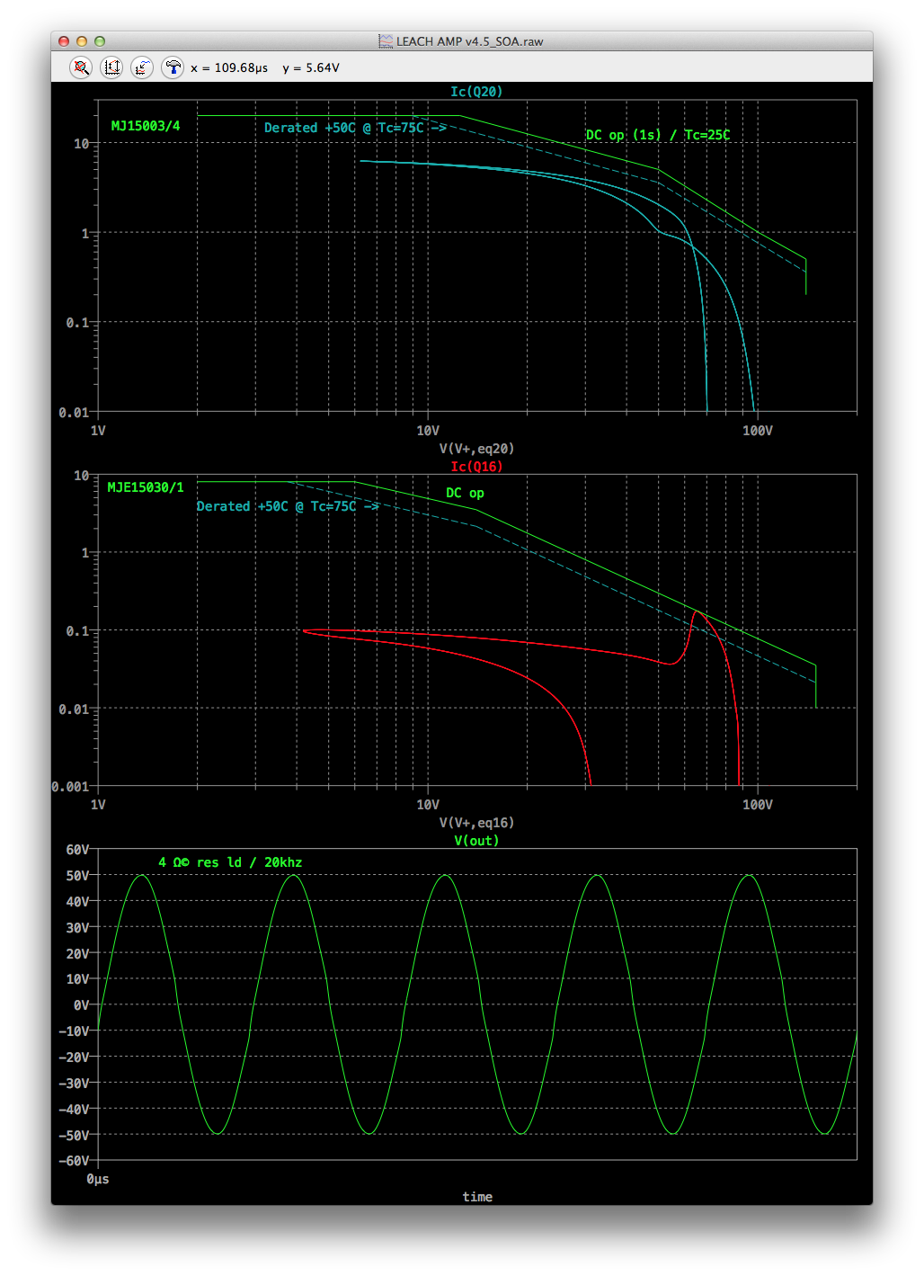

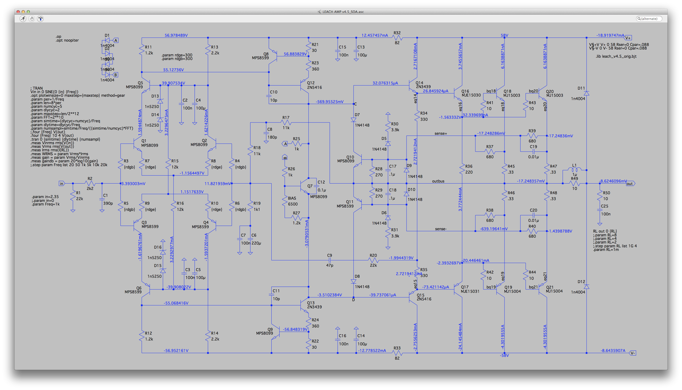

I've been cleaning up and preparing an original leach version 4.5 as it comes on his site, to see soa plots and test the protection, to see how the soa is violated.
Posting results next...

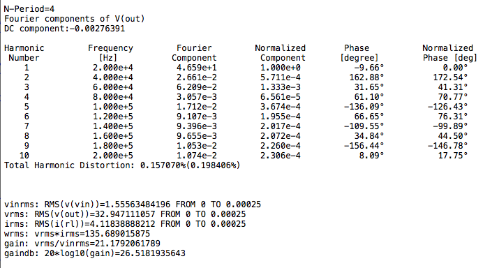

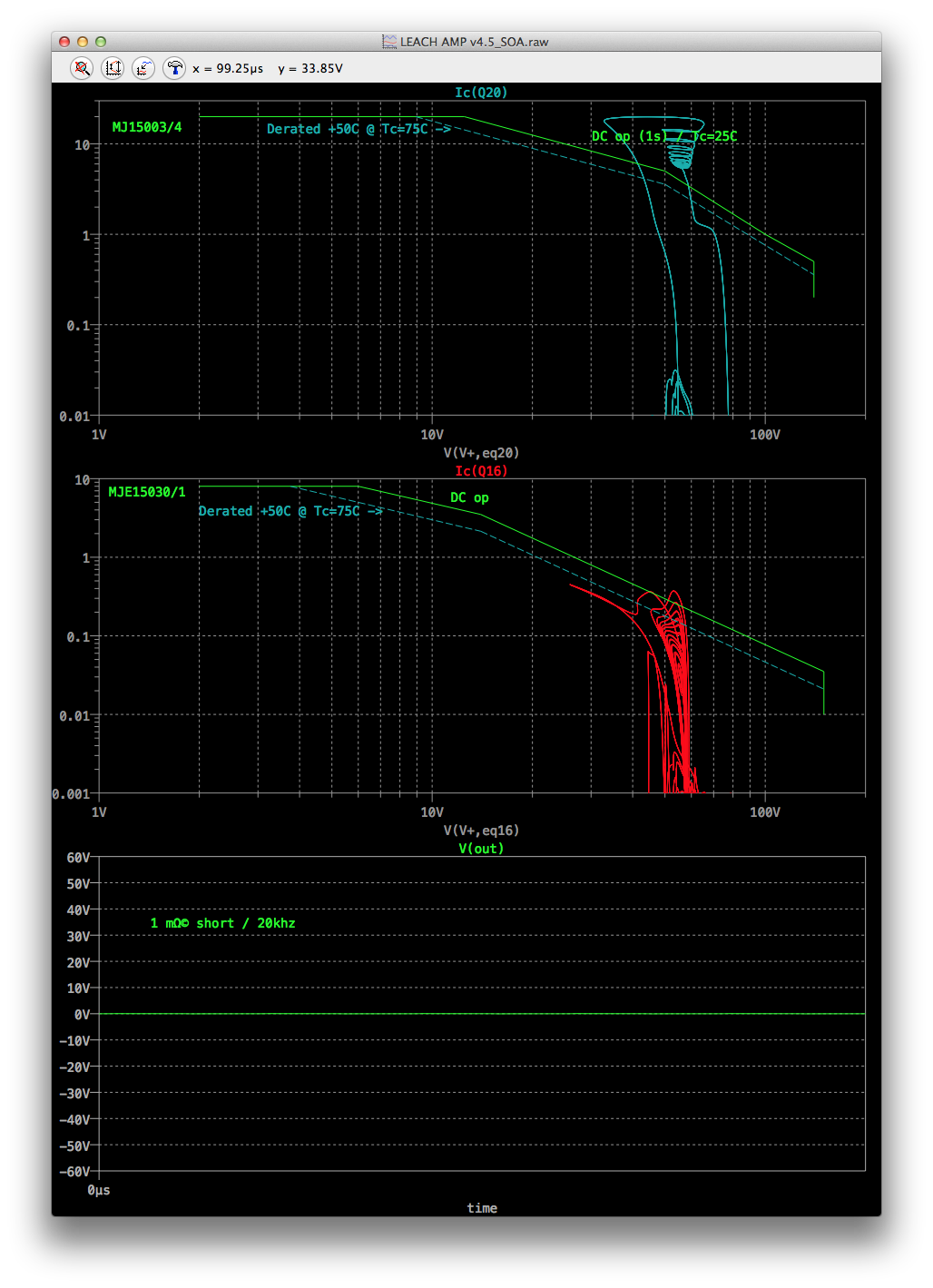

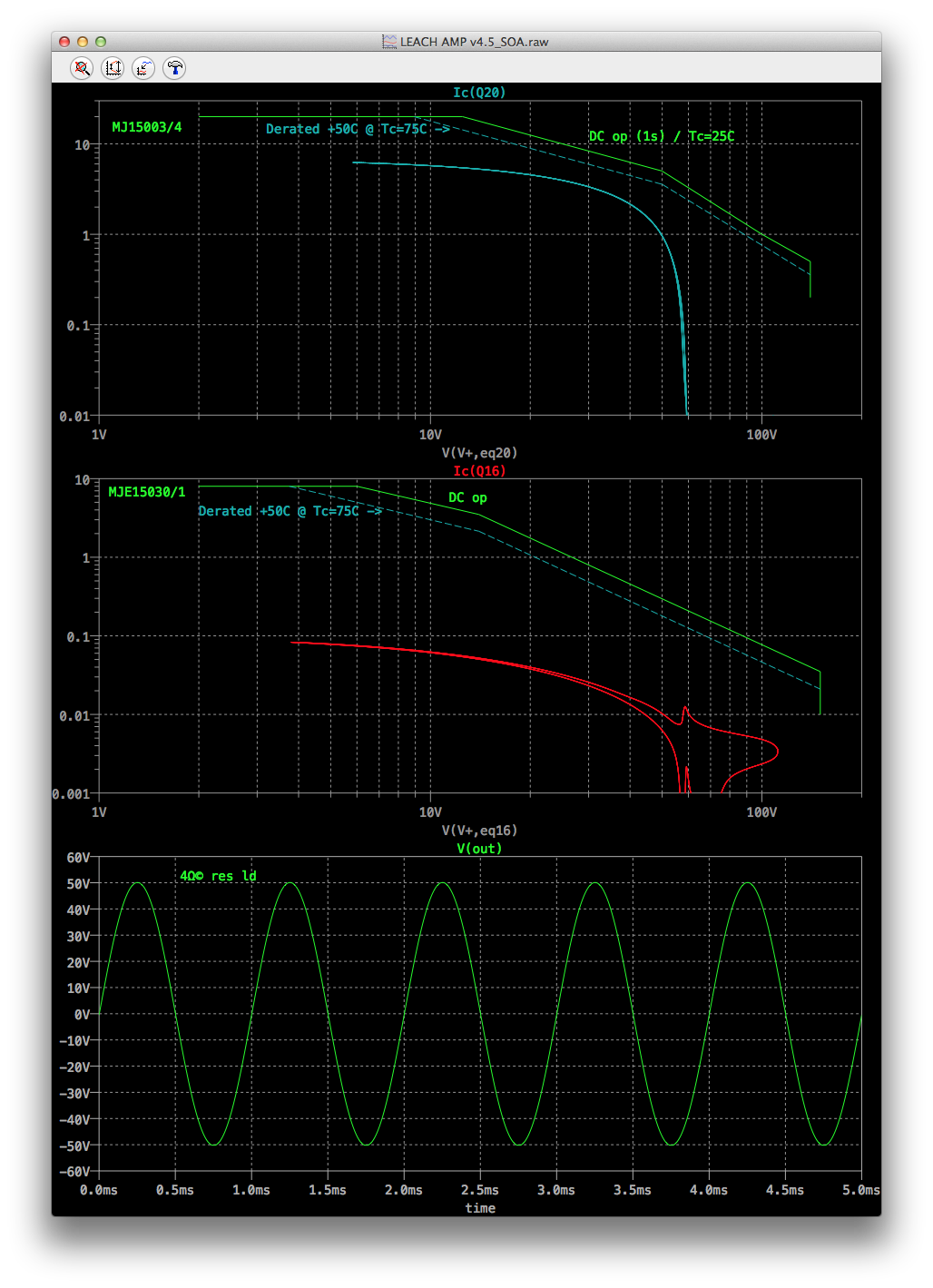

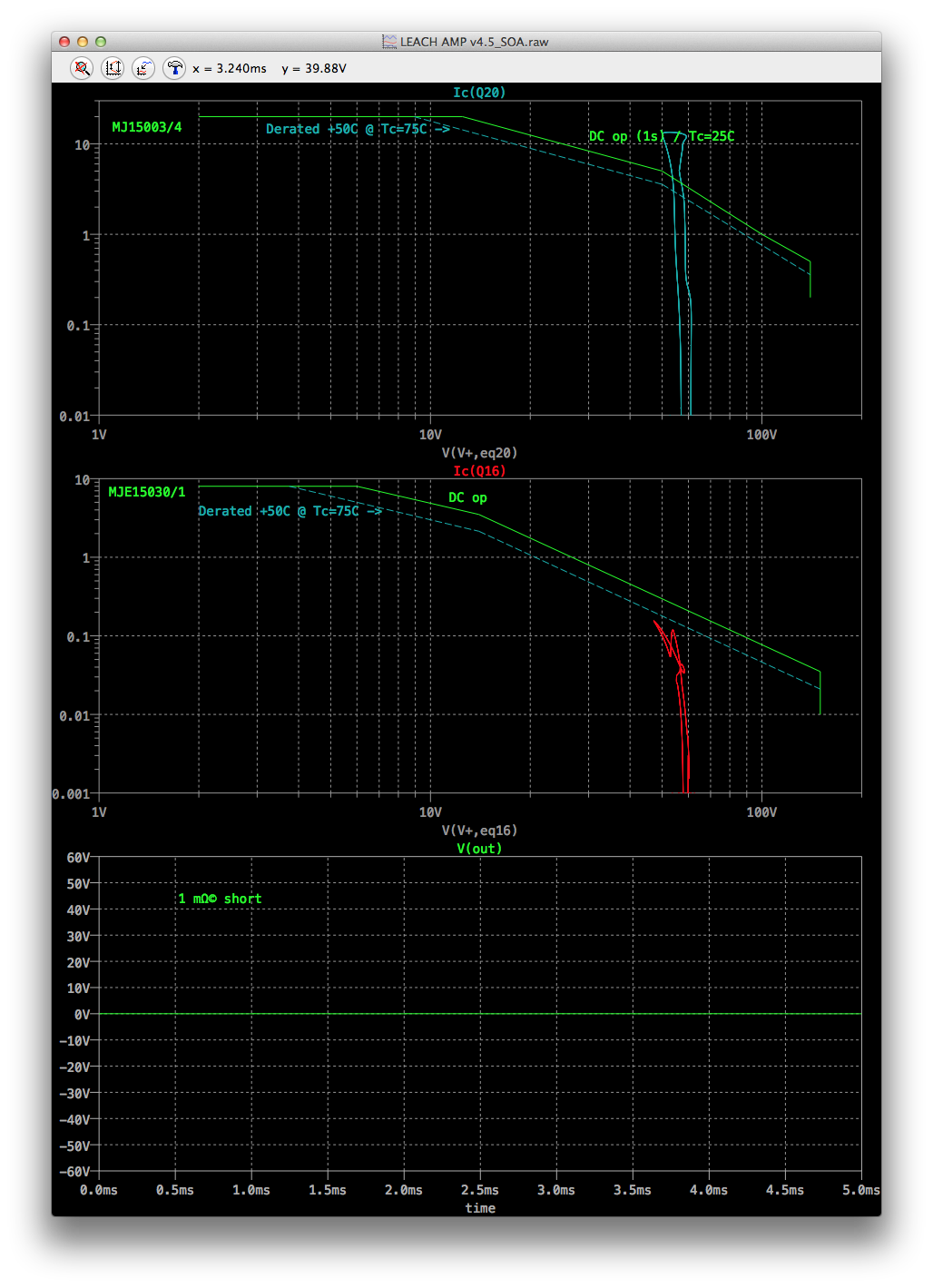

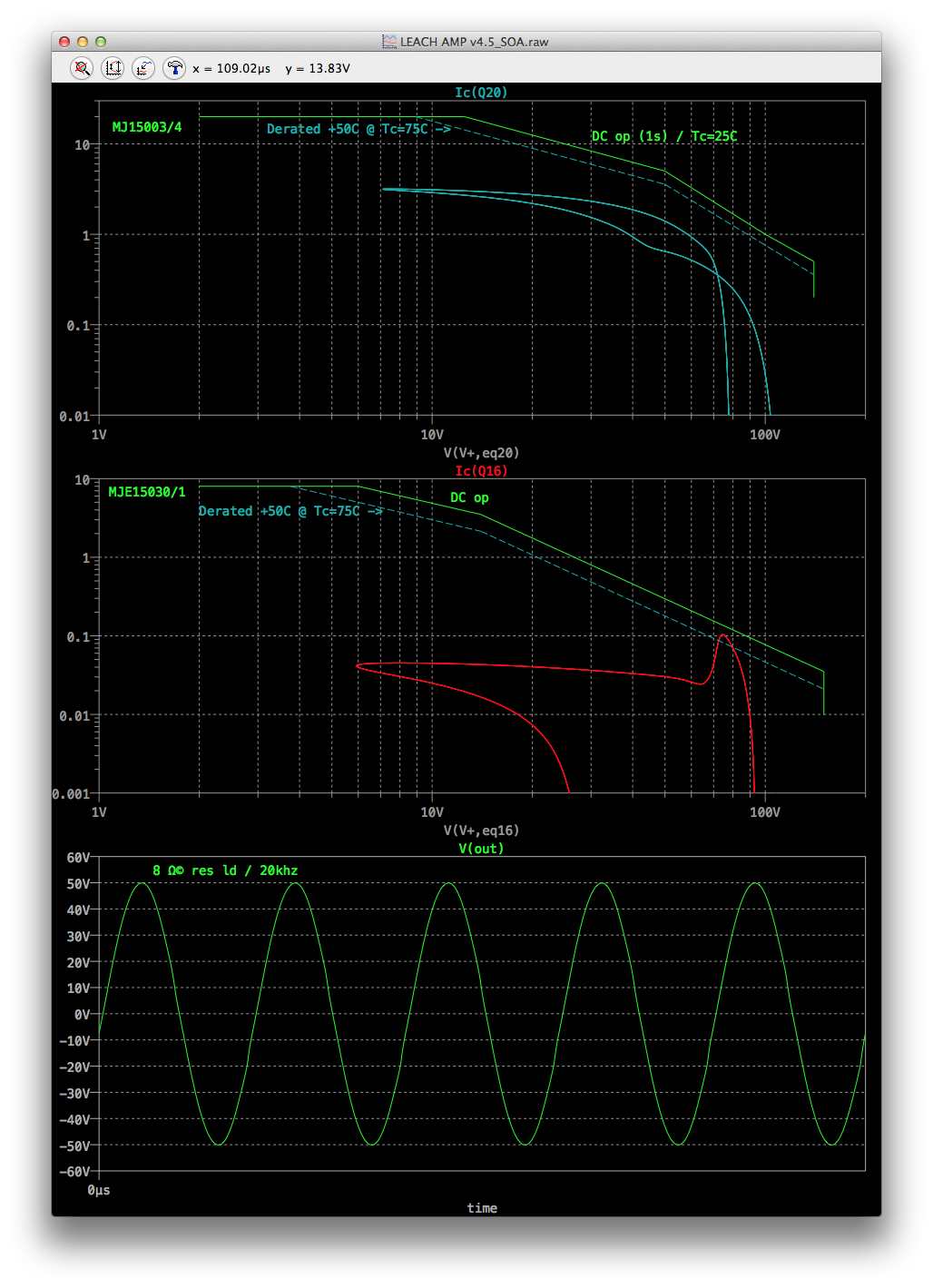

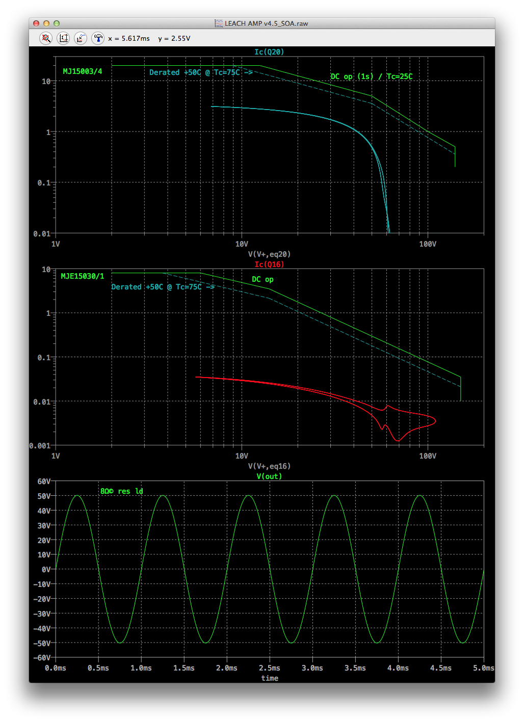

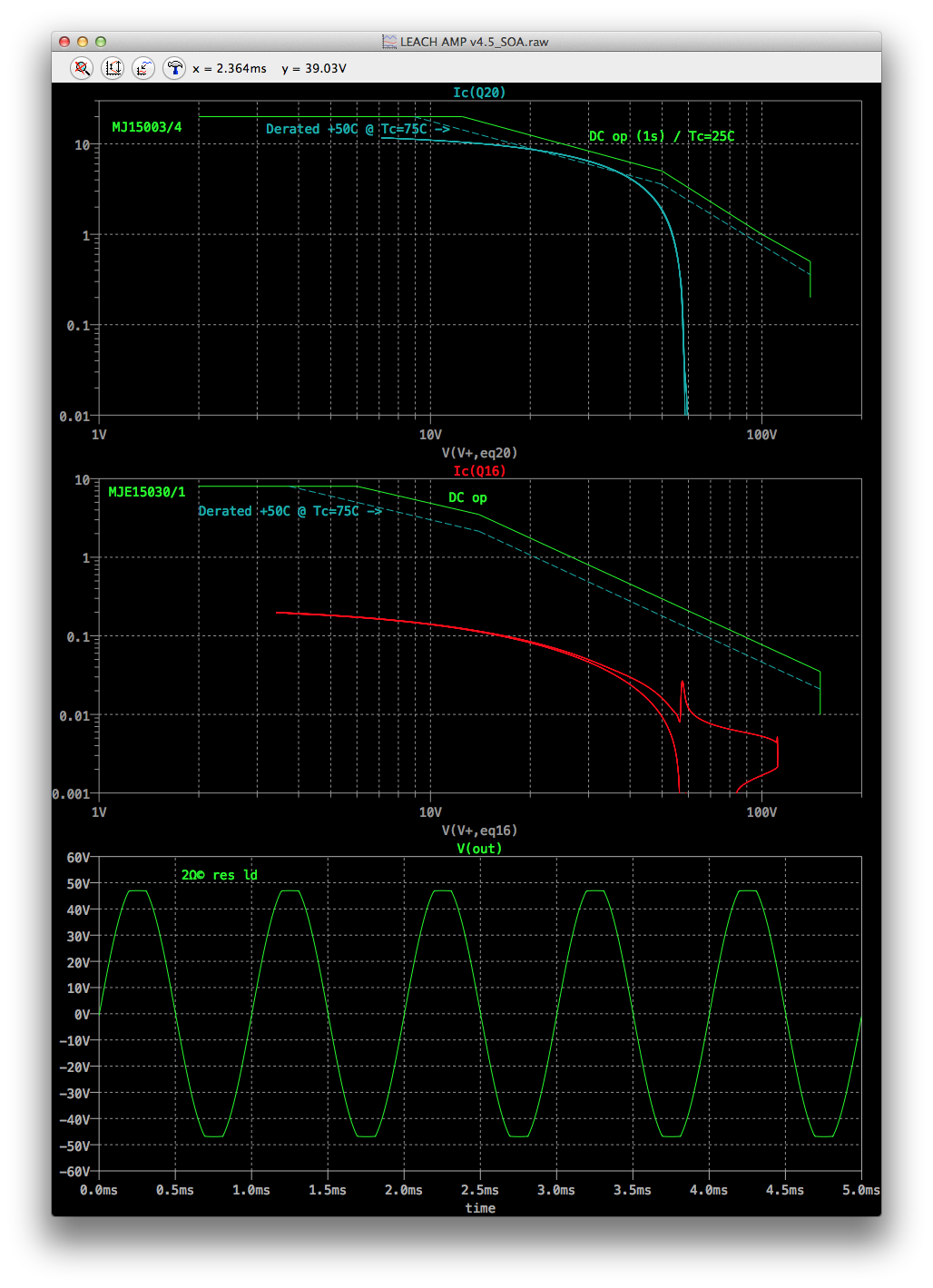

Ok, so this is the original leach amp, v4.5 with 2 pairs of MJ15003/4 and the drivers are the MJE15030/1 that came with the sim.
I ran the tests with an 8, 4 and 2 ohms resistive load, and then with a 1mohms short, and this at 1khz, and then at 20khz.
Obviously that amp with those outputs with only 2 pairs isn't for 2ohms load, and that also means not for a complex 4ohms, for which we allow dips down to 2ohms.
On 8ohms, it looks like plenty of reserve soa for the outputs, and for the drivers, there is a slight violation at 20khz.
On real signals, never full power at such frequencies, there is no chance it would happen.
However, we can see at lower load impedance, it can get a bit dangerous, and at 2ohms, the protections activate, at any frequency.
The ugly stuff happens on that 1ohm short, with a serious violation for the outputs at any frequency, no matter what the protections do, it's obviously nowhere near enough, and they do intrude on some legit signals.
I derated the soa (dashed line) for a 50C rise.

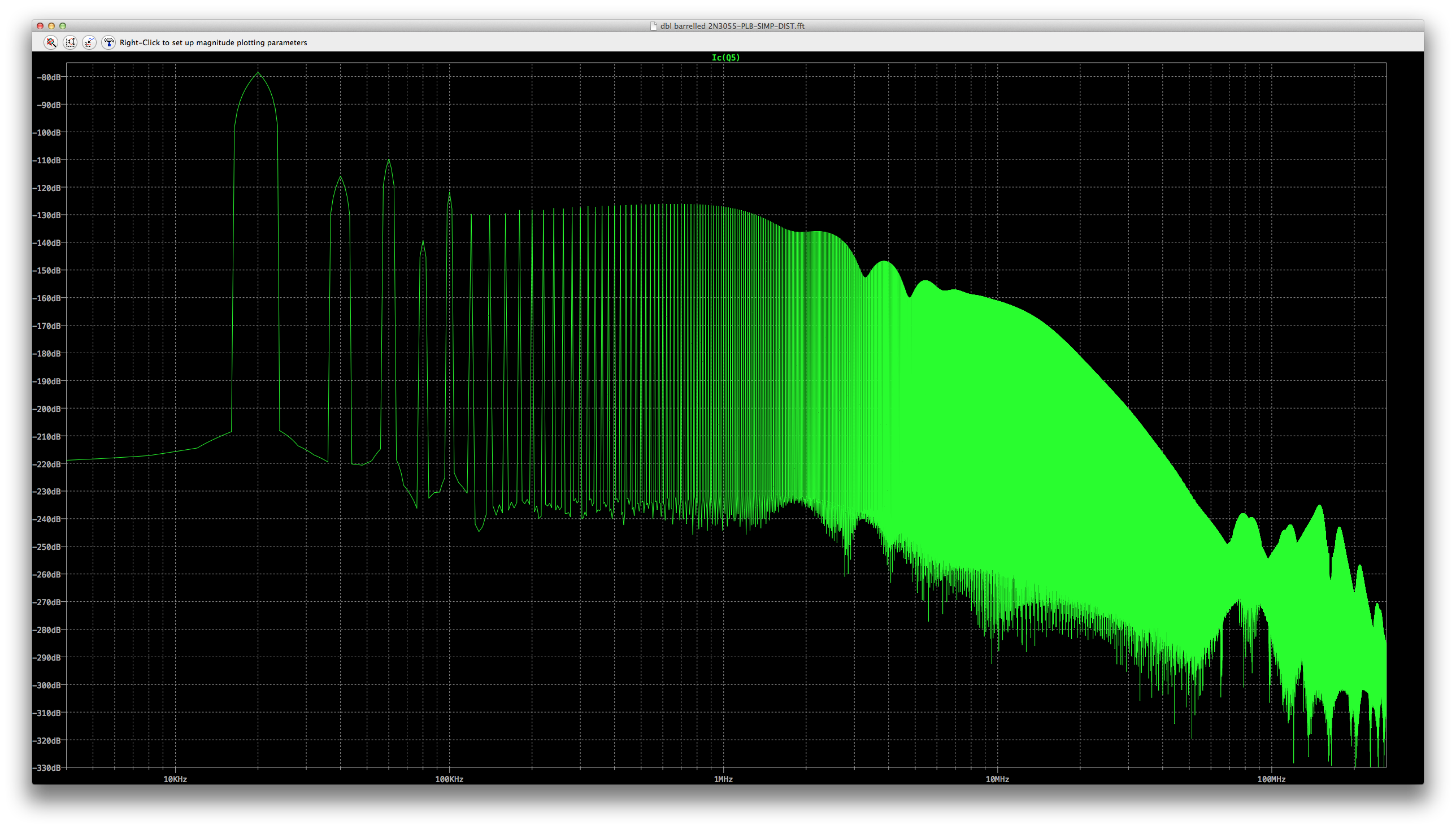

At 20khz on 8ohms, legit signal, no protection activation, but thd at almost 1%!!
I zipped up that sim, which hopefully should run out of the box.

It does run and the wave looks visually fine, until we look at different points inside the loop.
I left it as is, with 20khz freq, and I'm seeing thd at 0.157%. Are you getting the same thing?
And when looking at the signal on Q5's collector, there is that glitch on the negative side. That has to be a part of what contributes to the high thd.
FFT reveals how much hash there is, which has to account for that high thd.
Whatever that glitch is, generates harmonics.
The glitch is fairly small in comparison to the legit signal at the ltp output, but by the time it gets to the predrivers, it's the glitch that's far larger than the legit signal.
And yet, this is far better than what's going on in the superamp.

I'm now close to what you've got there, but what you have there is actually
reasonable for an output stage with crossover distortion. You're design has much
larger glitches with oscillations on them. I think that the BC550/560
are slow in the models.txt file which were being used and fixed the problem. Still,
and I'll repeat what you have there is reasonable with bad output device models.
When I replace your 2N3055/MJ2955 models with the MJ21193/4 it goes away.
But I'll comment on your comments here:
If you look closer at IcQ5 LTSpice expands the range of Ic so that the waveform
fills the graph. The actual variation around that glitch is not very large AND if
you look at it relative to the output waveform, you'll see that while it is at a peak
of Ic's current it is at the crossover point of the output and it is correcting for
crossover distortion in the output stage. It is phase shifted due to the Cdom cap.
The glitch in IeQ14 is right at the crossover point also and is due to the output models
I'm not going to spend any time chasing that down.
When I had models overlapping I didn't see that.
I'm going to guess that the BC550C in the models.txt file is very slow such that they
filter out those disturbances because that is the transistor I remember in the error log.
And probably Bob C's is more realistic.
I just confirmed that 2n3904/6 do it and several others in place of the input devices.
Still this sim is much more reasonable, I expect such behavior in the crossover region
with low bias or bad devices.
Attached is the sim with the aliased BC550/60C model issues fixed AND with Bob C's
MJ21193/4 outputs ALL MODELS ARE BOB C's. NO GLITCHES. I have probably
repeated this 4 times in this thread yet you seem to have a fascination with bad models.
So continue as you've been doing and enjoy your frustration. THD is only very slightly
better at .15%.

out of his models file it should work the same as mine without glitches or oscillations.
You have to use BOB's MJL outputs.
I would NOT go to PCB you should build a prototype and prove out a real world build.
Stability analysis is needed etc. I'm simming SIMP-DIST not your beta multiplier, cascode
version and offering SIMP-DIST as an example of a design that does not oscillate or glitch.
I don't think that your version works without glitches or potential instability.
One other thing on my mind is that the TIAN probe might not be in the correct spot, or
possibly due to nested feedback loops it is not giving correct results. I have to think
about this more.
Attached is the SIMP-DIST zip file with all the files to run what does not glitch or oscillate.
I call it DIST because it is my mods for lower distortion, which you complained about,
so it is a Leach 4.5 with my minimal mods for lower distortion. I would not build this with
BD139/140 but they are close enough to med Cob modern parts for simulation. There
are modern subs that I'd use some with much lower capacitance. This still needs detailed
stability analysis and fine tuning. I'm posting this more for other people who might want
to build something with 2N3055s or a Leach 4.5 with somewhat lower distortion, or just
try out a simulation.
That latest .zip has a truncated models.txt file, you can probably run without it even
since I'm using the MJLs as outputs.

I've already commented on SOA limiters and how I don't like them, you were rather dismissive of that. Yet you can't seem to get them to work. They are flawed IMO since
transistors do not make good comparators. Perhaps with enough margin they could be
made good enough but I'm not going to spend a lot of time on them.
Fuses were too crude for you, go ahead and make the SOA limiter work.
I also mentioned a sense transistor on the emitter resistor that puts the amp into protect
mode, which you also dismissed. I would set this to trip at less than 1 or .5 ohms to lock
up and protect the amp from a short. Yes everything stops until the short is fixed. If a
person puts so many pairs of speakers in parallel to present 1 ohm, then it should lock
up since it is not designed for that. If the amp is designed for 1 ohm then you obviously
set the trip point lower. I'd use this in conjunction with SOA or fuses.
I've put a lot of thought into this and drawn from my own experience.

Attached is the LTSpice Sim of the new series topology that I came up with, no glitches
or oscillations. This is not for commercial use but is for builders who for some reason
need to use older lower voltage output devices. I'm calling it "BASEL SUPER SERIES
POWER AMP DERIVED FROM LEACH SUPERAMP 3-23-2017" because it is different
enough from any of the other amps out there with series output stages.
Sims are with all Bob C. models and MJL21193/4 outputs which are good enough to
prove out the design - a prototype should be built if anyone takes this further. This is a
start, stability analysis Pdiss, and replacements for the BD139/140 need to be considered.
Better feedback such as TMC, MIC or others should be considered.
Use the attached .asc files with the support files in the previous .zip.
It sims with .16% THD20 slightly below full clipping.
