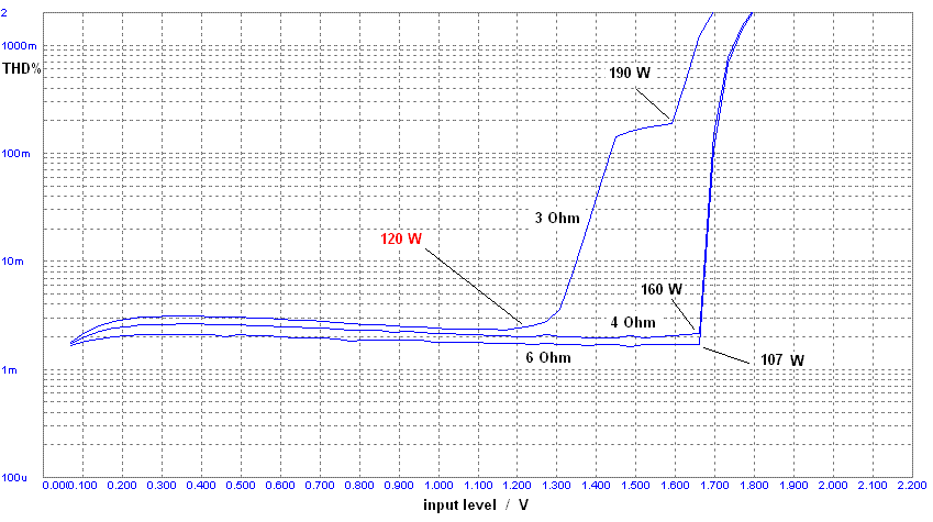

Enclosed one can see a simulated THD% graph for 3 different
resistive load : 6,4,3 Ohm. the figure shows a very good
behavior but for the last case where we see the switching artifacts.
clipping power respectively about: 107,160,190 Wrms.
Nevertheless, the 9+ remain a very good amp, axpecially
considering the age of the design.

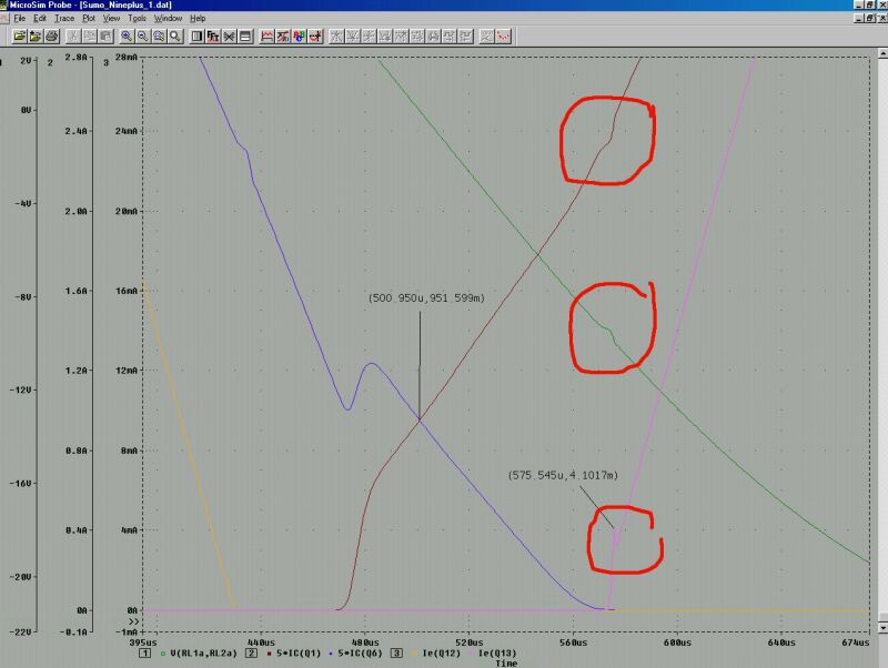

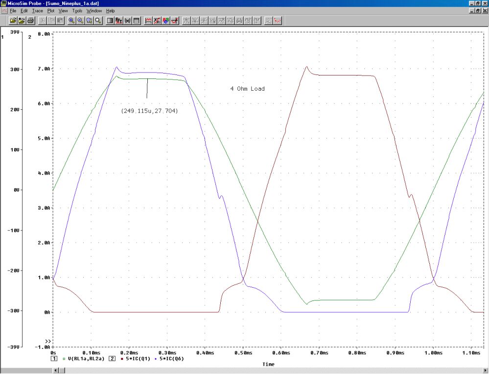

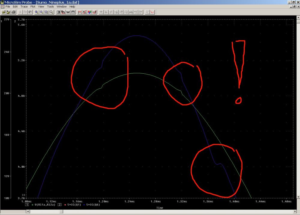

Hallo federico,
first you are right, I have made a typing error with that 4 and 8 Ohm load, that have to be exchanged.
I used your schematic for simulation and for comparing the results I used the same reference designators as you. I attache one diagram here and the other in the following post. One can see that the output current is limited and the switching behaviour is clearly seen as well. The load for this simulation is 4 ohms.
and here is a more detailed view onto the switching behaviour. Note the output voltage at about 9 Volts when switching occurs. That equals to about 10 Watts rms (4 Ohm load used). Sorry for the bad picture quality. I had to compress the image.

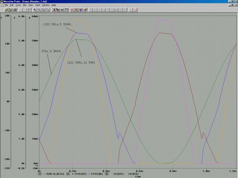

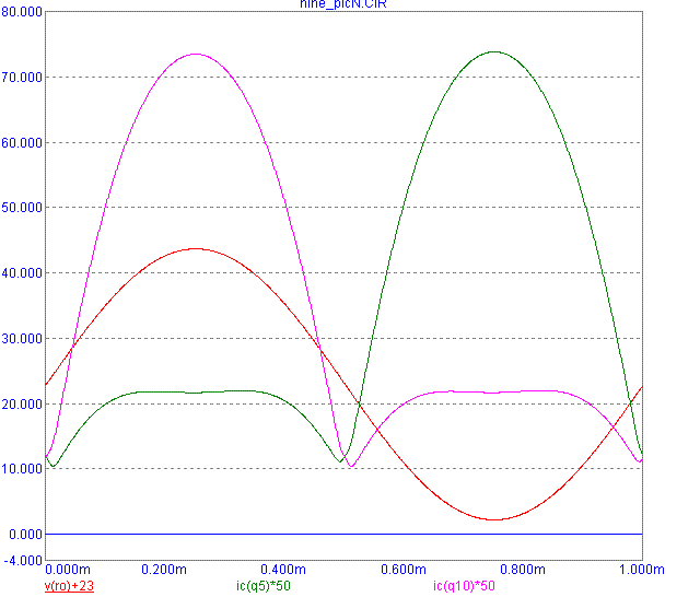

Hi Arcolette
Sim completely different from mine!
have you set R41 = 150 Ohm ? ( the sliding bias resistor
connected the two diodes)
I ask for this since I noticed that the number was not there.
I fix this only today.
Something wrong is happening since current have a completely
different behavior.
see figure (sorry for the scaling)
bye
Federico

Hallo Federico,
I cannot find the R41 on my schematic. Do you mean R38? That is the resistor which is connected between the diodes and ground on your schematic. In your former posted schematic it had a value of 1k. I changed it to 150R and made a new simulation. My results does not fit yours. But it meets an analytical analysis / calculation. And the switching distortion still exists (see second picture in the next post). I hope we could find out the difference.
Hi Arcolette
yes, yes ... R38
Strange, I obtain your identical result only if I set R38 equal to
300.
first of all check the whole circuit for mistakes since there was
some. But I do not think this is the problem.
There is a possibility, maybe you have implemented the circuit
(diodes and res.) according to the original patent from J.Bongiorno. in that patent each diode has its resistor.
And, always maybe, you have set each resistor to 300 thinking
that they were equivalent to a single res of 150 Ohm.
It is not so, since the paths are mutual exclusive the value has to be set to 150 each also in case of two resistor.
However, there is a way to calibrate the circuit. From your current
plot it appears that each output BJT has an average power dissipation
of about 12-13 W ( 4 Ohm load and amplitude of the output
of about 21V) vs. a static dissipation of about 9W (45X200mA)
Well, decrease the value of R38 to obtain an average dissipation of about 25W.
This is the right setup.
Let me know
Federico

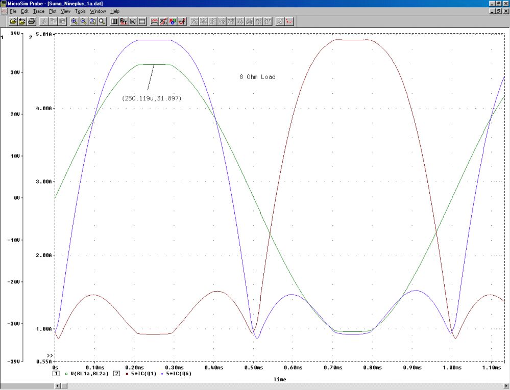

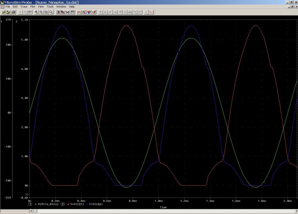

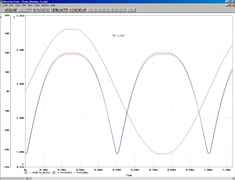

Hallo Federico,
I double checked my schematic - it is identical to yours. I made some new simulations to find out the cause of our different simulation results. I guess I have found it: The current curves of the output transistors strongly vary with the load. My simulation with 8 Ohm load shows nearly the same behaviour as your simulation. If the load is not present, the currents rise up. And finally I get my previous results with 4 Ohm load. I used an input signal of 3Vpp for driving the amp to clipping levels just for getting an idea about the max. available power. That is about 96 Wrms for 4 Ohm load and about 64 Wrms for 8 Ohm load and fits my own measurements (see the following pictures).
Keeping in mind that a real loudspeaker has a quite large variation of the impedance over frequency the current transfer characteristic of the output stage varies a lot. Again, the Sumo amp was a real great design at its time, but I avoid any switching effects or characteristic variation of the amp.
Here is the 4 Ohm diagram:
well Arcolette
there are to distinct uncorrekated point.
first the max amplitude of output signal on your sim
results to be about 32 Volts (hence 64W) while in my
sim it is about 36V (80W).
This is only due to the opamp device in two way
1) supply voltage : I have +- 21.5 since I measured
these values in both my amp (along with a float of 47 Volts)
2) opamp model
Then there is the switching problem.
It is not a problem of load. Yes I know that changing the load
you have a completely different behavior, the amp id designed so.
Rather, it is like you have a 300 Ohm resistor. I don't figure out why but try to set your resistor to 75 Ohm andlook at the results.
maybe this is only the result of different model.
As I said you, the only possible procedure is to set up correctly the amp based on the performance.
This is another methos more simple than the previous:
-set the load to 4 Ohm.
-set R38 very low in such a way the devices never cut off.
-go to the clipping condition (32 Volts or better if you succeded
in rise that value to 35-36V)
-start rising the value of r38. the central part of the current
will decrease. go on rising and stop when at the threshold of cut off.
now the amp is correctly set up.
Federico
2) opamp model
Federico
