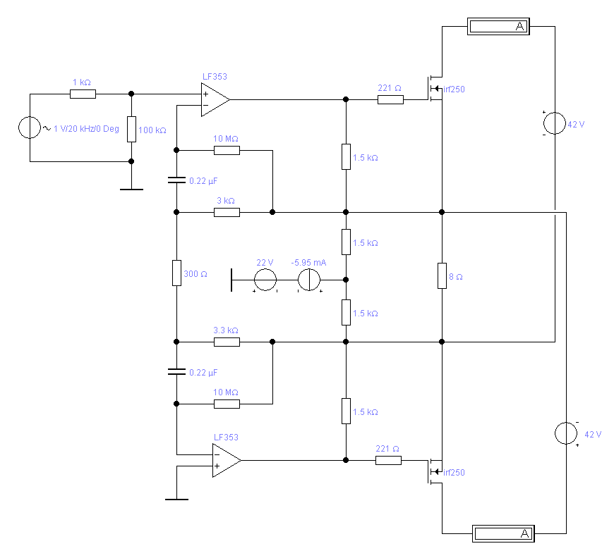

The schematic in this post looks to me to be essentially a Sumo Nine topology done with tubes instead of opamps, and a pair of large vertical MOSFETs in place of two banks of bipolar output devices.
Bias for the output stage here appears to be controlled by a single adjustable constant current source. Assuming that the CCS is set up to thermally track the output MOSFETs, this scheme should keep their bias stable enough to allow for safe class AB operation.
Out of curiosity, I modeled a version the circuit I mentioned above in Electronics Workbench and it seems to work fine. I've attached a screen shot of the model for anyone interested. I used the basic Sumo Nine circuit, replaced the output stage with a pair of IRF250s, and replaced the Sumo bias circuit with a CCS model. This CCS draws about 3mA from each opamp with the output stage idling at 0.9A per side. The model CCS is not temp compensated, but there are several ways this could be done in practice.
For any reasonable load (>1 ohm), the output stage acts as a current bootstrap over the opamps so their output current never exceeds twice their 3mA idle current, allowing them to work class A at all times. A side benefit of this is that the output stage Vgs never exceeds twice its idle value, so there is a degree of protection for the output stage built into the circuit. This happy scenario may not hold up against a dead short at the output, so in practice I'd add a zener Vgs clamp for each output MOSFET. And although the model needed none, I'd expect to see the need for some HF compensation as shown in the original Sumo Nine schematic to prevent HF instability.
The objective performance of the circuit looks great in the model, and from past experience, I think most of this would translate to reality. However, I did have to set the model LF353's operating voltage 2V higher than in the Sumo to get 60W output without clipping. So, anyone modifying an existing Sumo Nine may see a slight decrease in max output voltage swing, this being due to the 4V turn-on voltage of the output MOSFETs vs. the .6-1.3V of the original bipolars.

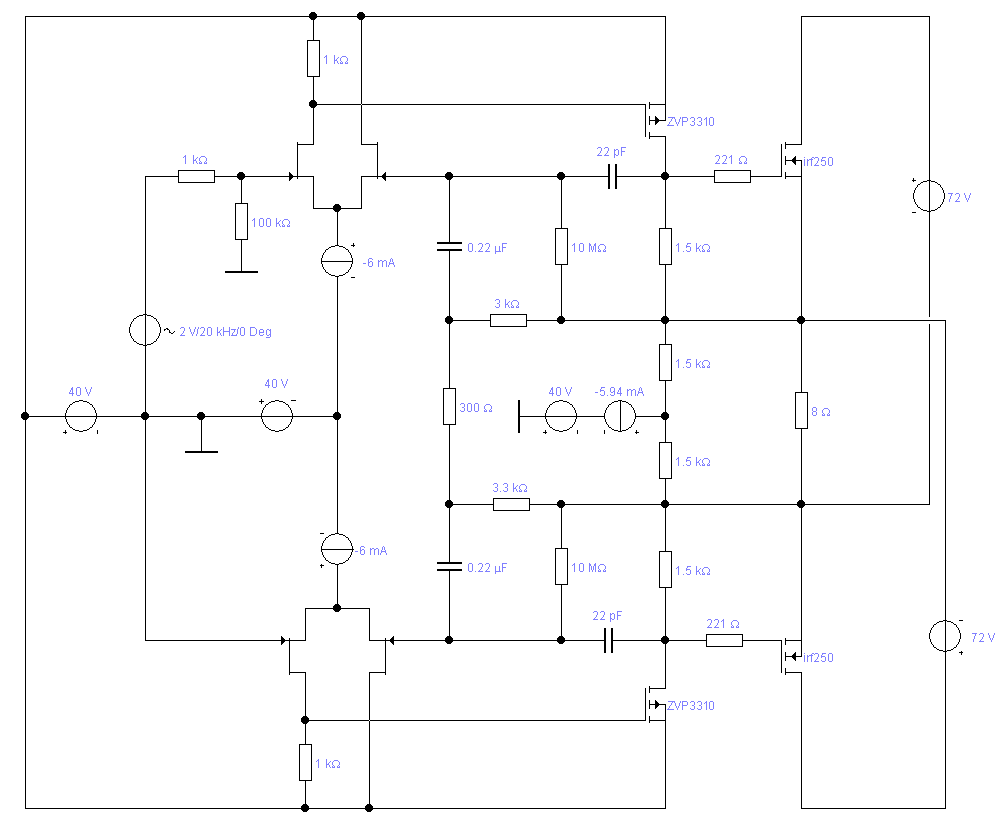

FWIW, scratch-builders can increase the power output available from this topology by specifying higher rail voltages and replacing the chip opamp front end with something similar that can handle the higher voltage.
For example, the attached schematic shows a 200W model in which the chip opamps are replaced by discrete FET/MOSFET circuits, the output rails are 72V each, and the front end supply is +/-40V. The other circuit values were chosen rather casually, but even so, the model works well and predicts excellent measured performance.
djk said:Joe, I'm afraid your design will have temperature instability with the IRF type FETs.
I agree that it would if the bias CCS had a zero temperature coefficient. My thought is to make the CCS tempco a negative complement of the OS tempco, probably using a small HEXFET mounted near the OS heatsink as the CCS voltage reference.
I have to say that I haven't yet built this particular circuit, and until I do I'll keep an open mind. However, the amp I listen to most often these days uses a hot-running HEXFET circlotron OS with IRFD110 bias. The amp has been on more or less continuously for over three years (in and out of standby mode), and in that context at least, bias stability is a non-issue.
