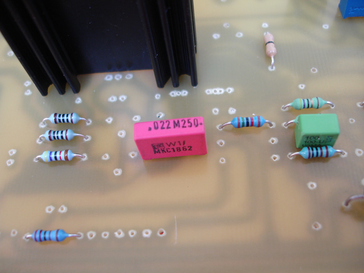

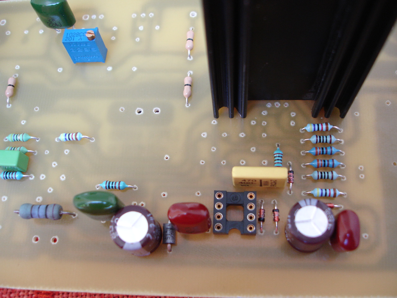

Today early in the morning about 5.30 o'clock i examined the amplifier again.
But this time I was sure for the pcb because it passed the point to point test.
As changing transistors and matchig didn't solve the problem, having in mind that the others' amplifiers didn't have the problem,i decided to return to the original circuit.
So i put at R11 the original value 15K.and that was all!
Thanks everyone for trying to help .
Especialy thanks Mr AdrewT who advised me to stabilize the LTP without servo.
Thanks a lot to John Balli for your instant reply in mine request for measurments.
Last but not least thanks overall feedback for his atempt to help.
Thanks again Mr.Mile for this excellent amplifier.

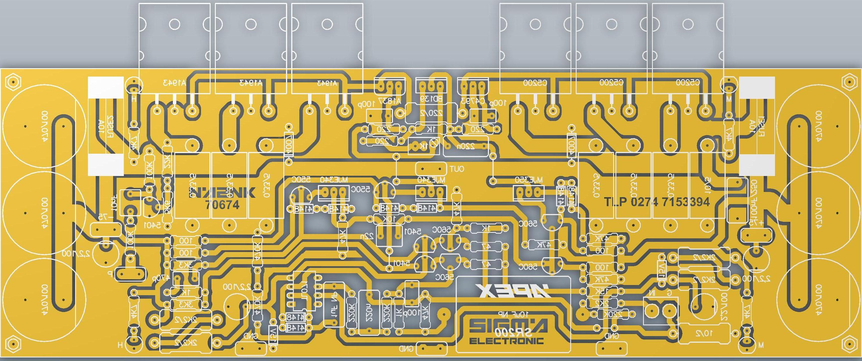

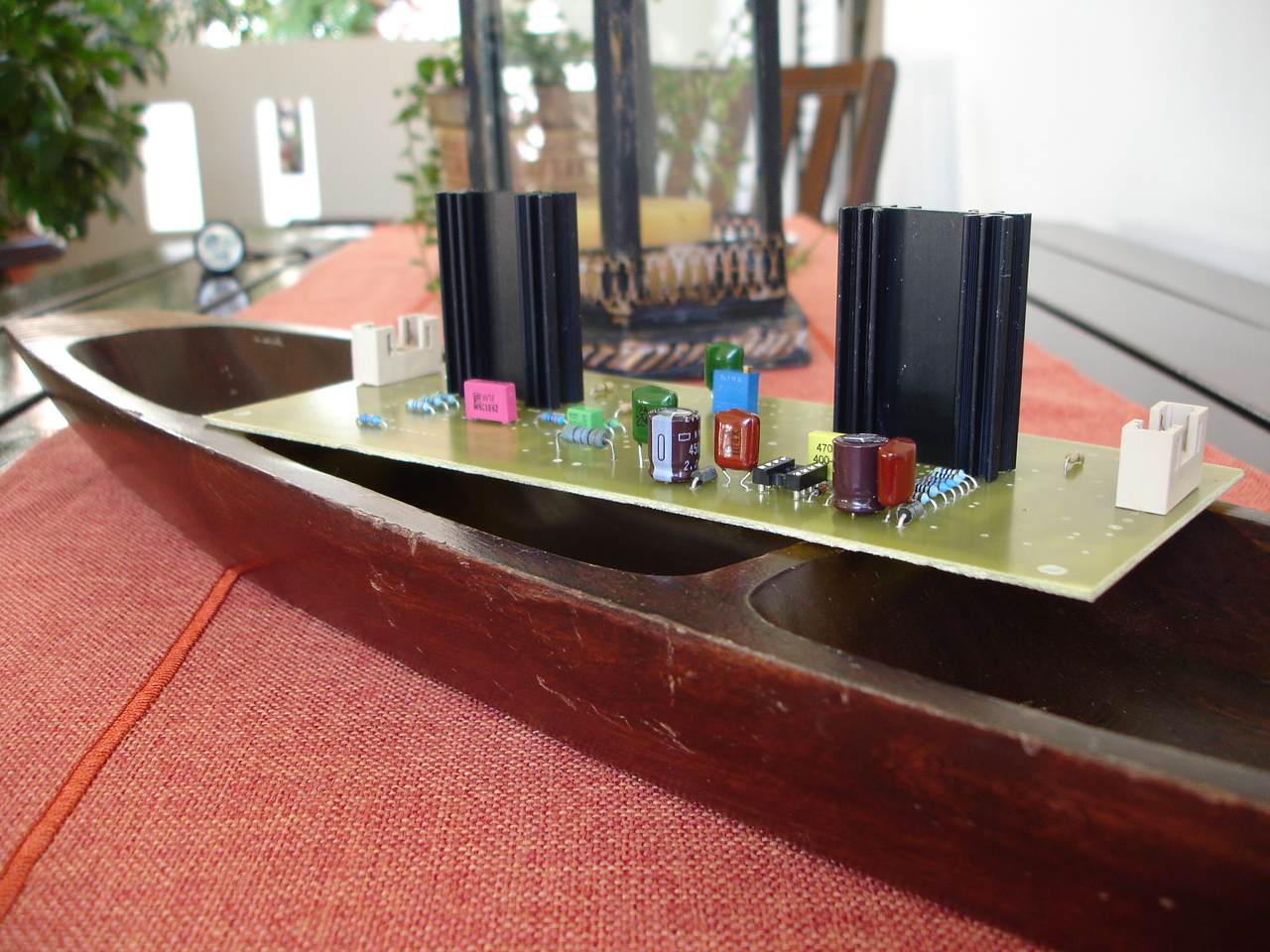

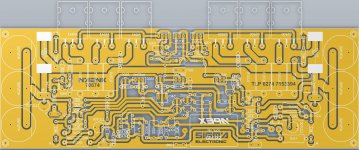

Hi Junie how about your vacations?
This version is 3.2? .
Pcb by Alex mm of cource:)
3 pairs output.
MJW21195/96

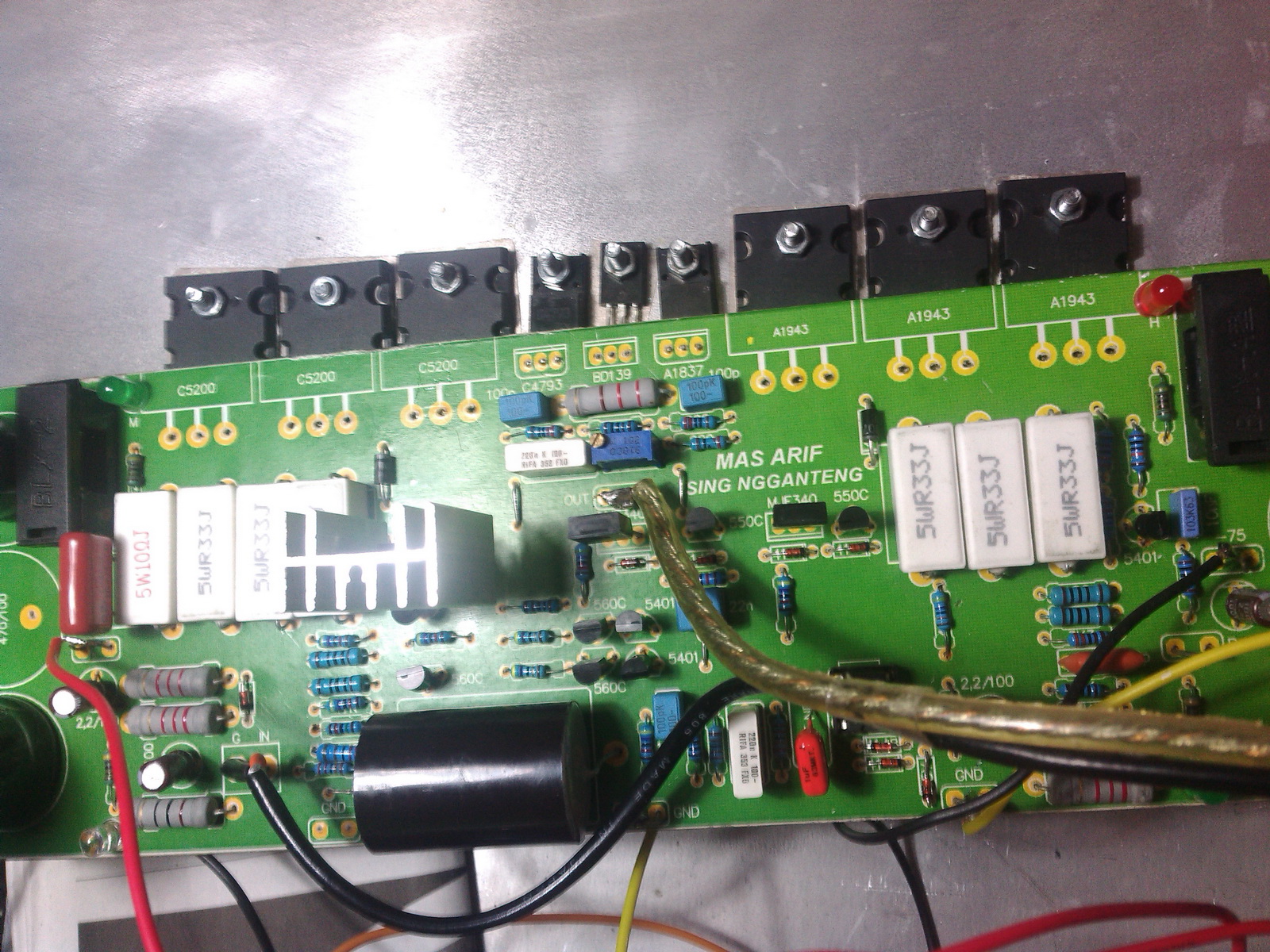

Ok Thim, thank you so much for your very kind attention. I will do measurement when I am fully recovered from my sickness soon. This is my 4th SR200, I have been Ok with 3 previous Sr200 amps. My friends really love these amps. And I want to build SR200 for myself. No commercial use only for hobby. I am just proud when some one likes my amp...

I will check my amp again...before it is fine only zobel network was hot when playing couple songs...
Strange behavior is, when first turn on, the dc offset is high, 300mv and more, and getting down after more or less 10 minutes up to 14 mV...
the sound is Ok...really like this amp...
