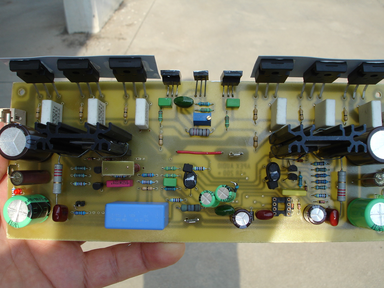

check all BC transistor maybe the hFE too much differences...
Today I changed all BC550B & BC560B to higher hFE BC550C & BC560C.
They are closely matched so DC offset should be zero
I'm cleaning the PCB just now but it is just too clean

After checked last night, I found that one of bc transistor was not soldered properly, soon after fixed it, dc offset measured 44 mV, after about 5minutes turned on then dc offset went to 24mV...my SR200 has 20pf cap...
I did matched all bcs and 5401...I am pretty happy with my SR200 so far, while waiting for my health becoming recovered. I will explore my SR200 again later...

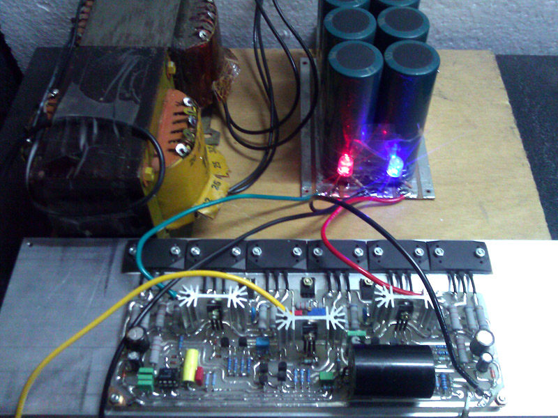

studio reference

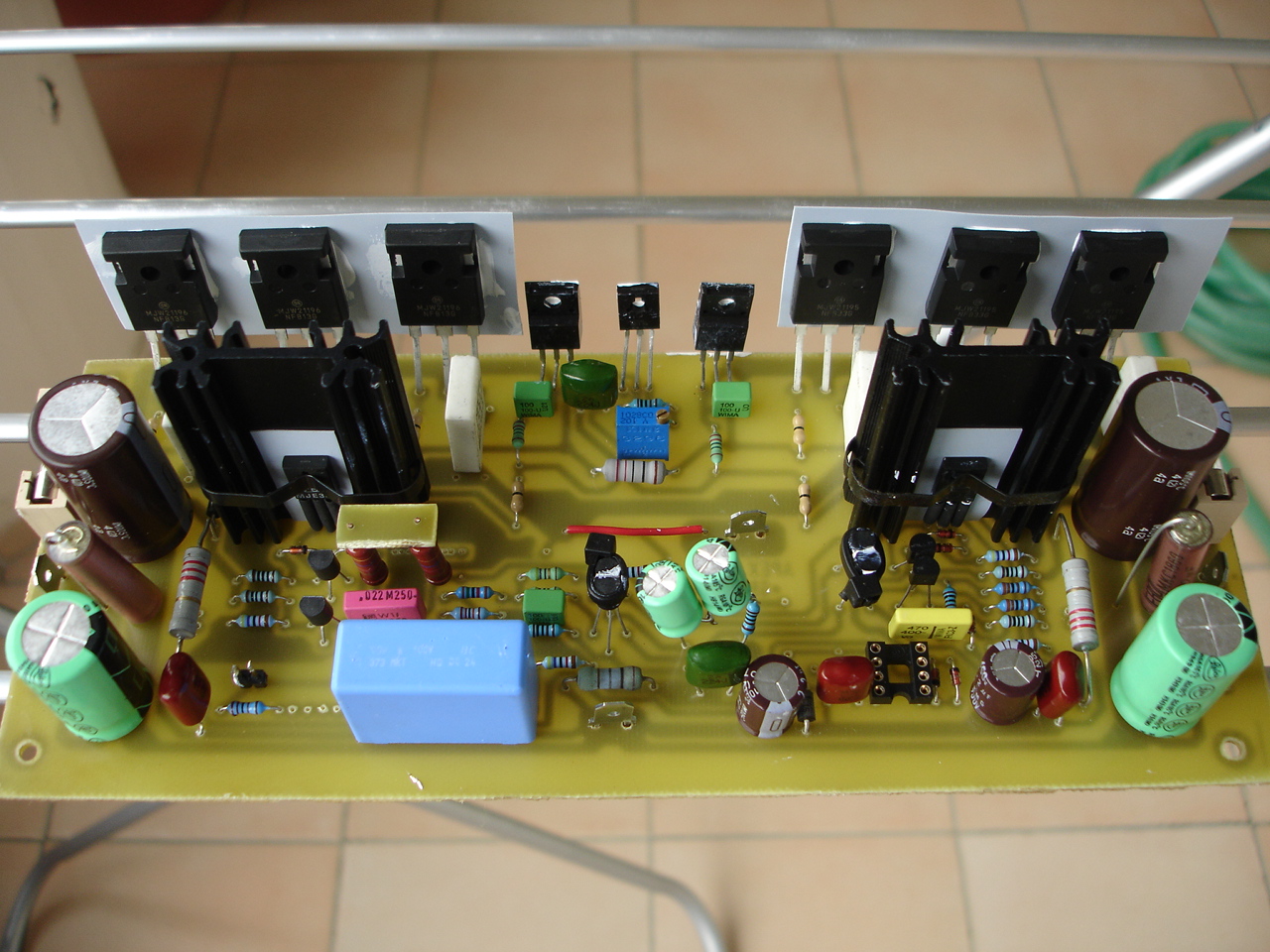

Just after first test!
+-/45V rail
150mA idle current
+1mV offset without servo.
And now the journey starts again.
+-/45V rail
150mA idle current
+-/45V rail
150mA idle current

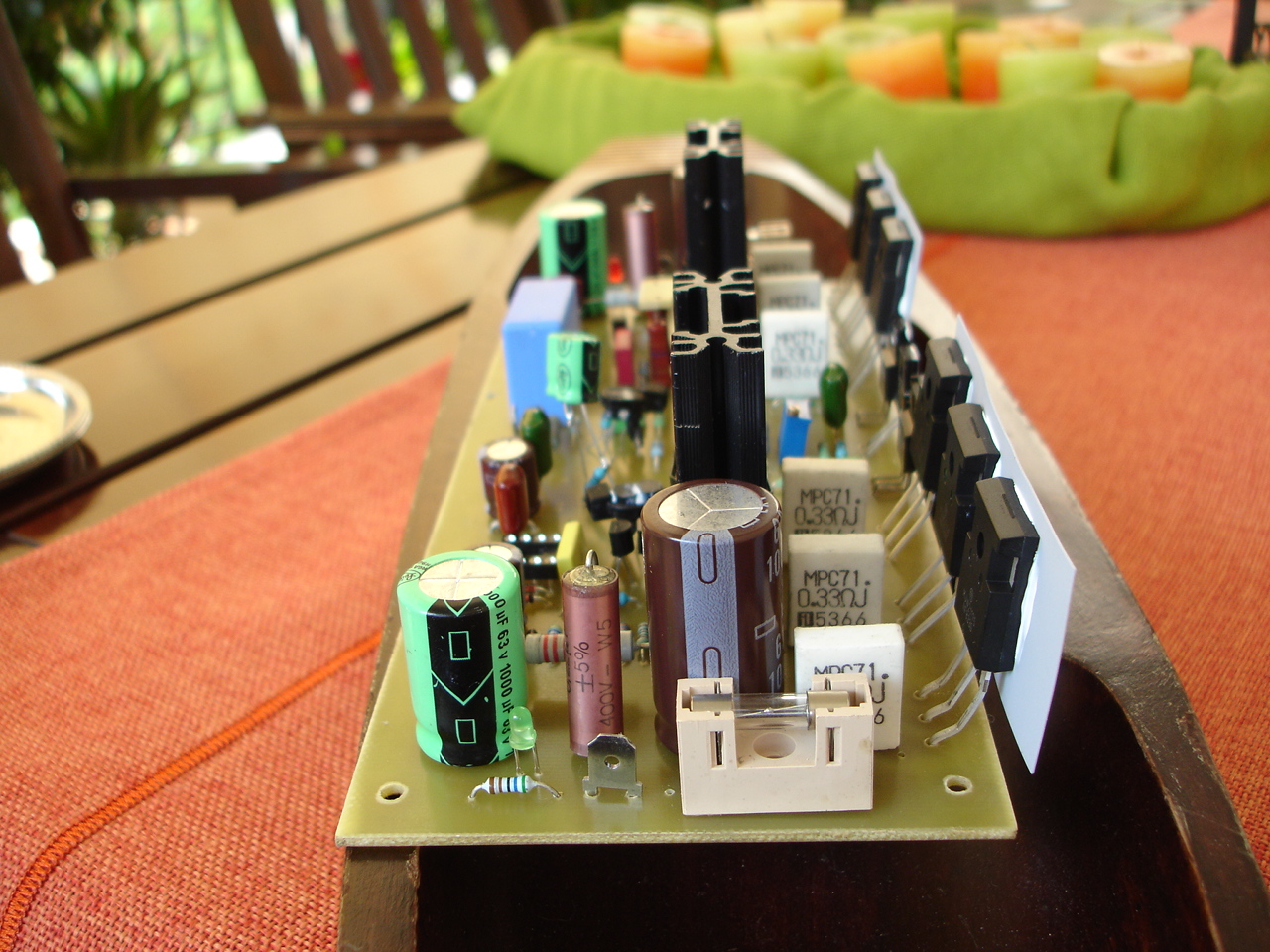

Hi all
SR200 now need speaker terminal, they are tested
2 x 300VA 50VAC each transformer, 2 bridge diode & 4 x 10000uF per rail.
to Mr Mile
I'm planing to build a single transformer 600VA but
2 x 50VAC for stereo or
4 x 50VAC for dual mono,
which one is better?
Please check this speaker terminal too, is this OK?

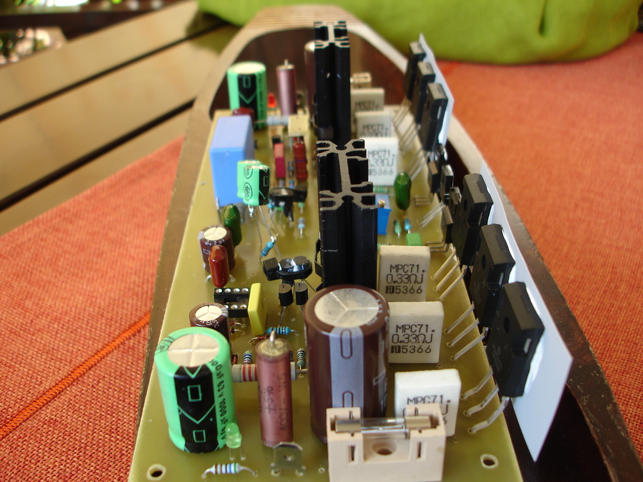

studio reference

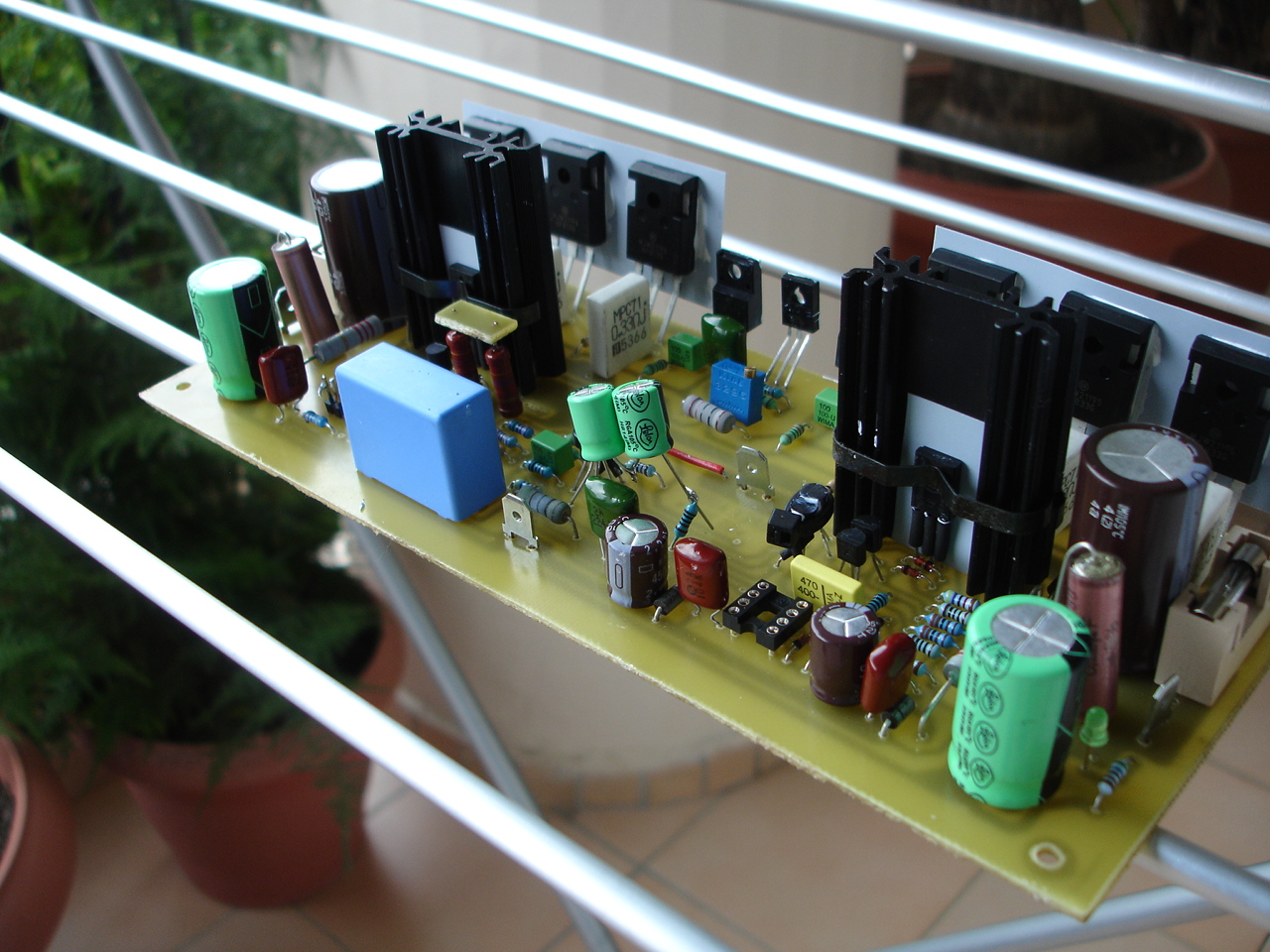

What about stability of your unit?
Have you add compansation capacitor( 18pf )between collector Q9 ,base Q2 or
it wasn't necessary.
I'm afraid that stability of this amplifier varies from one to next and i don't know why this happens.
I would be grateful if we had a reply from the designer about this topic and the appropriately addresses

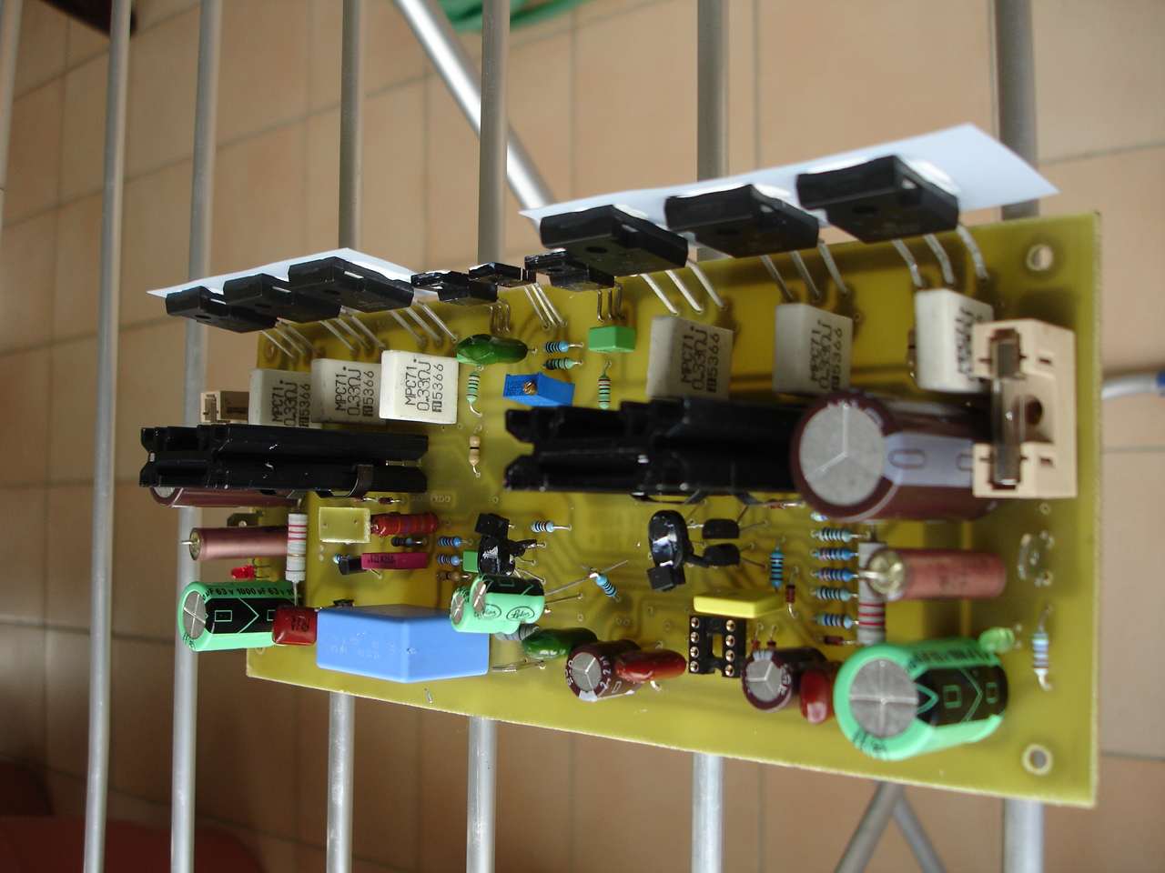

studio reference

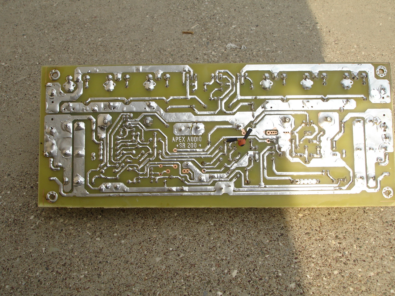

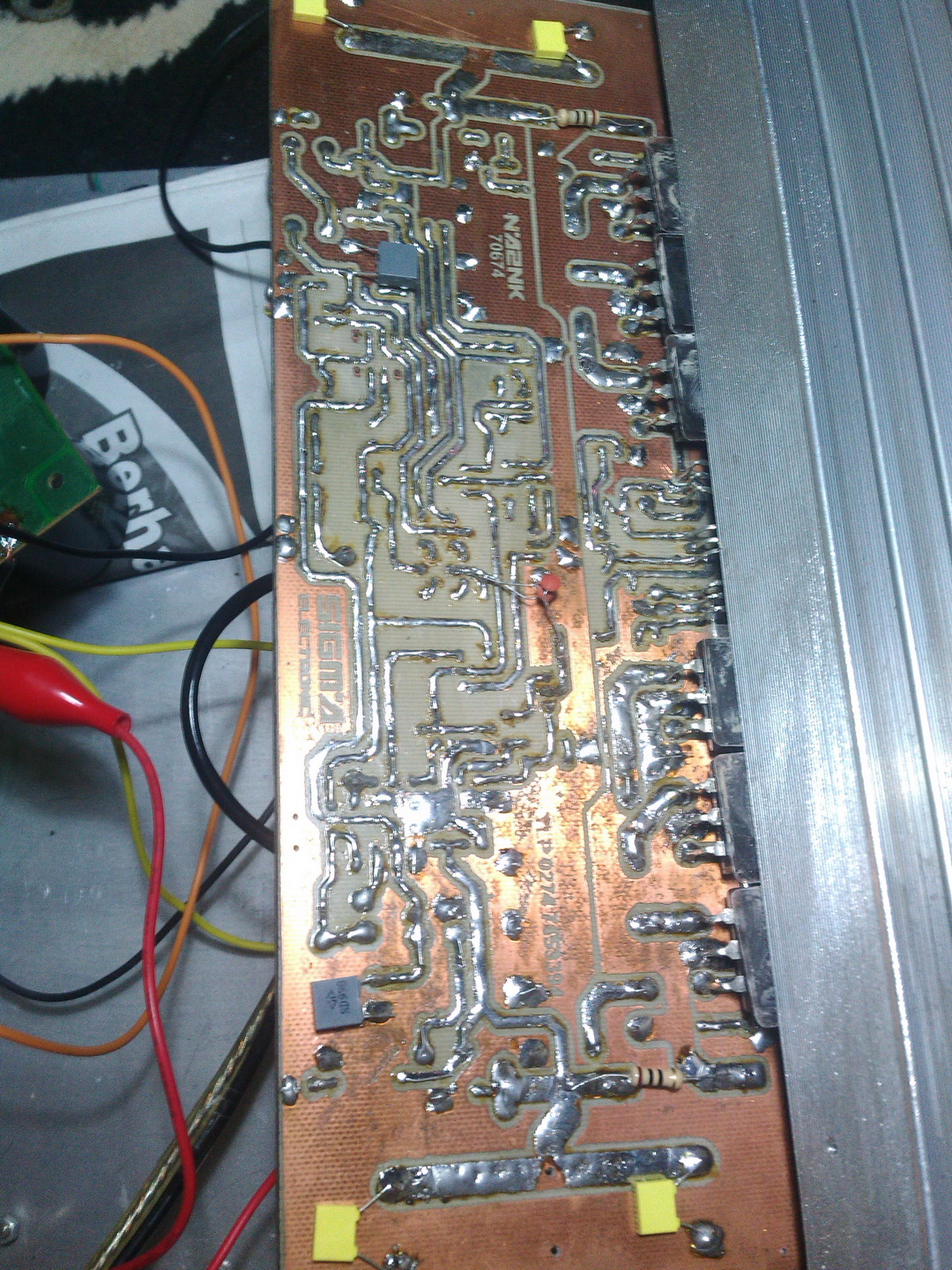

My new unit comes unstable when external zobel added (without any load)
V=34v on 100R instead of fuse.
When external zobel is absent and the load also ,V=15v on 100R.(normal condition).
That happens without compansation capacitor(18pf).
It's usefull to see what happens with zobel on board.
I can test this soon .

studio reference
Now the zobel is on mainboard .
Repeating tests with 10R resistors instead of fuses.
V=1.5V on 10R.(idle150mV/RAIL)
Testing the board with 100R isn't the right way at all.
The capasitor 18pf is connected, because oscillograms show the same results as in the previous board.
After this it's time for music!
Soon on youtube with the new unit.

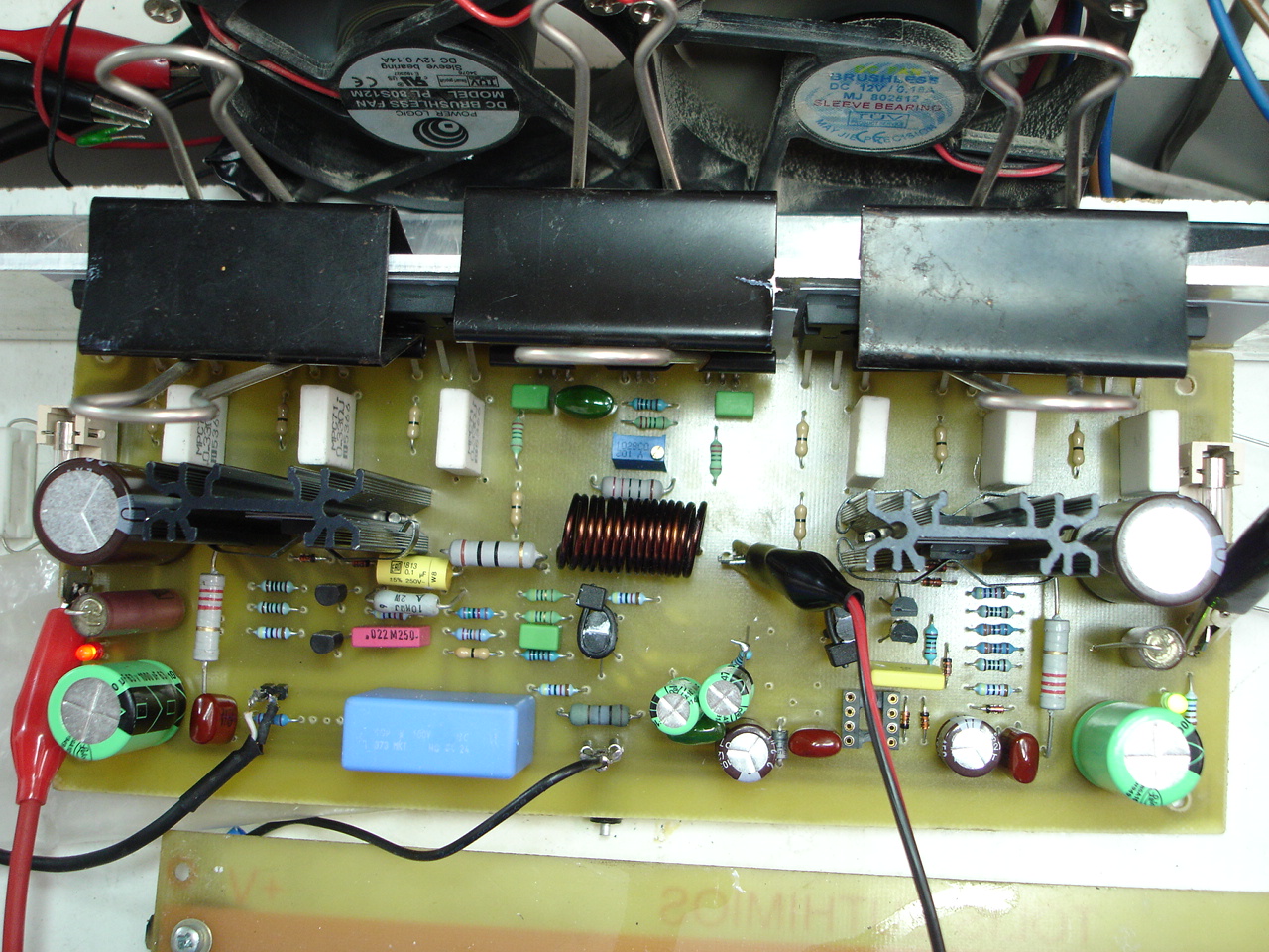

Hi Thim,Hi friend
I try without 18pF and the result resistor on zobel get quite hot... you know why
Then I add 22pF(this what I have) at collector Q9 to base Q2, now that resistor is cold...
I guess this cap maybe necessary if the heatsink on 3 MJE's is not grounded...
Thimios, do your little heat sink grounded?
I can't grounded it so 22pF or maybe 18pF is the best I can do with my PCB
because the error when I made this PCB all parts is on the copper side
Ok, we waiting what Mr Mile says about it...
Regards

The problem is independent of transistors grounding.
My first unit haven't heatsink grounding.
Second have these heatsink grounding.
Same problem on first and second.
Hi Thim,
Regards

studio reference
Hi Mr Mile.
Please tell us which is the recommended pcb for the sr200 amplifier.
Regards.
Stability depend of pcb design.

You can use all pcb designs by 'alex mm' just add extra compensation. You can see extra caps for compensation on many brand amps placed on botom side of pcb.

Thim, that is the only way to tame oscillation that work very well, now I'm enjoying the sound of SR200... Don't try another things, that compensation is from the designer guide. He know what is the best to do with this amp...It's usefull to give us more details.

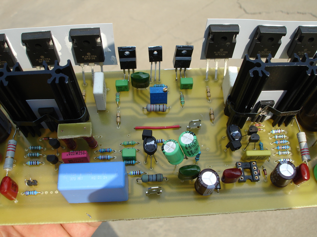

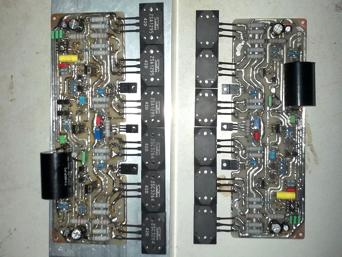

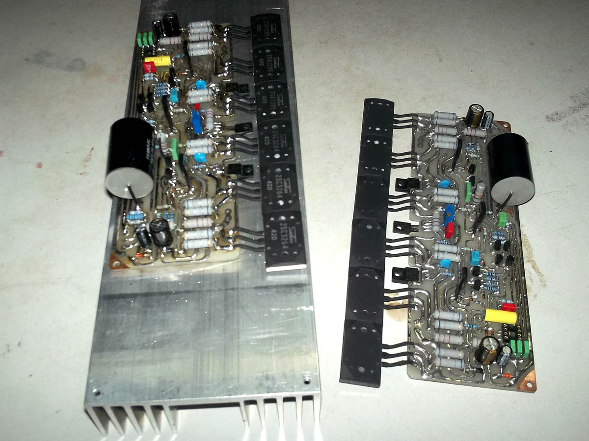

Now both SR200 I've build bias with 17mV at RE 0,34 ohm (2 x 0,68 ohm that I use)...
after adjust bias now :
Deep bass that I'm looking for is there
bonus with clear high, noise free, dead silent when vol is minimum & very great music when playing
Oh, why I don't finish it earlier (the PCB is from last year)
Apexaudio / Mr Mile thanks for sharing this SR200, & for guide us how to make it stable.
Will build better PSU next time & of course waiting another new amplifier from Apexaudio
Best Regards
