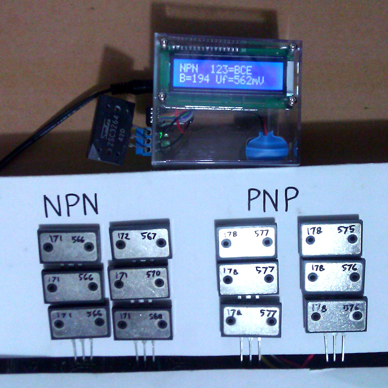

And this is 3 pairs Sankens that I want to use :cool::cool::cool: they look great
kang Naf do you know what the meter says...
B=beta Uf=...?

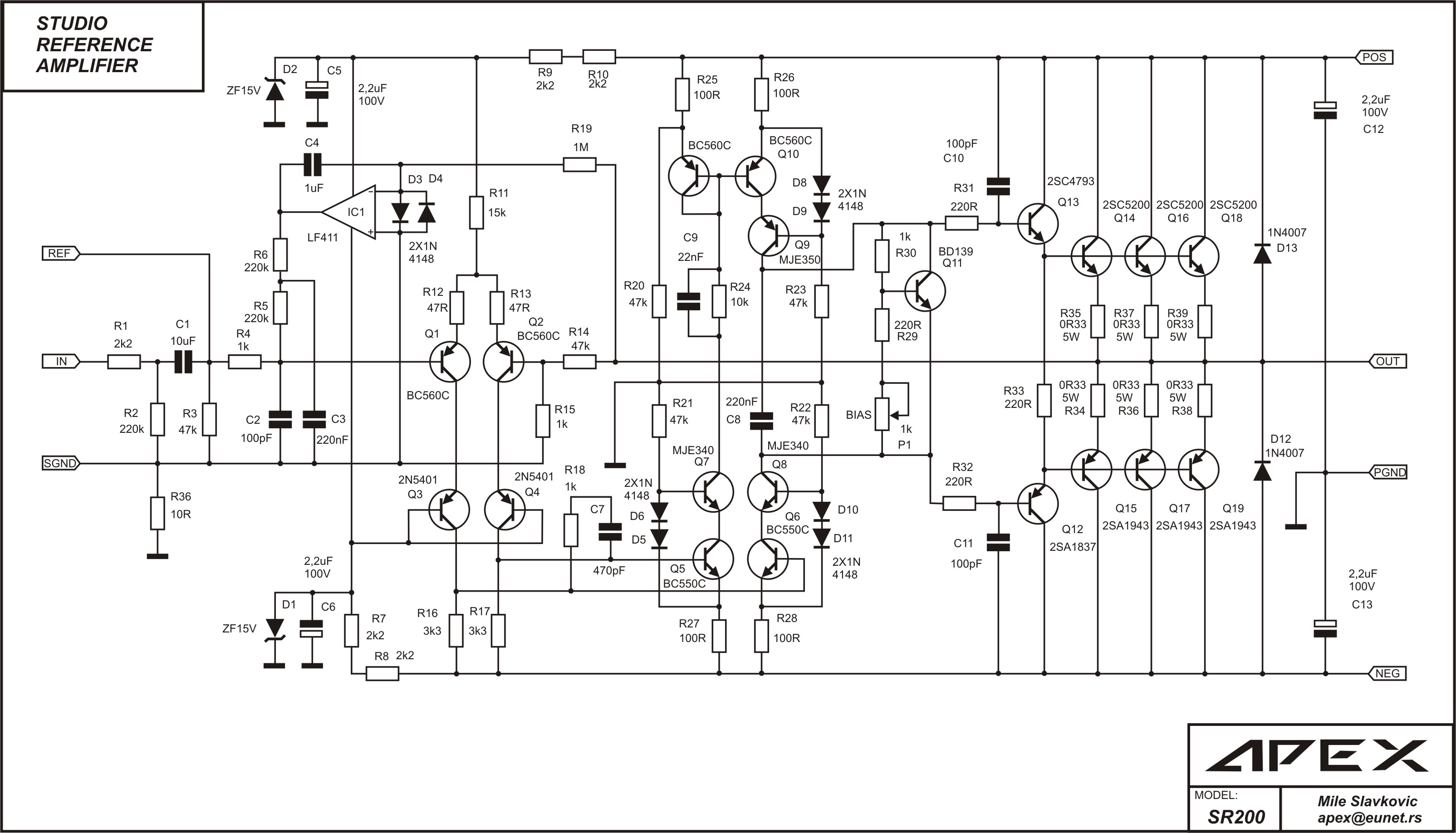

R11 on my circuit is 15k, & all part just like in this schematic:
To Mr. Mile ...
may I change input transistor to 2SK170 ?
(have been mentioned in old post but no one make it)
If can, please tell us what need to be changed...

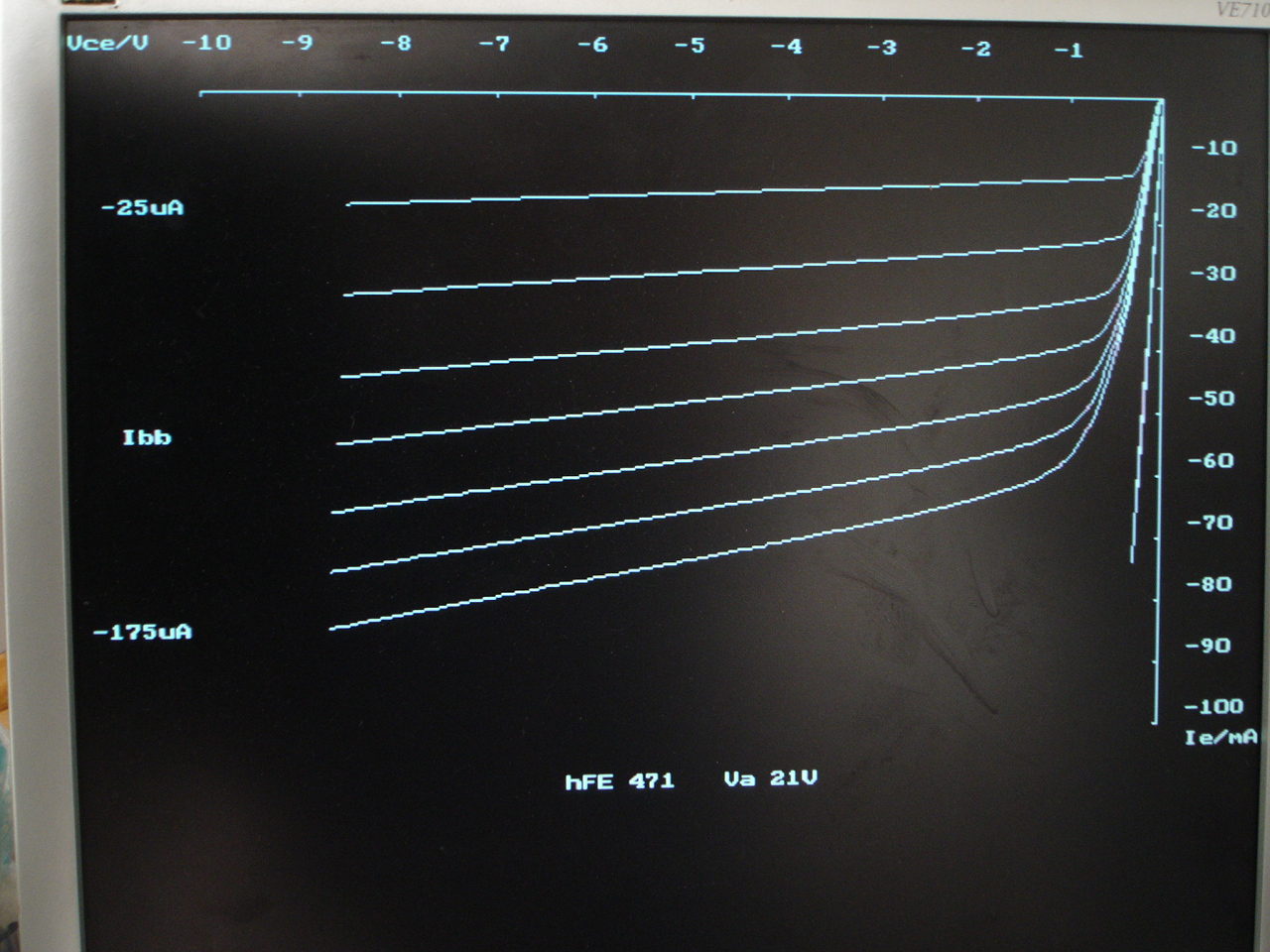

Look at this.
I use this Elektor published curve tracer.
Keep in mind that with all theese circuits you can match small signal transistors only.
It's not recommented to match power transistors with that's circuits.
For power transistors matching you need high current and high voltage devises.
I see circuits like this in Elektor but i haven't made something like this yet.

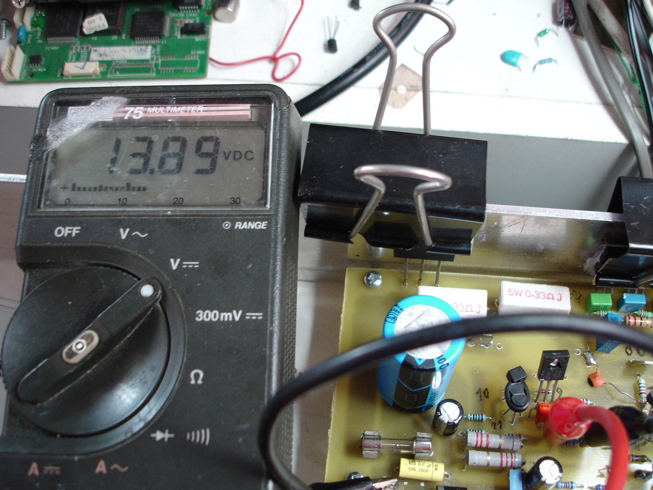

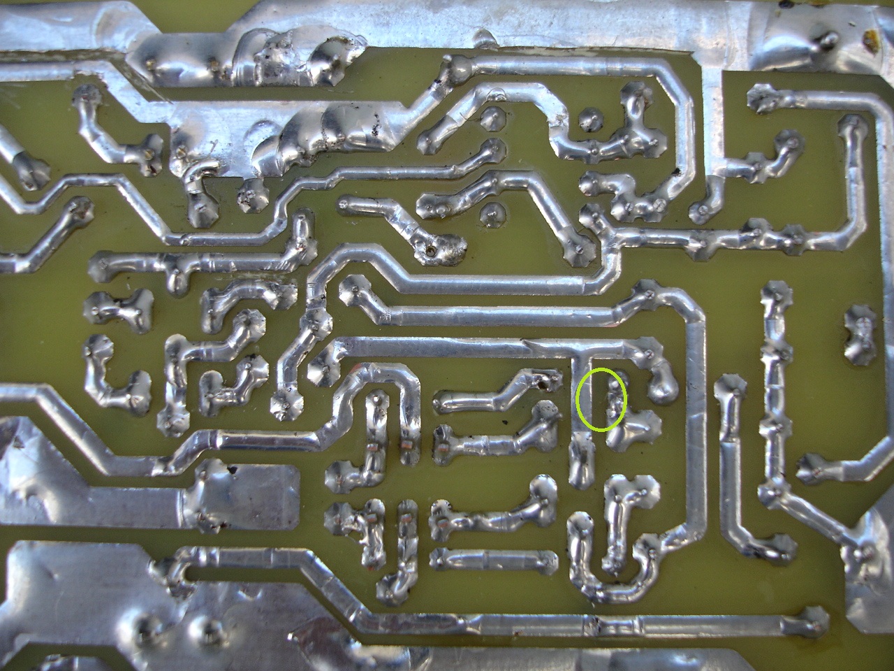

I check again my SR200, now in cold heatsink... DC offset is 0,..mV
V base Q2 to ground = 63mV
V on R14 = 59,6mV
check this http://www.diyaudio.com/forums/solid-state/173462-studio-reference-amplifier-77.html
that because not grounded heatsink & missing cap...
Thimios, do you use small heat sink for all MJE transistor & grounded the heat sink?
they are warm(maybe hot) on +/-45VDC

59.6V on R14 .... This value is with or without servo?
63mV bace to ground Q2 is with or without servo?

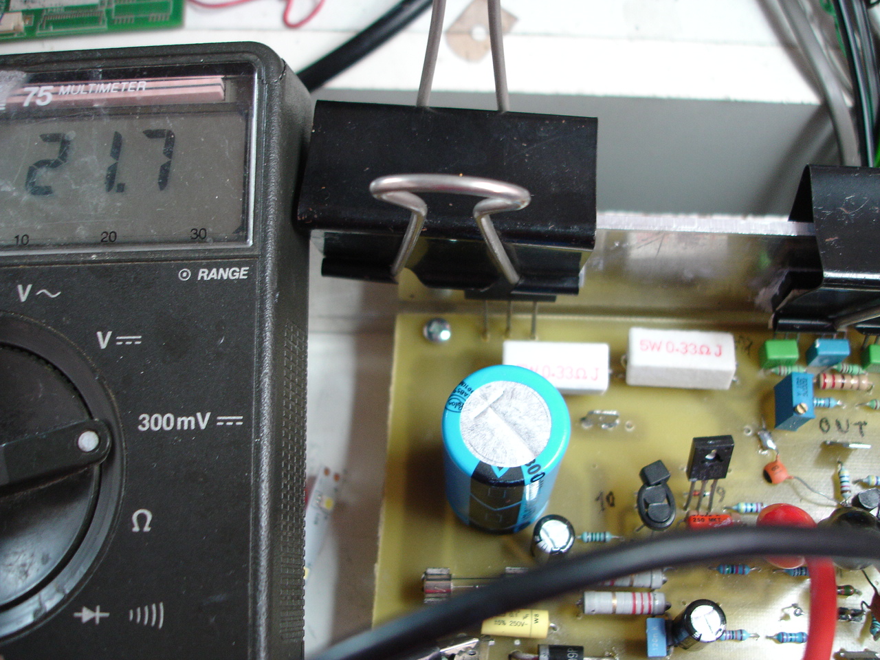

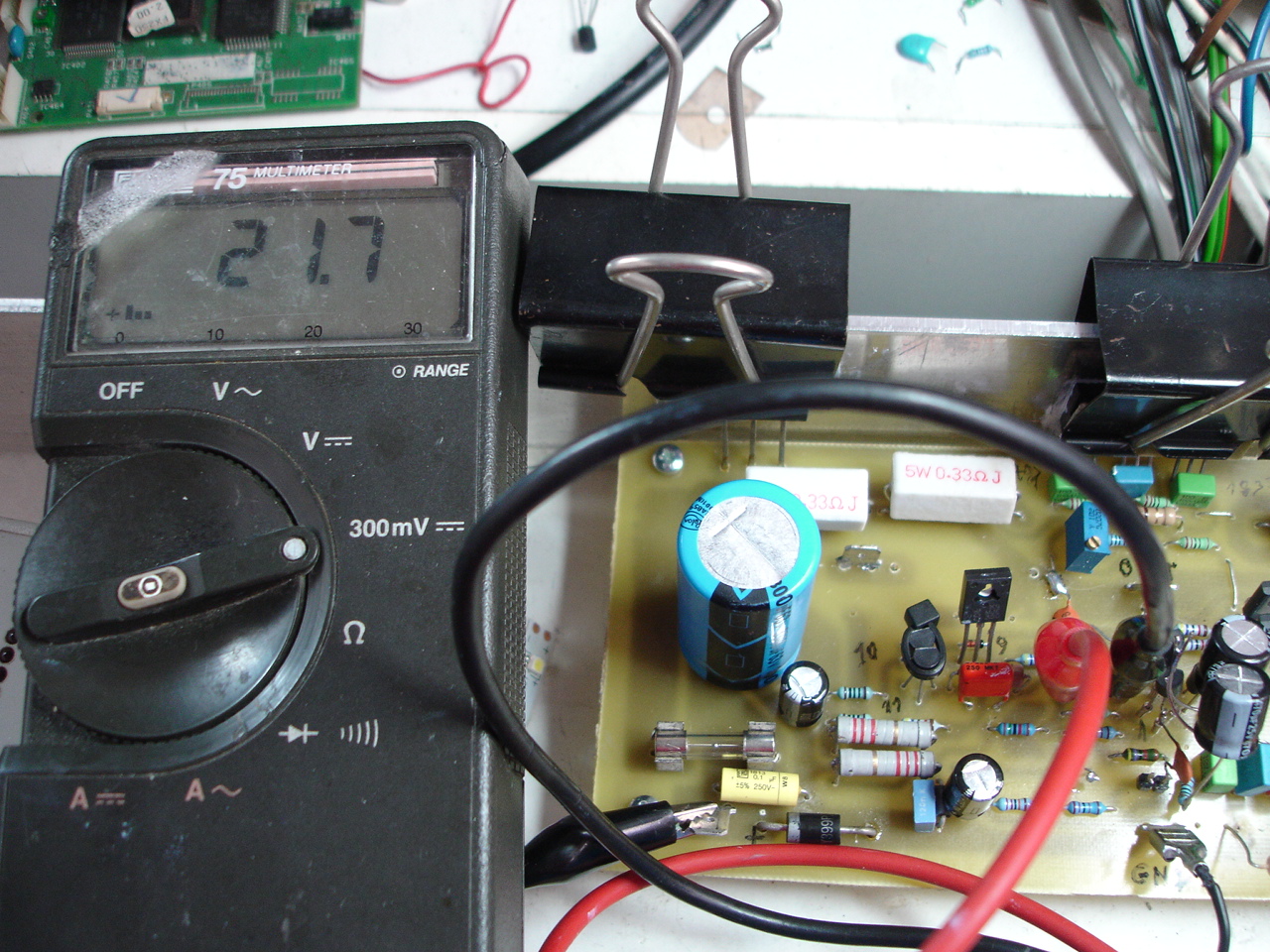

Thim,
R33 (220r) in post1323 sets the driver bias current. This will make the drivers run warm.
What resistor value and what voltage do you have across R33 in your builds?
Hi Mr Adrew R33=220R
This time haven't circuit diagramme on my hands (where i has write some measurments) i come back in a few minutes.
Thanks for all.
V R33=1.2V
sr200 studio refer.
That seems normal.
~5mA will be warm.
Where does 5mA put the transistor in it's typical hFEvsIc & fTvsIc?
Maybe the drivers are too far away from optimum Ic to operate as fast drivers.

Apex,
could you make a designer's comment on my post 1330?
Could a very low driver bias current make the amplifier susceptible to component variations?
Could two apparently identical builds end up behaving differently due to the transistor parameters being sufficiently different?
This is the reason why the design was changed to a triple emitter follower for SR800

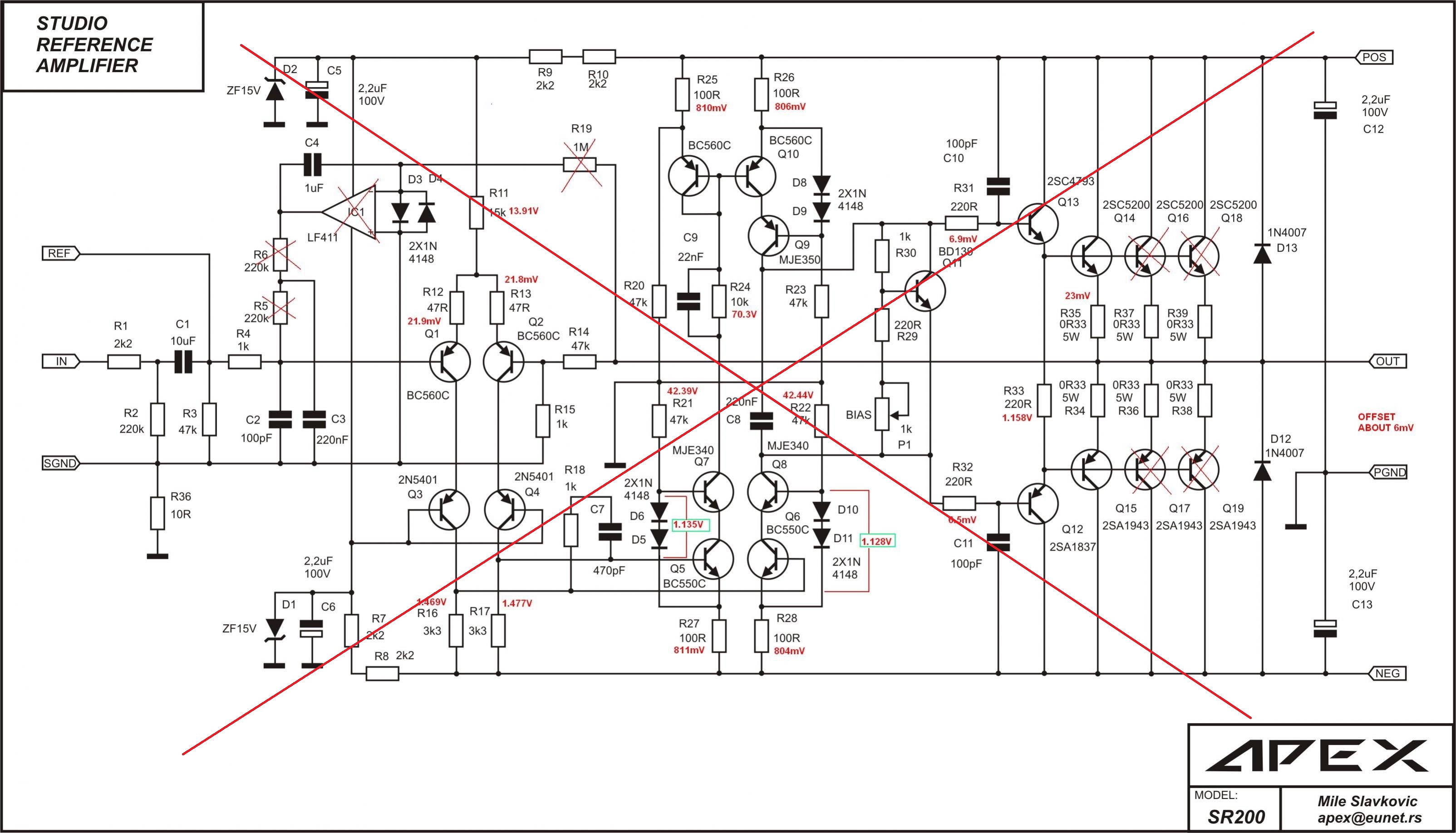

Replace R11 with 8k2 instead 15k.
Regards
Everything starts from here.
This modification is the cause of the problem.
Today early in the morning about 5.30 o'clock i examined the amplifier again.
But this time I was sure for the pcb because it passed the point to point test.
As changing transistors and matchig didn't solve the problem, having in mind that the others' amplifiers didn't have the problem,i decided to return to the original circuit.
So i put at R11 the original value 15K.and that was all!
Thanks everyone for trying to help .
Especialy thanks Mr AdrewT who advised me to stabilize the LTP without servo.

I also attach this hopping that it will be useful
