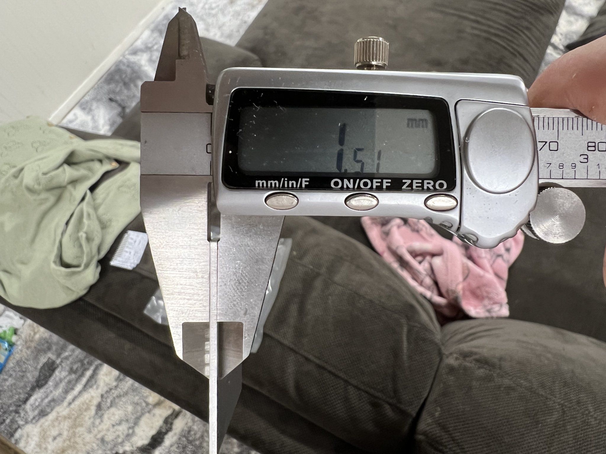

If anyone else is curious about this in the future this is the answer I got from JLCPCB
“For aluminium board, the Aluminium thickness will be the total thickness minus 0.1mm.
That means the 1.6mm Aluminium board will be with 1.5mm Aluminium.
The thicker and larger the Aluminium board, the better heat sinking it have.”
They then gave me some selling points on their new copper core boards and they definitely look good, but I’m thinking that the aluminum will be sufficient in almost any scenario as that’s really what most everyone else is using. So I went with the 1.6mm aluminum of course. I was VERY tempted to get the copper since I was getting 50 boards, but at 3 times the cost I eventually just decided on the aluminum. If I get to a point where I need to get more of these boards I may try the copper. Unless of course someone can point out a place that makes the ceramic.

Are you sure it’s that way? and not the other way around?
I can’t see how the fibreglass is only 0.1mm thick, I would think it’s the aluminum
Guess I’ll see when it gets here, that answer was direct from JLCPCB product support. I guess if they messed up and got it the wrong way around that I’ll have proof and hopefully fix the issue and send the 1.0. You say that you think it’s the aluminum? I don’t thing 0.1mm of aluminum would do much, it would be saturated pretty quickly.
Edit: so yeah it looks like they were right. There is no fiberglass layer from what I can see, just the copper layer with solder mask on top of it, then a thin dielectric layer and then the aluminum making up most of the thickness.

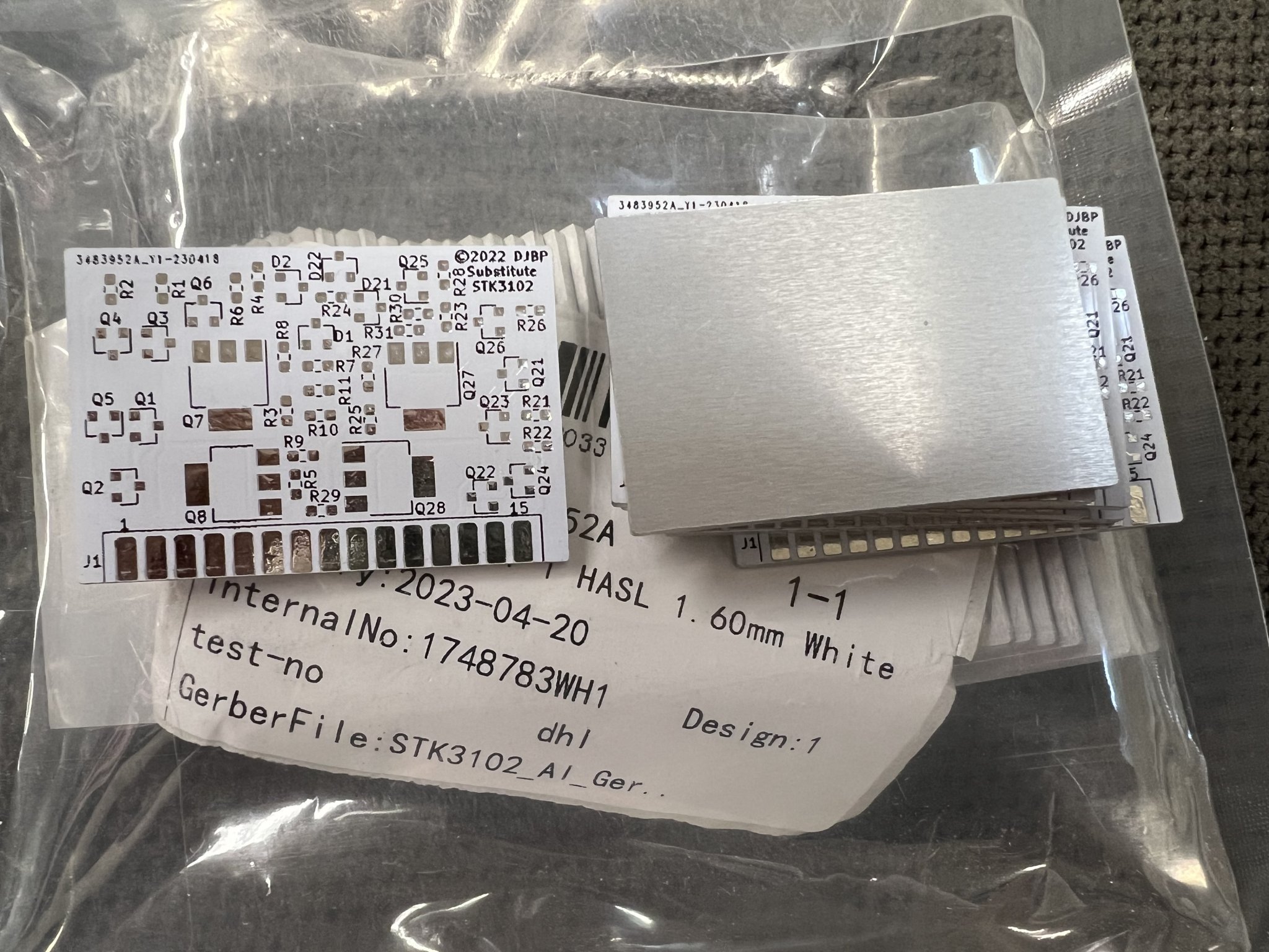

As promised, here is a pic. They were delivered about an hour ago.Looks like it is as they say, I went through the online quote tool
0.1mm thick dielectric having 300V breakdown
interesting the price does not change with thickness
post a pic of the pcbs when you get them
The tag states 1.6mm, seem a bit shy of that, but my calipers aren’t precision I’m sure.
Only thing that will suck about these boards is their difficulty to solder over standard FR4, but that’s what makes it a better heat sink.

Looks good,
Could get a stencil made to deposit paste and reflow solder on a hot plate
You will find out how much heat gets conducted once you hand solder. Tabs on the sot-223 look to have some copper area to conduct heat, do you have a temperature controlled iron?
Yeah I considered getting a stencil, but I don’t have a hot plate and I know it isn’t expensive, but I also don’t have solder paste and figured I’d give it a go with my regular station. I use a Hakko FX-100 which is an induction style, identical to Metcal. The temperature is set by the tip itself and being induction has pretty incredible recovery. I generally use a micro wand and tips for SMD stuff, but I’m thinking that with this board I’ll need all the thermal mass I can get and should use the standard size.

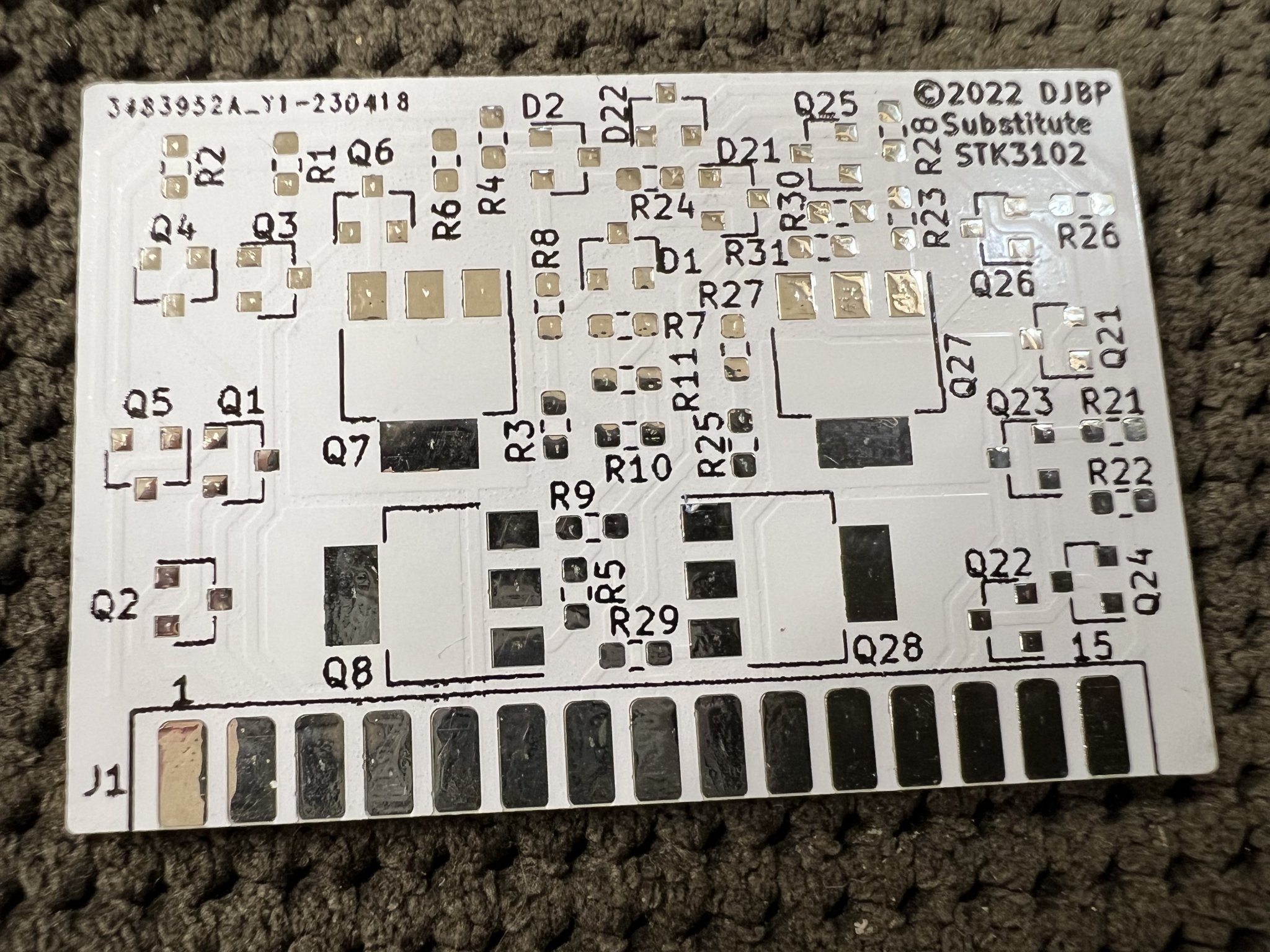

I designed this board with plenty of room around each pad, so a normal iron and 60/40 solder should work fine..As promised, here is a pic. They were delivered about an hour ago.
Dan
Don't use a too fine tip

It’ll be going into a Crest Vs900 power amplifier. Nice amp with plenty of power, it used a STK3152III. I’ll get it built up and see how it goes. I only bought 50 because the price increase as I went up was minimal. It wasn’t until I jumped up to 75 boards that the price increase was substantial. I’ve seen plenty of people asking if they could buy a couple off of people so I figured I could help out the few that do. Plus I have multiple amps that use these and think that maybe it would be a good idea to replace them as preventative maintenance.
