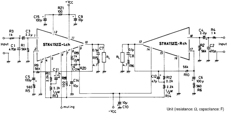

STK 4152 Schematic
STK 4152 / 2*30Watt can be Bridge?
I want to ask with anyone,
i have stk 4152 chip, stereo 2X30 watt. from my sony ampifier
can i bridge this chip so i can use 60 watt Power amply/ 30+3-0 watt.
need advise an info.
sorry about my english is not good
this is the schematic of STK 4152
thx

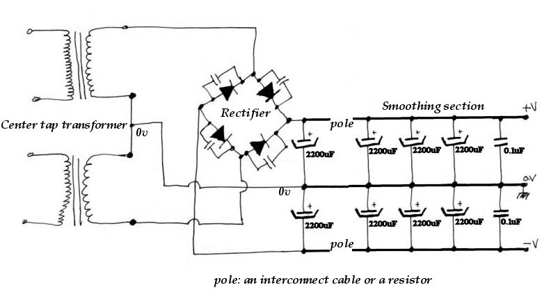

I like to view the power circuit as three seperate boards:
Rectifier board
Power supply board
Amplifier board
I like to see these connected so that there are "poles" between, and we can use either a resistor or an interconnect cable to establish a pole.
Assumptions:
The amplifier isn't bridged
The power supply is linear unregulated
Not everyone owns very huge speakers and those that do might like to hear them do their thing.
Many chip-amps of all sorts, are slightly bass shy from 20hz to 50hz
The STK chip that we're using is a model that pre-dates "modernized" (fictional) power output advertisements.

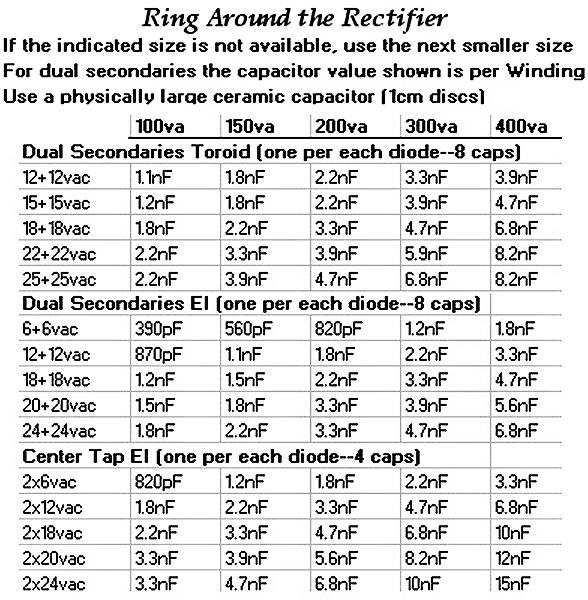

Rectifier board:
Common choices for transformer are 4a, 6a, 8a.
Most of our STK application notes will call for the 4a, but may I encourage you to go "1 step up" and get a "generous" amperage transformer, if budget allows? In the linear, unregulated power supply that's one sure-fire way to get some good bass and avoid the typical midbass issues. As for midbass, its so much easier to cause it than remove it. Like a bell, the larger size transformer rings a lower pitch. Like a loudspeaker's crossover, the power supply is a filter for the transformer.
Sure, you do have the option of using a purposefully overlarge dual-secondaries toroid transformer and eight of MUR860, but, I'm not promoting that, as it doesn't match the classic applications.
However, the classic applications of these STK used EI core, and most of them were center tap:
From the service manuals of the original amplifiers, we can see large ceramic caps at the rectifier. While 3-pin ceramic caps are rare, we can do the same job with regular ceramic caps. They'll need to be physically large, such as almost 1cm across the disc (although smaller physical sizes can work). This is incompatible with soft switch diodes, so use regular diodes or a 1 piece bridge block, like the currently popular KBPC2504.
Before giving the sizing chart, I'd like to reference the CarlosFM power supplies:
One way to get enhanced bass from the amplifier is to locate a pair 4700uF caps at DC side of the rectifier board. If you get too much bass, just size down a bit to 3300uF. One or two pair of Cornell-Dublier's Mallory SEK 50v 2200uF is also an option. The rectifier board is where you put the "bassy" caps. This disturbance is a signal and so, it belongs close to the rectifier, if anywhere at all. Later, our power supply board will be able to smooth it out to cleaner DC.
Here's the chart for paralleling small caps to your diodes at the rectifier board (click on picture):
In the original service manuals, there's about 8" of cable from the rectifier board (above post) to a pair of 10,000uF caps.
Refer to the carlosFM power supply thread to see this in action.
You can use the interconnect cable or resistors, and the usage of resistors is documented on the carlosfm power supply threads.
Bleeder resistors go on the power board, not the rectifier board.
Also, see chipamp.com's power supply. Recently, I used a board like this, but omitted its onboard rectifier. Of course, I did use a rectifier on its own seperate board. Its described in the above (previous post). I connected it as described in original STK service manuals, via the 8" of cable.
Rectifier - 8" cable (or resistor) - power board - cable - amplifier board.
Another way to see it is:
AC2DC board - 8" cable (or resistor) - DC board - cable - amplifier board.
EDIT: See also the CarlosFM power supplies here on diyaudio.com.

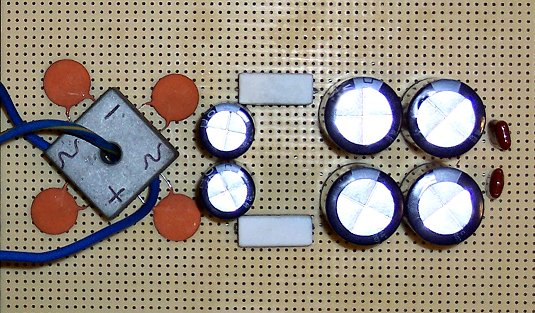

Simpler alternative, photo is here.
Not shown: Bleeder resistors go under the 2nd pair of 2200uF caps.
EDIT: Not shown: The first pair of 2200uF caps (those closest to the rectifier) may be, instead 4700uF caps, if you'd like more bass. Those closest to the rectifier need to be rated for 2x rail voltage (like for 25v rails, use 50v caps).
For the rest: Click photo. ;)
Sample:
This has 1 pair 4,700uF and 2 pair 10,000uF
Not shown: Notice the striped cable from the transfo is the 0v line, which also runs down the center of the power supply via a thick cable.
Not shown: Bleeder resistors under the first pair of 10,000uF
Not shown: Resistors shown are wrong--use Non-Inductive resistors or a length of interconnect cable instead.
Perhaps the prettiest power supply that I've made, and it took only 8 minutes. ;)
EDIT: This is related to the carlosfm power supplies. See those threads here at DIYaudio.com for more information.
