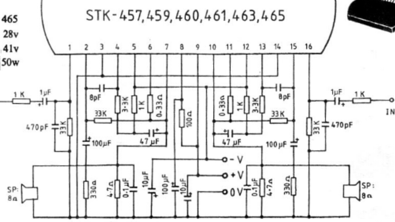

Can anyonehelp me out with a picture of the veroboard circuit for the amp using the 463. I have a picture of the circuit but having a hard time with getting itbon veroboard. Im not the greasted with computers.

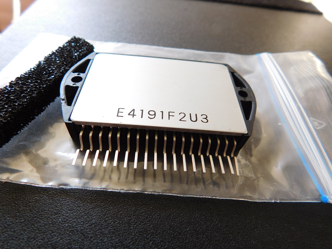

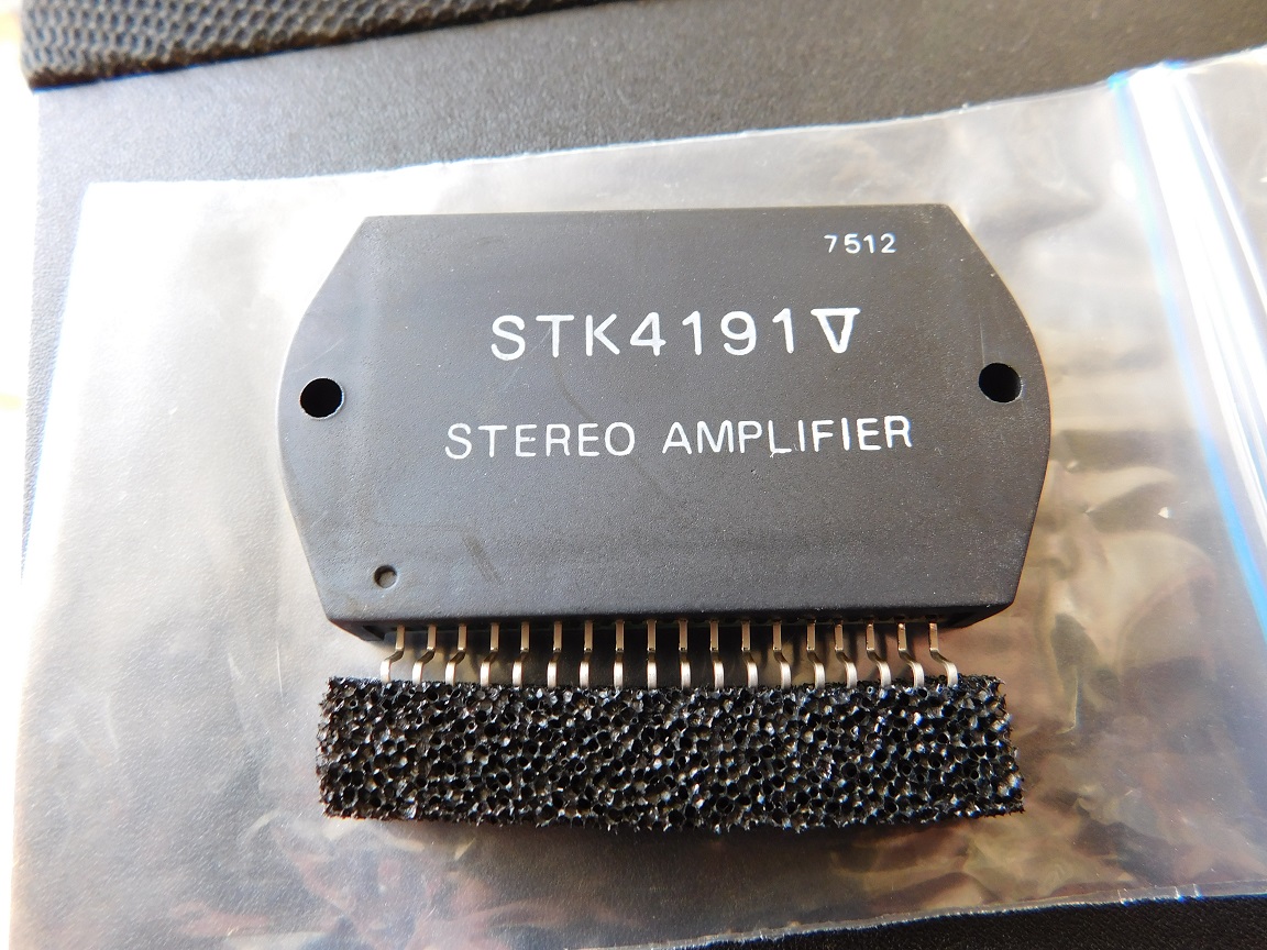

I just bought some STK4191V chip amps from an Ebay shop in Europe.
The shop promised these were genuine Sanyo chips but as many fakes are in circulation I want a second and third opinion...
If these are not Sanyo I would like to know if anyone has experience with using chips from the maker of these chips and who the maker might be.
The chips do look very well made, the only thing I can spot looking a bit off is that the surface of the package is a bit too smooth and uniform compared to the known to be real Sanyos I have access to.

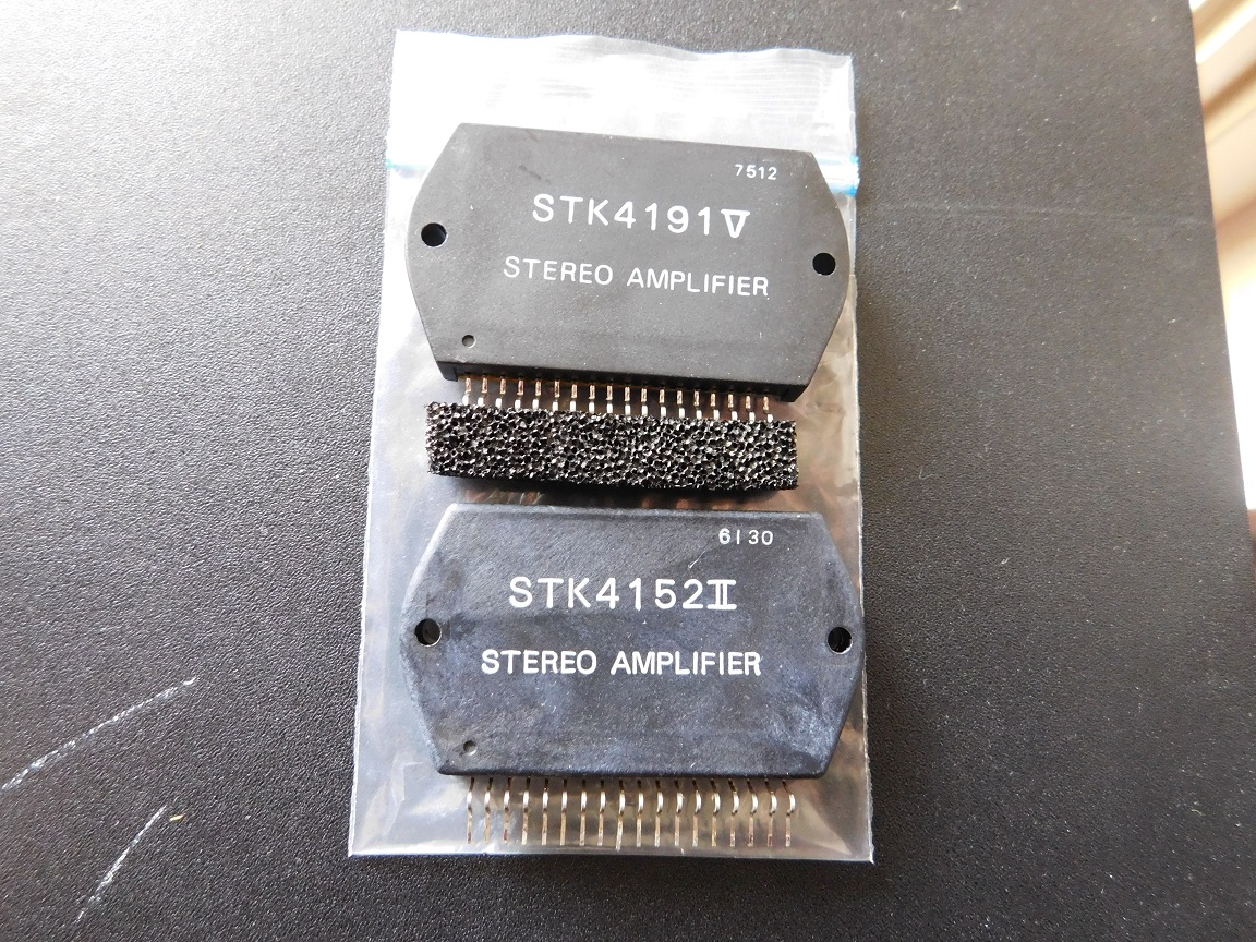

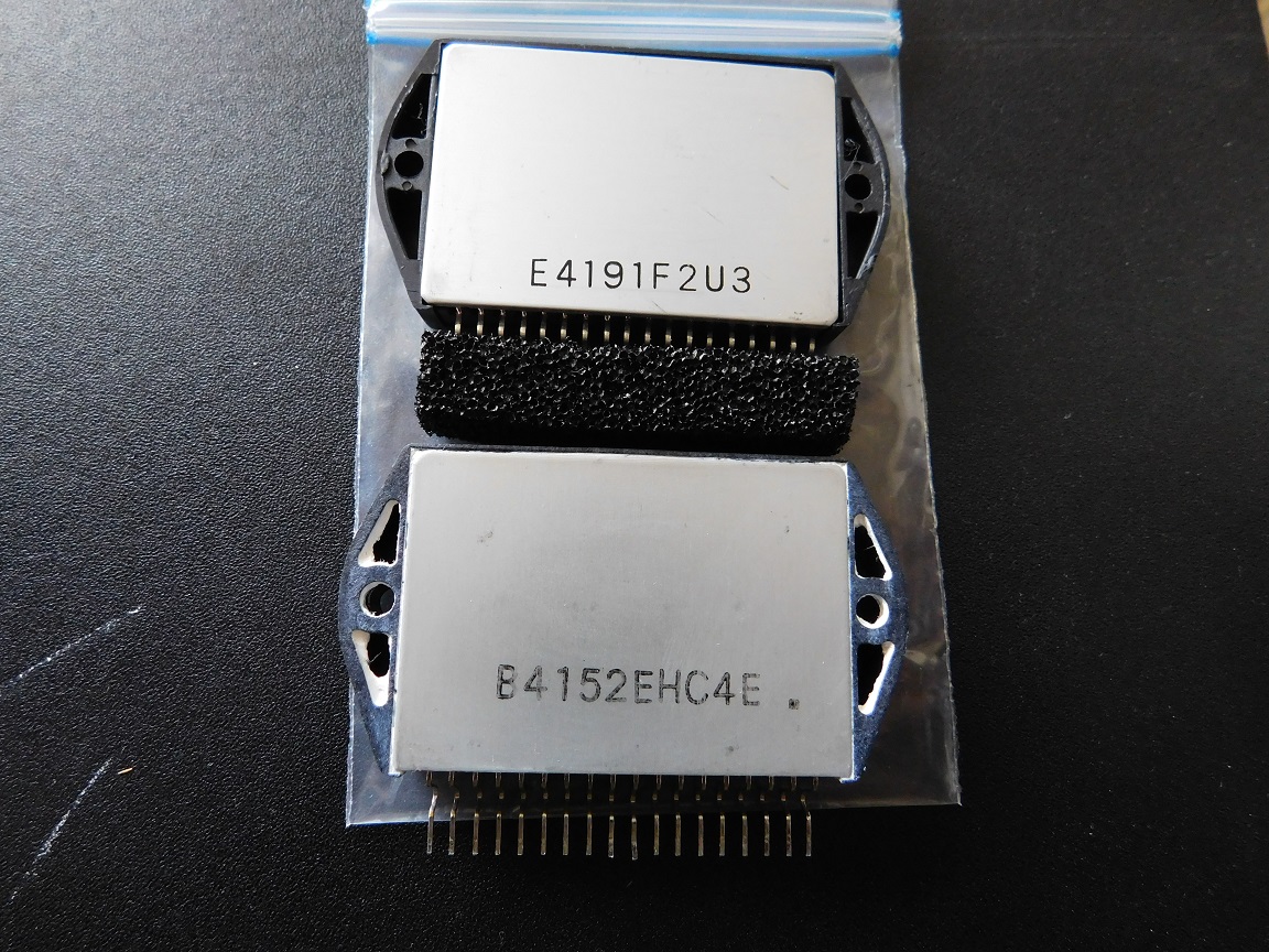

I desoldered a genuine Sanyo STK module, it's not the exact same model but it's a compatible one using the same package.
When you have them side by side it's easy to see they are not at all the same.
Either Sanyo did some retooling as the edges are different and and also changed the resin for the package as it also is different or the ones I got are fake.
On the backside we find that Sanyos engraving isn't deep at all while the the new module has a much deeper and clearer engraving.
What do you think, is this evidence good enough for Ebay?

I suspect the E4191F2U3 is a fake. The molded bakelite case is very bad quality. I'm pretty sure Sanyo QC won't allow this to happen.
