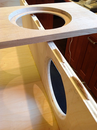

Recess and Roundover for Driver Cutout
I trust with that thick a baffle you've provide lots of chamfer or radiused relief to the rear side of cut-out - a hole lot easier before assembly than afterwards.
Yes chrisb. This build is quite fascinating and thought provoking as I have to think a few steps ahead, not having built a speaker before. Reading this forum has been immensely helpful.
Here are the 2 pieces of the baffle. Oak with recess. And BB with 1/2" roundover. I'm still not sure the roundover is enough. But I do not have a larger bit and the 45degree chamfer bit is too large for my medium duty router.
Denis

Hi Bob, Guys,
I didn't design the driver frames to take a pressure load on the rear of the unit. If this installation rout is used, CARE MUST BE TAKEN TO APPLY ONLY A MARGINAL TOUCH PRESSURE . Apply just enough shimming to make a light interference fit. Better still, use a strip of high density foam (or similar) material between the rear of the driver and the brace. Its got some give in it that should provide the desired attachment while dissipating the stress load.
This is the related boilerplate from our plansets and applies to all drivers.
7/ The fit of the brace should be determined in the field... the brace should be tight against the magnet of the driver, but not so much that it stresses the basket... small paper or wooden shims can be used if necessary.
dave

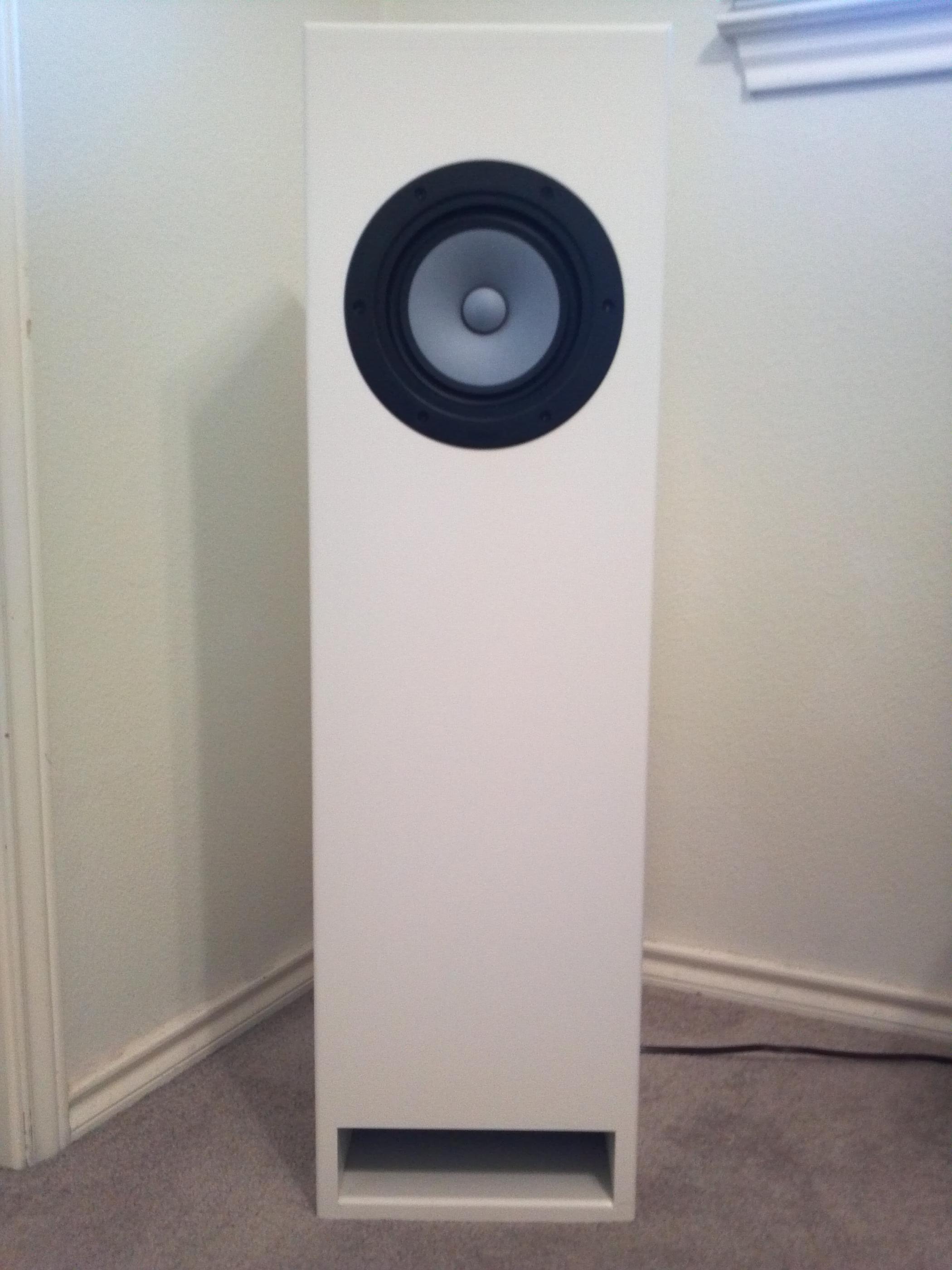

Well fellas, I finally got them together and am absolutely loving them. I don't have any stuffing in them yet (supplier was closed today) but plan to add some within the next day or two.
As for previous comments about my window bracing effecting bass response, I can say that what I'm hearing is a lush and yet very well controlled low end. Definitely not lacking in my current room and just about perfect for my listening habits.
I will be honest and say this, I'm in my 1st hour of break-in and I have listened at above break-in levels for just a few moments, though never exceeding 1mm of xmax(so perhaps not above break-in levels??). The results were simply wonderful and are a sure indicator that in time I will be rewarded with even more beautiful sound and an even more lush and natural bottom end.
As for my cutout chamfer, I went to Lowe's today and grabbed a rasp as recommended by Zia. A few minutes of grinding and I was satisfied with an eyeballed 45* chamfer on the cutout. After that it was smooth sailing and a lot of fun.
I can't comment on the driver bracing as has been discussed previous to this post, but I personally have never used it. Also, I feel I torqued down on the drivers quite a bit and haven't had the bad experiences with coil rub or any distortion as I had with my Alpair 7.3's a while back in another build thread.
Overall, fantastic driver, Mark. My current setup for these drivers includes an Emotiva ERC-2 transport, Electra-Print PVA passive preamp, and an ICEPower 125ASX2 power amp. So far this combination of gear has been adequate but I believe the amplifier can be improved upon and will be in due time. Thanks Mark for producing such a wonderful driver, and thanks to Planet 10 and Scott for an awesome enclosure.
Steven
