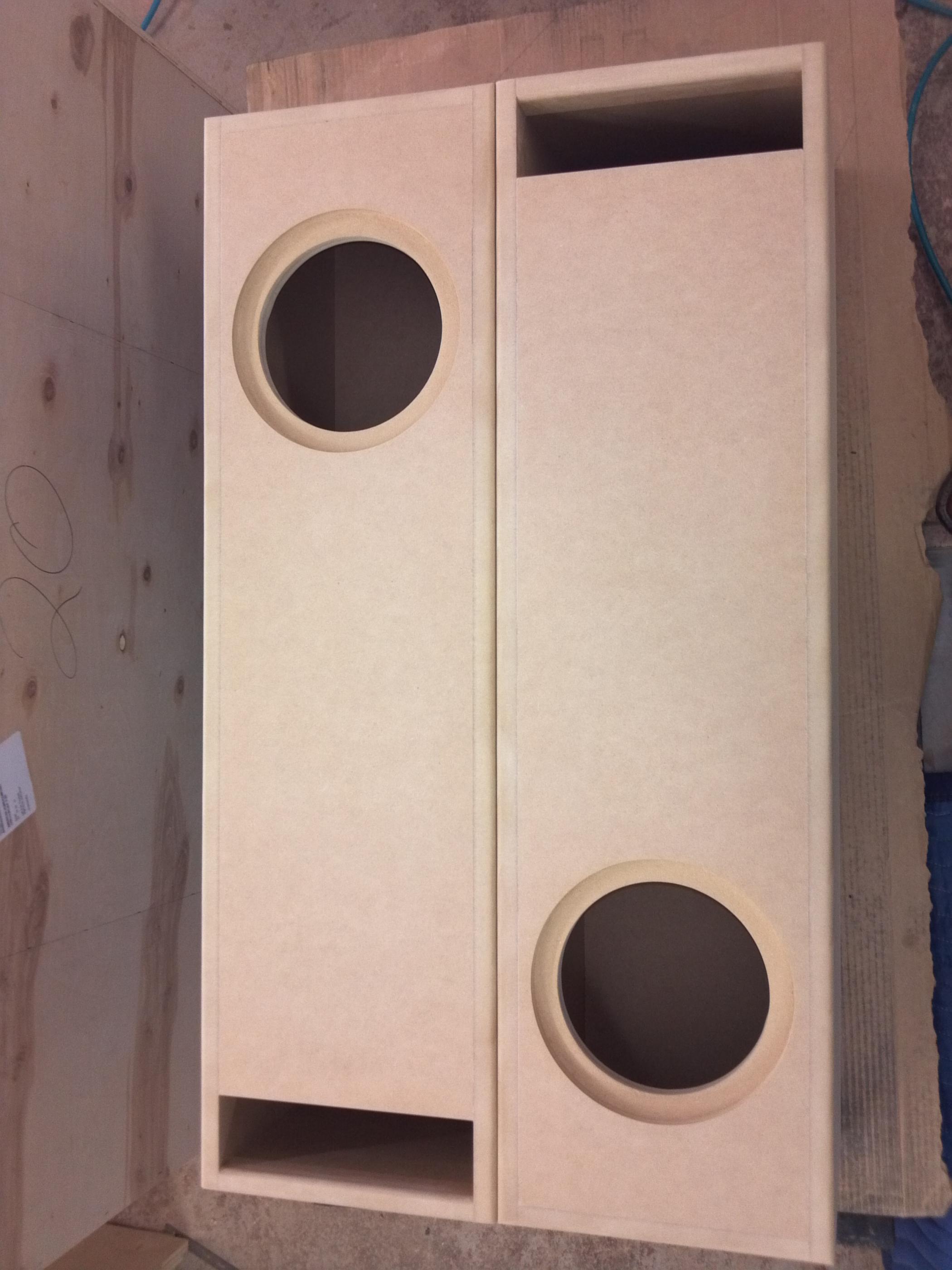

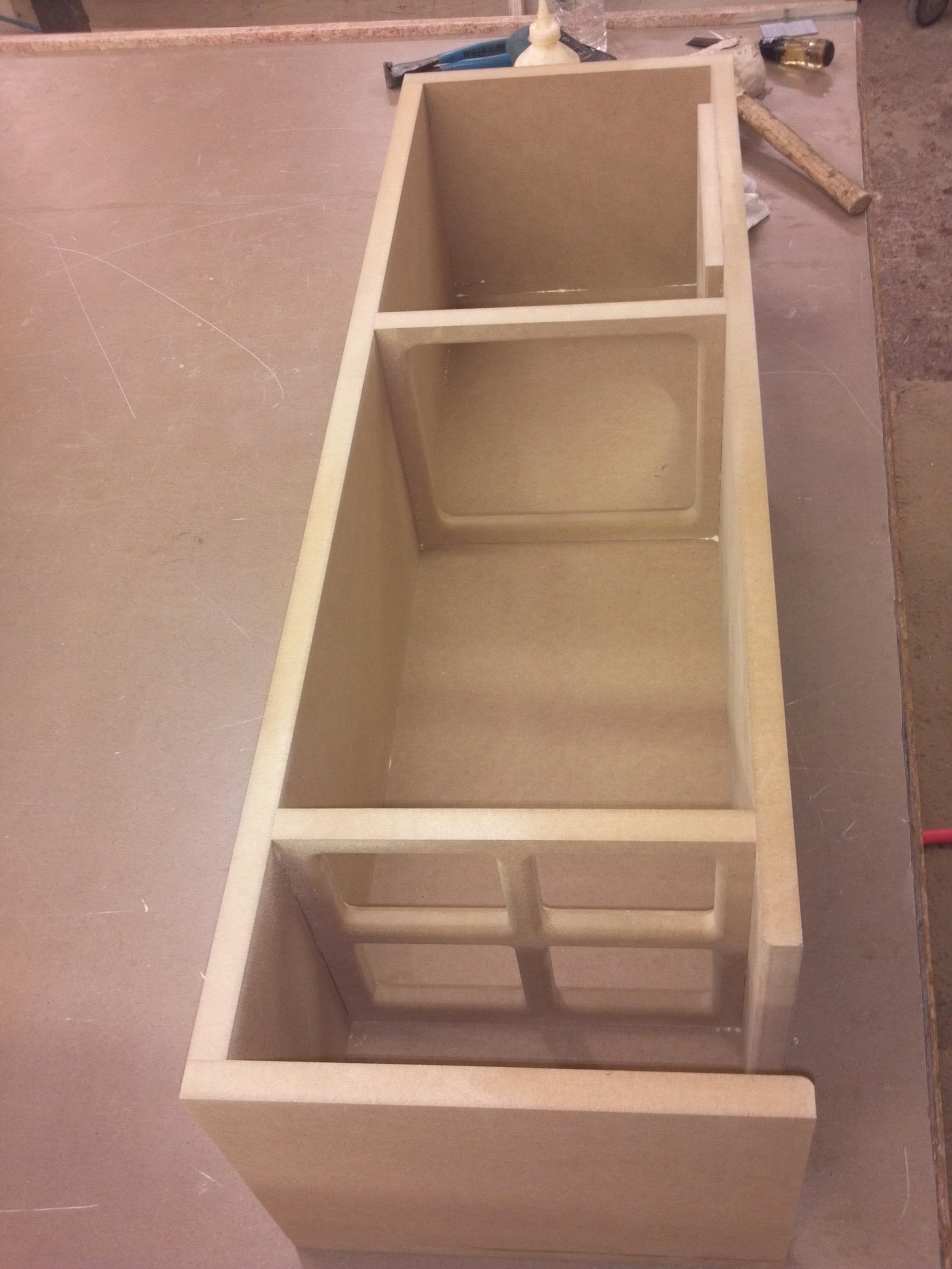

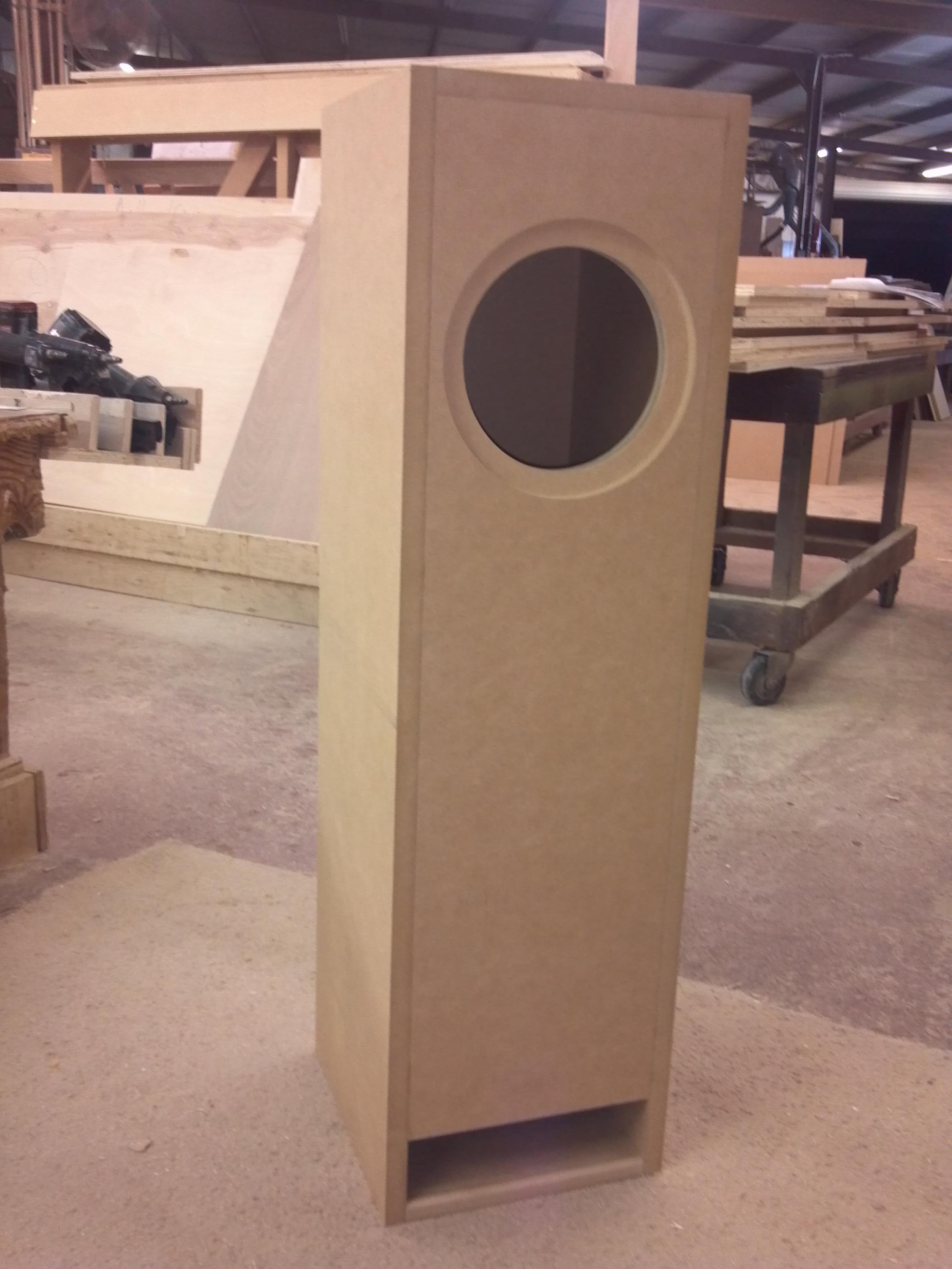

Well, I had a little time this morning to throw the enclosures together. Here are a few photos of the build. As you can see I opted for MDF, and a non-standard bracing. As of right now they are waiting in the finish room and have a couple coats of sealer already thrown on. Monday they will get an off-white paint sprayed onto them and should be fully mounted by Wednesday. I rounded over the front edges to give it a "softer" look and reduce diffraction.

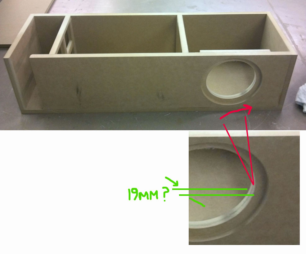

Also, as you guys can see I added more material to the inside of the cutout. I added 1/2" more which gives 3/4" material to screw to. I did a small round-over on the inside edge of the cut-out but I don't think it's adequate as I believe that the driver will need more room to breathe. Soo.. with the enclosures already sealed up I'll just take a small sanding wheel and chamfer the inside edge a bit. Shouldn't be a problem, just a little time consuming.
Anyways, I'm excited that I've made progress on the enclosures and can't wait to listen to them next week. Hope you guys enjoy!

Zia, I didn't use a removable back. For a cabinet this small I don't mind pulling the driver out a time or two to adjust stuffing. It's just a personal preference of mine
Great - so now sir on towards completion of the build and subsequent listening impressions!
BTW, you might consider some lining on the inside of the top of the cabinet and both sides of the driver.
...and a non-standard bracing
The issue with bracing that is perpendicular to the vertical sides is that it willperturb the 1/4 wl standing wave that makes a TL work.

Hi Steven,
Great looking build and very nice work. Noting the side wall (front baffle) mounting thickness of 19-mm (3/4"), theres a higher risk of reflection onto the cone rear. Try to chamfer as much as possible. Maybe you could experiment with some off-cuts first to see much you can chamfer out.

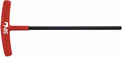

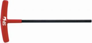

The drivers don't need heavy tightening down. If your using our M4 screws, use a 3.9-mm or 4-mm to mark the hole centres by offering up the driver into the recess, then drill pilot holes to take the screw body. I'm not if the office so can't give you exact screws body dimensions. From my memory, a pilot hole of 2.4-mm is about right but check it.
install the screws without the driver, the threads being made, remove the screws, then install the driver. That way you'll accurately feel the screws getting tight as the driver's fully pulled into the recess. Only a gentle tightening is required. Don't go nuts with a torque screw-driver, do it by hand (see T handle screw-driver pic), you'll feel the tightness allot better this way.
