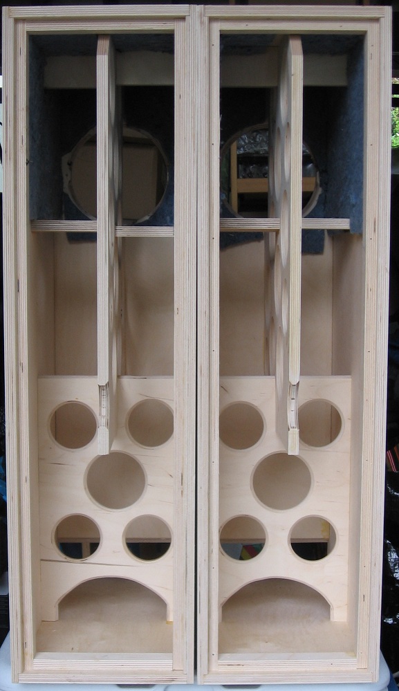

The issue with bracing that is perpendicular to the vertical sides is that it willperturb the 1/4 wl standing wave that makes a TL work.
dave
Dave are you saying that my bracing will hurt the performance of the Pensil more than it's helping?

Thanks for the mounting tips Mark! Also, I plan to take a good portion of the material away by chamfering the cutout with a rasp like zia mentioned. I appreciate the tips and feedback y'all.
Steven
I don't know about that, but it will have some effect on the quantity of bass.
dave
dave
In my experience, no. I have used as many as three window braces down the length of a pipe win no measurable effect. I do have issues with Steven's bracing scheme. There are not nearly enough braces to support the large panels, particularly in MDF. The top brace should have been the window brace. As thin as it is in MDF, it is doing not much more that squaring the box. I am using braces with circular holes that are at least 1" thick at the thinnest part in plywood. The bottom brace is too far down the cabinet to support the sides, but again it does square the box and that is a good thing.
At this point in construction, what I would do is cut for pieces of at least 3/4"x2" the length being the distance between the two existing braces. Ripping a 1x4 board would work, or cut them from 3/4" plywood. Glue them to all four sides, offset from the center by ~1".
Bob
Thanks for the input Bob. The reasoning behind the bracing being like it is, is to only hold the cabinet square, as well as hold the polyfil in. That's why the bottom is a window, and the top isn't. Also, my original planning for this build was to add mass to the sides and front via decorative hardwood panels attached to the outsides. Perhaps if I hear any excessive panel resonance or ill performance I'll pursue this design again.
Another reason for placement of the bottom window bracing is if I remember correctly at one time Scottmoose said that bracing near the terminus of the enclosure is most critical. I'll post my listening impressions later on this week when the boxes get finished up. Again, I appreciate all the input, guys. This is all a constant learning process for me and I'm very appreciative of everyone's ideas and suggestions.

I wouldn't necessarily say 'most critical'; depends on the design. If you've got a box with a relatively large vent, as in this case, it certainly doesn't go amiss.
Since you need 1 1/8 - 1 1/4in of MDF to ~equal the stiffness of 3/4in birch ply, depending on grade etc., you may want to consider laminating another 1/2in to the side panels.
I knew you were coming Bob
The other thing that we run into is that, at least for the "push resonances up so high they don't get excited school of boxes", they are not as effective, given that they break the rule: A brace should divide a panel such that the aspect ratio of the subpanels is greater than the aspect ratio of the panelbeing braced.

Having built both the Pensil7 and SuperPensil12P, and similar designs for other drivers, I'd offer some observations :
- The SuperP is quite deep enough that if you run vertical front to back brace as shown in Jeff's posted photos, you could cut the corners of the brace panel at 45` to clear the cleating and it will still have enough contact area to provide the structural bracing and ensure squareness of the adjoining panels
- Yes, this is the most time consuming part to fit tightly - you need to ensure that the driver is installed in the front baffle and tightened just enough to compress the gasket for sealing (approx .5mm by Mark's figures, which I was too lazy to confirm ) , but not too tight to twist the frame - before marking and dry fitting the notched cut-out for magnet. If anything, err on a slight gap between magnet and brace, and use a piece of the weatherstip foam, or bead of duct seal putty.
- By the time you're satisfied with the wadding fill levels (i.e. after the several hundred hours for the suspension to fully loosen up) you may have had the back off several times - which can get a bit tiresome. Unless you want a furniture grade finish on the back, I'd be inclined to just use the gasket tape and screws .

I trust with that thick a baffle you've provide lots of chamfer or radiused relief to the rear side of cut-out - a hole lot easier before assembly than afterwards.
And as the sides on the SP are much larger panels than the front/back, I think lateral bracing of / between those 2 is also very important. The total scheme needn't be as elaborate as this, but I can assure you that these enclosures are fairly stiff.
....I might just try listening to one box with the braces and the 2nd without to check if I can tell the difference as Bob has suggested....
Not with/without braces. That will make an obvious difference. With/without bracing the back of the driver. Do this: Build both boxes identical. You need a stereo pair anyway. In one box, shim the brace so that it applies pressure to the back of the driver. Leave the shim out on the other. Report back.

Hi Bob, Guys,
I didn't design the driver frames to take a pressure load on the rear of the unit. If this installation rout is used, CARE MUST BE TAKEN TO APPLY ONLY A MARGINAL TOUCH PRESSURE . Apply just enough shimming to make a light interference fit. Better still, use a strip of high density foam (or similar) material between the rear of the driver and the brace. Its got some give in it that should provide the desired attachment while dissipating the stress load.
Those members who are experienced and familiar with Markaudio drivers know how to carefully apply this bracing method. Its important to help those newer members with less experience gain more detail when suggesting installation methods that are outside the driver's design specification.
