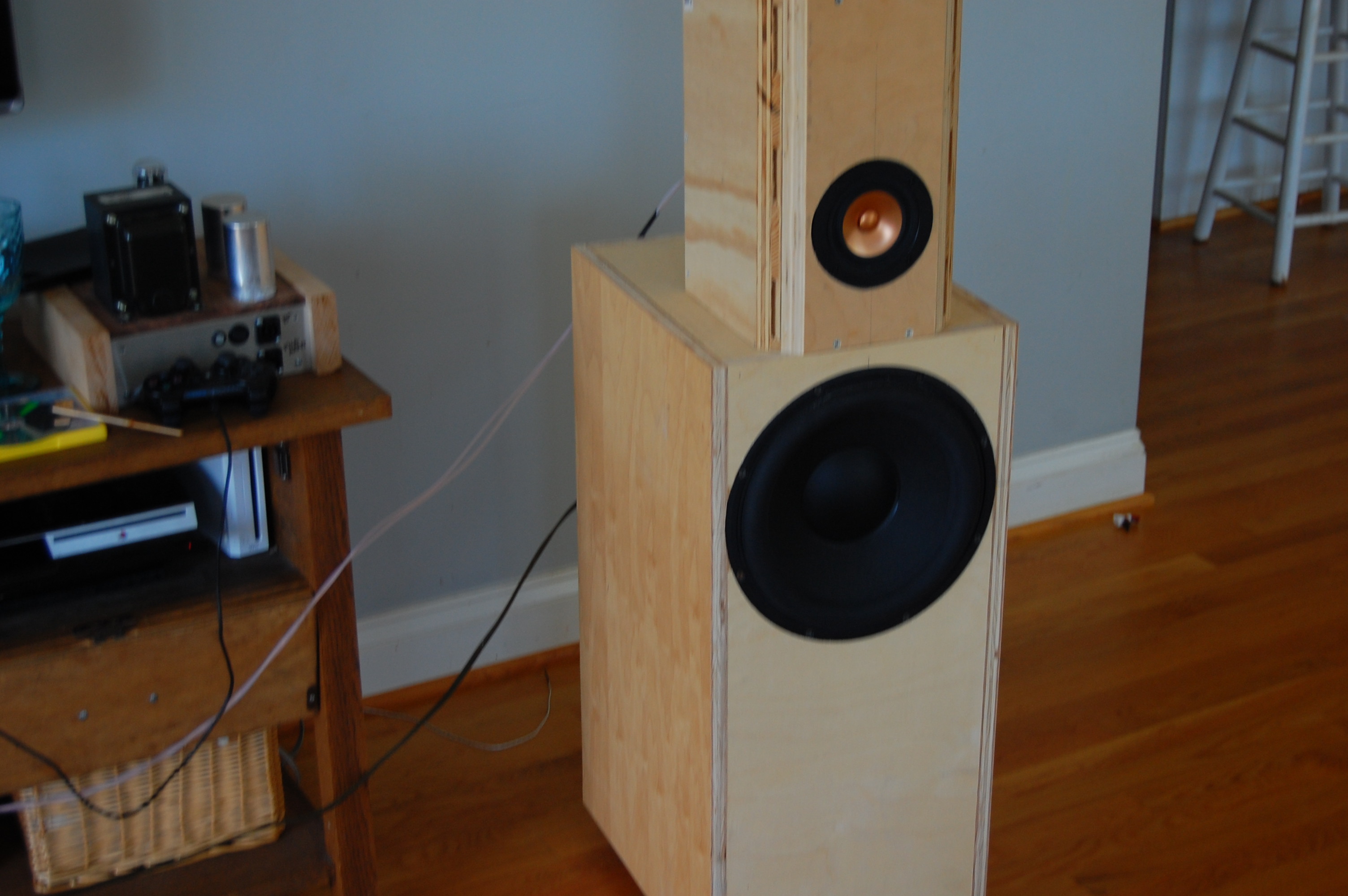

Zia, they are in some hack job cabinets I built about a year or so ago. Here's the finished product. http://www.diyaudio.com/forums/mark...air-10-2-pensil-build-log-12.html#post2587826
Steve,
That build was cool...lovely finish. So you're an old hand at Pensil building!
Interesting to hear that A12P in the Pensil can surpass the A10.2 in bass output. Have read plenty of positive comments on the A10.2's LF capability. If imaging and resolution is close to Alp 7.3, these speaker must be very enjoyable.

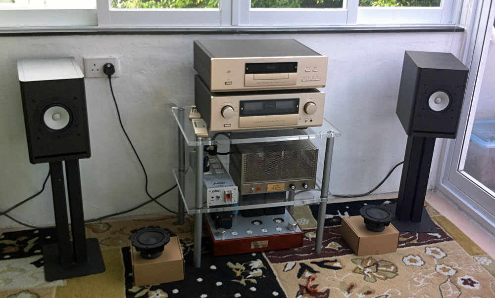

Hi Chris, (Guys),
We used 7's in our living rooms (old and new place) since the Gen.1's. Technically, the 7 (current version) on paper might rate as my best driver, especially for those folks who look for extended bandwidth (with good reason in the case of the 7). Me personally, I love the 7, especially in a set up and room environment that optimises its characteristics.
Interestingly, Bernd Timmermanns of Hobby Hi-Fi magazine (Germany) in his recent reviews of the latest 7 and CHR, preferred the CHR. He criticised the 7's step up in frequency at around 9kHz, saying the CHR's more gradual output increase that peaks at around 18kHz was better. Given that Bernd is a professional reviewer and owner of Hobby Hi-Fi, I was surprised that he made a significant error in his assessment of the 7 by not demonstrating an understanding of bandwidth and compression. In any full-range driver (especially smaller units) designed for single point source point applications, one of the designer's challenges is to deal with emittance compression over cone's surface. The reason why many of us "love" the 7, is its delivery of ultra wide bandwidth at lower compression rates emitted from its cone substrate surface. That's why it sounds so detailed and balanced while remaining relatively neutral. I re-engineered the latest CHR to be "brighter" in the upper mids to highs as requested by feedback over recent times. Compression is still under decent control but its design emphasis is to cope with more general audio needs and have excellent off-axis performance. These 2 drivers are different design animals, designed to serve different audio groups. The 7 is very much for the "high-end" enthousiast and/or experienced Diyer. The CHR more for wider audio applications, OEM and beginners/less experienced or those wanting to get good audio output on a budget. The price points between these drivers is an illustration of the technical and performance differences.
Scott's Pensil designs have extracted some of the most pleasing performance I've ever heard from single point-source drivers run full range without other drivers being used and with no compensation of any kind. For those who'd like to take another look at my current living room set-up:
http://www.diyaudio.com/forums/markaudio/216073-marks-new-home-set-up.html
However, my studio in Chia Wan is a larger space where the Alp10's and 12P's clearly excel. Demonstrating Alp6's and 7's in a room size bigger than 4X5 metres starts to show the limitations of small drivers, especially in smaller boxes. In larger room situations, cone acreage counts. The 10 has always remained faithful to its main criteria of being a "neutral" driver. Its rectangle wire wound coil won the end-user vote during its final pre-production phase (see various posts somewhere on the forum), thus the 10 Gen.2 came to exist. We could say that the 10 is very much a "people's driver" (excuse the term), as members of this forum steered its development. Under load, it has a very low output/compression ratio inside the telephonic range. It output in this range is very stable.
The 10 MAOP is a another step in the development in my sights to further stabilse emittance from a cone substrate. So far, the end-user vote (credit cards, cheque books etc) says MAOP is a step in the right direction, as 54 pairs are being produced this month. But will it suit everyone's taste, No it won't. Me personally, I'm enjoying the MAOP 10's in Erich's box design (as per previous post) - see pic. For me, detail/clarity is just about as good as it gets. The bass response is tight and detailed, not over-powering. This set up takes all my older CD's with no dramas, taming some most of so-so recordings. The eagle eyed amongst you might spot the drivers on the floor - more about these later.
Meanwhile, the 12P, another driver where its design was steered very much be this forum is doing well. From my engineering perspective (Mech Eng.), this is my favourite driver. Technically it shouldn't work. Matsuabara san (father designer of the Fe range) and me struggled for allot of hours to get the semi-free to air single mechanical suspension design to become stable under load. Why did we produce a driver with only one mechanical suspension? - simply because many members tasked me to make the 12 efficient and extend the usable bandwidth while staying with the single cone design. The mass of a larger cone usually limits high range emittance, so the design of the front suspension is critical in the extended bandwidth equation. The 12 and 12P work due in part to the re-distribution and change in compliance load bearing factors acting on the front suspension. Me personally, I really like this driver best on orchestral works. The cone does wonders for strings and percussion when mated with a nice valve (tube) amp. I've written about my impressions in other posts. Demand for this driver is much greater than the Gen. 1 unit so I guess we're heading in the right direction.
Hopefully, this post goes a little further along the way into explaining what's been done to date and encourages members to comment in detail, as I'm keen to get ready for further development work in the new year. At the end of the day guys, your the folks that live with these drivers.
Cheers
Mark.
