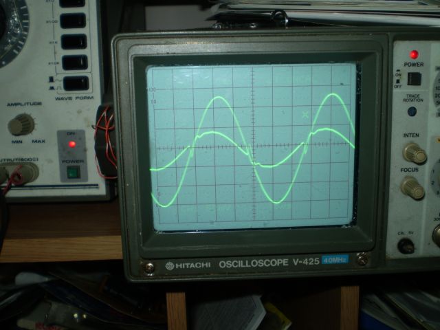

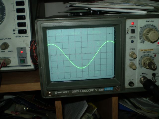

Here's what i have found :

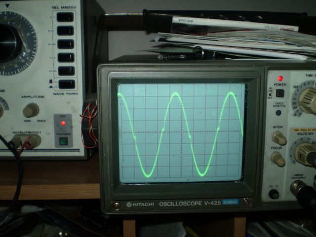

I have discovered that the pulse was infact caused by crossover distortion.
More so in one channel than the other and I had never noticed it before,mostly because I was working at lower frequency's.
I may have caused this or it might have just always been that way,as i have put this thing through H%$# and never expected it to hold up as well as it has.
It still works and some day i'll be nice to it and fix it.
But for the time being we must keep push'in on.

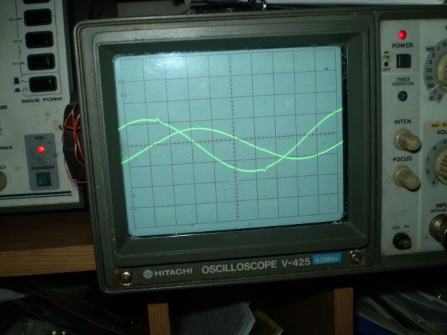

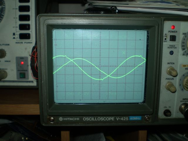

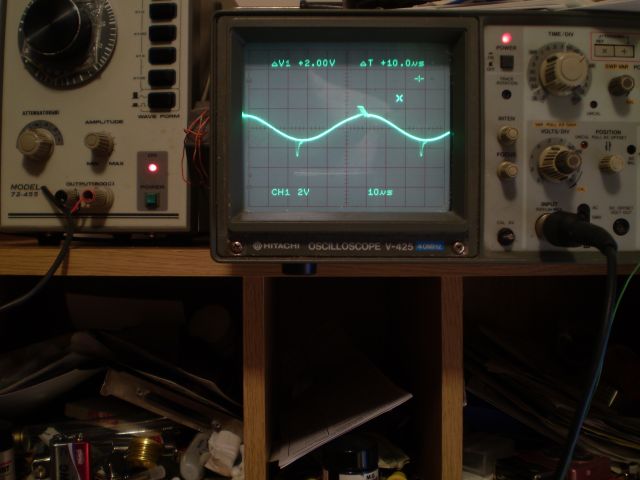

Anyway that little pulse that was lurking was the death of some resistors. Why? rf?
When I did do some impedence measurements I found that connecting the two 120v windings in series must have added alot of capacitance and was severly draging down the amp above 10khz to 20 khz causing a resonance around 25khz.
I also tried to connect all of the winding together (on a single core)as this would up my ratio quite a bit, but this lowered the frequency as well and started to create havoc at around 4khz to 7khz.This was not good.
This does not happen with only a single 120v winding as the pulse shows up and peaks at around 40khz to 50 khz.(This was with quad stack cores and is them same for a single and dual stack.)
So then then thought ,well okay,I can combat this with a 5 turn primary in stead of a 10 turn one.
well,it worked and still got full power down to about 180hz or so (on the quadstacked
), my goal anyway.
However,all of the transformers were not the same and mismatched.with a 1volt in I got 41,44,36,30 out. So the best I could get was 77 and 74.

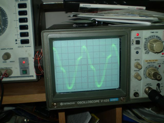

I found two that were exactly the same and double stacked them.this time I put some 1/16" plexiglass spacers in between them to cut down any capacitive coupling between the cores.
Wrapped them with two 5 turn windings of speaker wire and proceded to start testing.

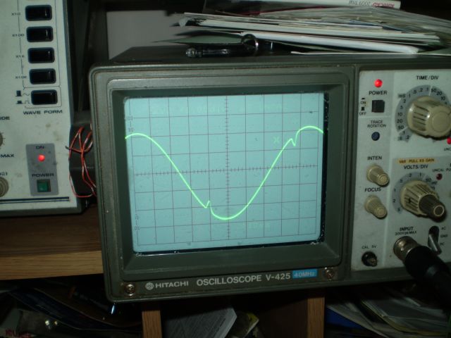

As I brought the voltage up I was getting 700v out of one winding and got fullpower around 300hz to 400hz which was excepcted.
And thats when it all started!
I heard the familar hiss and maybe pop or somthing inside the cores the amp shut down.
I then pulled back some tape so I could see inside on both sides .it happend a few times but didn't see any thing
with 2800v go'in on in there I decide two seprate the two.
So I did and started testing some more and also found that the were now mismatched.

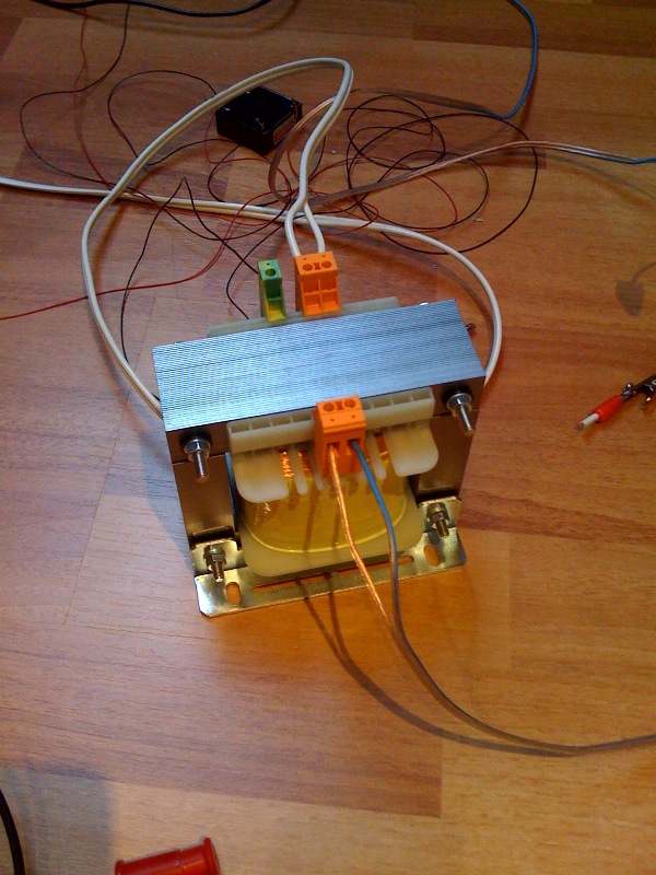

I have made a new transformer based on EI120 core laminations; 40:5000 in ratio (1:125).
The transformer is single stacked, and wound with one wire instead of 2 as I have tried before. I have only 1 primary on this transformer - and a layer of insulation between the secondaries at every 500 turns.
The little black plastic cube behind the trafo is te EMCO voltage converter that gives 5000dcV at 12dcV input
I have not done any measures beside checking for shorts and that the dc resistance is equal on both sides of the center tap.
I just hooked it up to the speaker, and it plays very nice, and very loud. Output voltage is...enough to crack my multimeter.
A new problem has appeared; there is quite a bit of arching at the perimeter of the spacer frames even at low bias voltage (2500V)
So; it's time to dig the car out of the snow and go shopping!
I have not figured out whats wrong with the "monsterformer" yet, I will have to play with that during easter holidays.
Regards
Bent

Here are some pics I ment to post earlier when things went haywire

Thanks Steve,as it is all becoming very clear to me now.
Do remember reading that(post #173) and have a copy of Baxandals papers some were in my archives.
Having the bias set close to the edge would result in breakdown on some single tone test.
So then i would just back it down slightly until it went away.
That puts alot of light on the subject.
The 1:480 ratio was a straight foward asumption calculation.
I was getting ready to start reading up on magnetic circuits again and figured this being the case of why I was only able to calculate a 1:130 ratio on the quad stack.
I think that in all of my different combination test it was the 1:120 ratio in both single, double stack and dual single stack that gave me the best results in dynamic range except for low frequency handling which was understood due to core size.
This is when I realized that my amp isn't going to cut it in the final configuration although it allows me to just listen to them.
I had the same problem 7 years ago when I first powered them up using using some 6v6 pp output transformers and this same amp.
And if I remember correctley,when I took them back to florida to my friends place were we had the studio,I hooked them up to an alesis RA100 amplifier and it was the best I had ever heard them sound at that time ,even with the crappy transformers!
So,with that being said these transformers made a big big world of difference.
I don't have any decent amps running at the moment as two are still in florida powering the appogge dueta's ,one got stolen from my garage last summer and the other a bgw that has a bad channel and my two sunn concert slave amp need a go'in over also.
I guess I've got some repairing to do!
Or I have five lm4780's laying around doing nothing but sitting on my bench.
I thinking 4 opamps in a parallel or bpa configuration just might due the trick and get me by for now until I get my bigger panels and transformers made.
Anyway, How does this all figure into the variable transformation ratio of 1:130 to 1:160 I was measuring at one frequency by varying the voltage level only?
As always yours and everone elses thoughts and opinions are welcome.
jer

Also,I forgot to mention,This must be the reason why I would get that nasty little pulse a above 20volts peak. jer
jer

I'm not sure the cause of your turns ratio discrepancies without more information.
1) What frequency were you doing the measurements? To avoid contaminating your measurements with the resonant interaction of leakage inductance and winding capacitance I'd recommend using a low frequency of 100 to 500 Hz. If you use a frequency near the resonant frequency mentioned above and are not using a series damping resistor you can measure an "effective" turns ratio of 2 to 3 times that at low frequencies. This is the cause of the SPL peak seen at the top end of the audio band on most ESLs. You need to choose a damping resistor to tailor the response to your liking. You will see increasing values of "effective" turns ratio as you approach the resonance. At the frequency of maximum peaking, you will measure the minimum impedance, and the maximum current drawn from your amplifier. Just below this frequency is where many amplifiers have stability issues as the impedance is still quite low, and the phase can be -60 deg or more.
2) Were you using a series resistor? If yes: Were you measuring the input voltage for the ratio calculation before or after the series resistor. You should measure after the resistor, directly across the primary winding.
3) Were you watching the waveform on the oscilloscope to make sure that distortion or clipping would not affect the voltage reading of your meter?

Yes I was using a sereis resistor of 10 ohms.
My setup up was as follows:
10 ohm resistor in series with 10 turn primary on the ground side.
Scope directly connected the output of the amplifier(input to the circuit) to make sure the input voltage was maintained contstant as the frequency was changed and to make sure I had a nondistorted sine wave.
One volt meter across the resistor and a second seperate voltmeter across the primary winding.
So, I could monitor all three at the same time.
I"m not sure if it was the quadstack or ,one single core as to get a baseline figure.
I'm thinking that both exibited the same effect.
so, I started to do a compleate set of measurements.
After realizing that I wrote one of the results in a wrong place,I back tracked to properly record the result.
While doing this discoverd that the two 120v windings were connected in series and disconneceted them.
This changed the results I had already recorded.
I then decided that I would make a new chart to included the second set of parameters,later.
So,with this problem still rolling around in my head.
I tuned to a frequency were the voltages across the winding and the resistor were equal and checked to see if the variable ratio effect still exsisted and it did.
Thats when I realized I had even more different sets of parameters to contend with.
So, I said to myself okay it is late I'm tired and I'll deal with that tommorrow as this would give me time to replan a new chart.
Meanwhile ,lets back track and check a few things.
It was at this piont the meters were not being very cooperative as the battery's were getting pretty low and needed to be changed out.
Just as I had this third one measuring the 120v winding it was acting squirrely and died just as I was turning up the voltage.
The pulse appeared on the scope and fried the meter.
The next day, I found some new battery's and it just got worse.
As I have already explained.
So now here I am meterless.
Somedays you just have to laugh!
Reguardless of the circumstance or circumstances.
Thats how that went.
I hope that I answered your questions,okay.
I can always duplicate some parts of the process but not the ones were the meters burned because they are already done!(ha ha ha, oh boy)
What I ment was I can still go back and duplicate a certain setup for some measurement in question. jer

Perhaps I don't understand the ratio that you are talking about. The setup you describe, measuring voltage across primary and series resistor, is a measurement setup for impedance not step-up ratio. You would need to measure the voltage at your series connected secondary windings to get step-up ratio.
1) Impedance does change with input voltage magnitude and frequency as I've mentioned before.
2) Impedance does change depending how you have your secondary windings connected as this is changing how the winding capacitance is loading the transformer.
3) Changing impedance will change the ratio of the voltages measured across the series resistor and the transformer primary.
