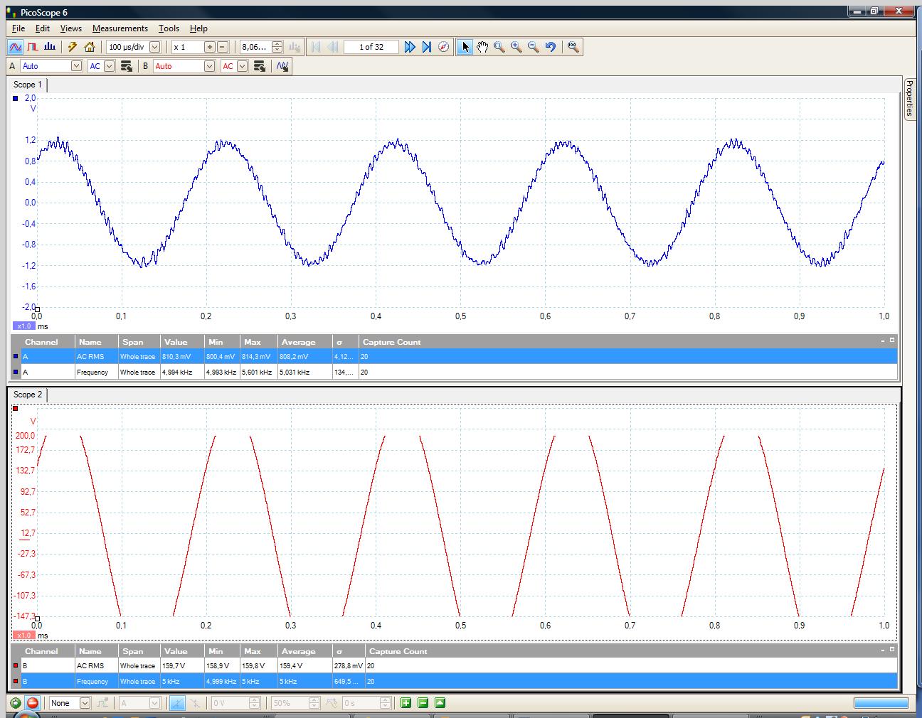

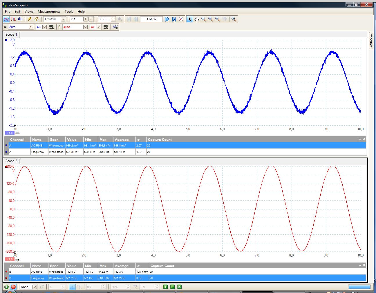

Some test results
Ah, got the kids to bed early and found some time to play with my transformers.
1. test; measured the step-up ratio by voltage; 1,0 volt at 500Hz in gives 14,80 volts out (true RMS meter) That is as expected given the turns ratio.
2. Test; use scope to investigate frequency handling. I have a PicoScope PC oscilloscope, 2 channels plus signal generator. I am not using the scopes signal generator as I am not sure why the signal changes when I monitor the signal and attach the transformer primary.
Measurements is performed with a 1/10 probe on channel B which is the secondary on the transformer. The scope has a limit of 20 volts, that is why some of the spikes is cut of at the top.
3. Test: Listen!
It plays allright, and loud. But I will test with a high-pass filter of some sort to filter out the frequencies the speaker cant handle. This transformer makes the speaker panel arch quite much.
I still have to crank the volume all the way up on my 50W tube amp - so it is not much efficient (but this is the first electrostat I have ever tried exept my Stax earphones)
Still; this is just a test - I suspect my "final" electrostats wil be made with plastic stators with a metalized and insulated inner coating. Drawings are finished but are waiting for some idle time the cnc router..

Hi Bent,
Congratulations on successfully winding a working transformer!
With 40 primary turns on a 40mm x 40mm core you should have not problem with core saturation with a 50Watt amp above 80Hz.
If I am understanding the Picoscope plots correctly , the first two plots show roughly 1Vrms input at 588 Hz and 5Khz. The output is larger in magnitude at 5kHz. This is most likely because you are near the resonance between the leakage inductance and capacitive load. You might lower the input magnitude to 0.2 Vrms and tabulate the output voltage for frequencies between 1kHz and 20kHz to get an idea exactly where this resonance is as it defines the upper response limit for the transformer. You can add a small resistor (1 to 2 ohm) in series with the primary winding to damp this resonance so it does not peak up so much.
Looking at the picture of your transformer from your post # 162
http://www.diyaudio.com/forums/planars-exotics/161485-step-up-transformer-design-17.html#post2136495
You probably have room on the bobbin to add some insulation(.2mm - .5mm thick) and then another 40 turn primary to put in parallel with the original primary. This will reduce the leakage inductance by almost 4 times. This in turn will push the resonance and upper response limit of the transformer up by a factor of 2.
Keep us posted on your progress.

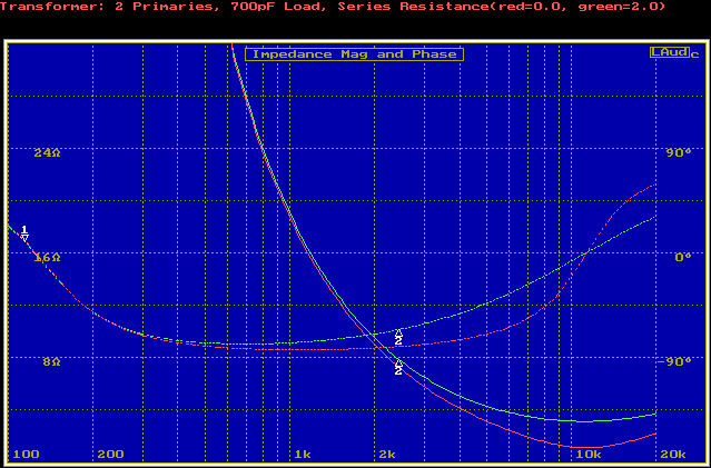

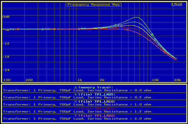

Here are a few measurements to give you a feel for what you might expect when measuring your transformer. This transformer was wound on a 32mm x 32mm core. Primaries are 50 turns each with 0.25mm of insulation between them and the 5000 turn secondary. Measurements were taken using a 10Mohm probe so as not to load down the secondary.
Plot 1:
Compares response using one or two primaries with and without a 700pF load
For one primary - resonant frequencies are 11.5kHz unloaded, and 7kHz loaded
For two primaries - resonant frequencies are 19kHz unloaded, and 11.4kHz loaded
So, adding the second primary increased the upper bandwidth limit by roughly 65%.
(Resonant frequencies were based on zero phase crossing of the impedance curve)
Plot2:
Shows how the loaded response for 1 primary changes when you add a damping resistor in series with the primary.
Plot3:
Shows how the loaded response for 2 primaries changes when you add a damping resistor in series with the primary.
Plot4:
Shows the loaded impedance for 2 primaries with and without a 2 ohm damping resistor.
Note the magnitude and phase of the impedance just below resonance for the curve without the damping resistor. At 6-7kHz the magnitude is only 2 ohm and the phase is roughly -60degrees. This is what causes stability problems for some amplifiers. Adding the damping resistor not only increased the impedance, it also makes the load more resistive with a phase angle of -35 degree or so.
