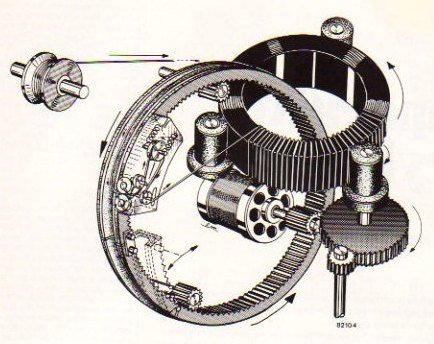

Toroid winding
This is how "the man" does it.

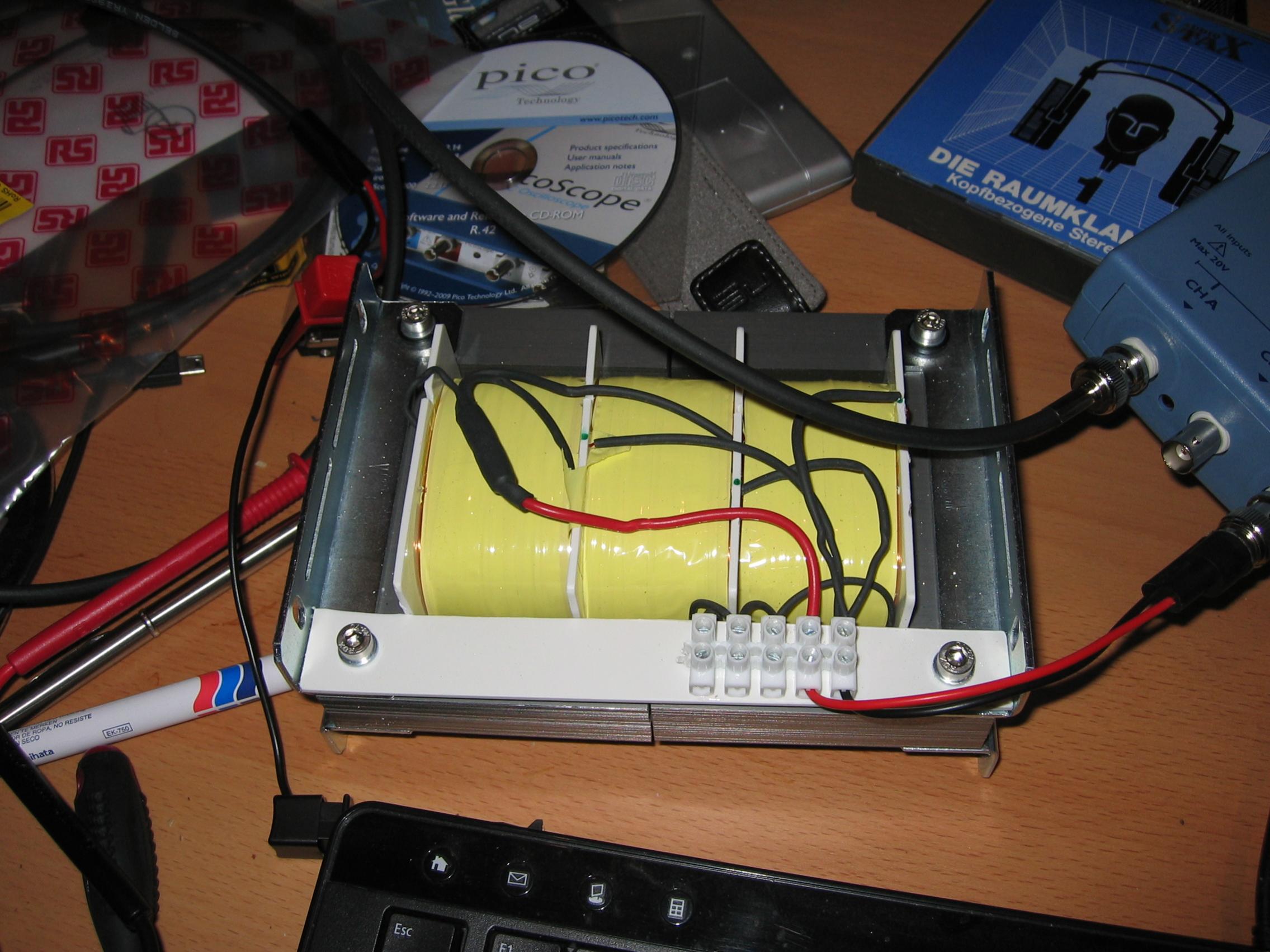

New double stacked transformer!
the first transformer is completed - almost..
Configuration:
Core: 20mm X 40mm X 116mm stacking height
Primaries: 45 turns X 3 in parallell
Secondaries: 2200 turns X 3 in series (winded with 2 wires in parallell to exactly locate the center)
State of operation: FAILURE!
For some reason it does not work, my first guess is that I have marked and swapped one of the primary or secondary windings.
(The picture is showing parts of the mess on my desk at the moment; the blue CD with "DIE RAUMKLANG" printed is a original STAX CD recorded with a artificial head. The box with BNC plugs is my PC oscilloscope with signal generator)

Two quick comments:
1) Very nice looking bobbin! and neat wiring & construction. You should be very proud of your work :)
2) Be sure to clamp the two halves of the E sections tightly together to minimize the airgap. Even small gaps in the magnetic circuit will lower the inductance and therefore the load impedance seen by the amplifier.
I usually test each primary separately to make sure each is working properly before hooking them up in parallel. It is also possible that you have some of the windings hooked together with opposite winding sense so that the voltages cancel.
Best of luck with your troubleshooting.

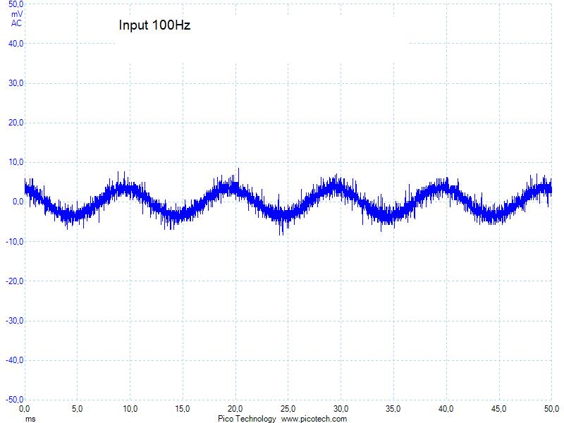

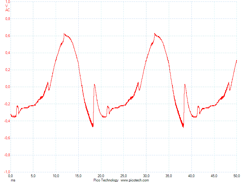

Found the problem with the transformer; poor connection in the screw terminals.¨
Getting some strange waveforms here. If I usen only one side of the center tap, output is fine, but using the full primary gives a strange looking waveform
Bent
