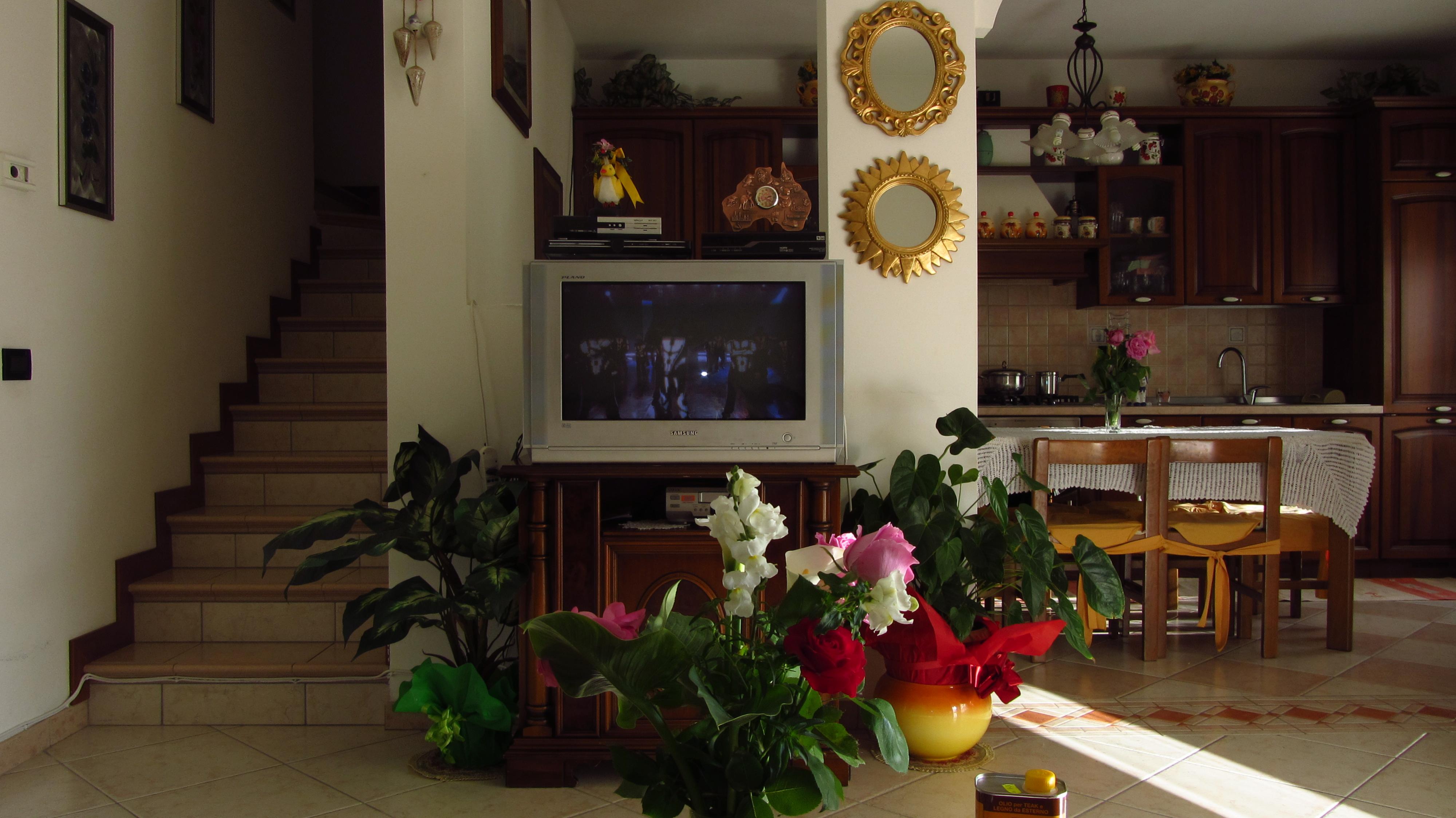

I just moved all fornitures trying to find a space where to fit two blh (I know they're not exactly horns..), and the only disposition I could find was this one(see photos).
The distance between the cabinets would be 1.70 m, and the listning point around 3m from the drivers.
Room is around 4x4 m (more or less..), but as you can see on the back there is the kitchen on one side and the stairs on the other.. Of course I'll put a big picture on the wall and something else here and there trying to avoid problems with naked walls, but since I just moved everithing and I'm going to build them maybe next year, I 'have quite a lot of time to think about what to do (actually I'm working around a pair of fonkens with the ff125wk).
Any suggestion?
I was thinking of the fe206en cabinet, becouse of the bass response and spl, but the cabinet is really big compared to the smaller one, and drivers shouts starting buy only 2khz... The fe126en in small in everithing, starting from the input power they can support, but with a better spl response, almost flat considering a 0+-3dbl from 150hz up to 16khz (where they 'die').

If that's what floats your boat musically, then it's a case of the bigger the better really. Big orchestral music needs dynamic range, and that's what the larger units provide.

FWIW, then I'd say if that's the sort of material you listen to, and the kind of presentation you want, then the bigger the better. All of the boxes are actually tuned to ~the same frequency; the real difference is that the larger enclosures give progressively greater efficiency & dynamic range.

Usually I listen to completaly different kind of music (italian singer-songwriters, quiet classical music, I love female voices like adele or a fine frenzy and son on..), but since with the fonkens I won't be able to fully appreciate orchestral music, I decided to build a pair of horns too, to use when I need something more.
I guess I'll have to choose between fe206en and fe166en all buy my self
