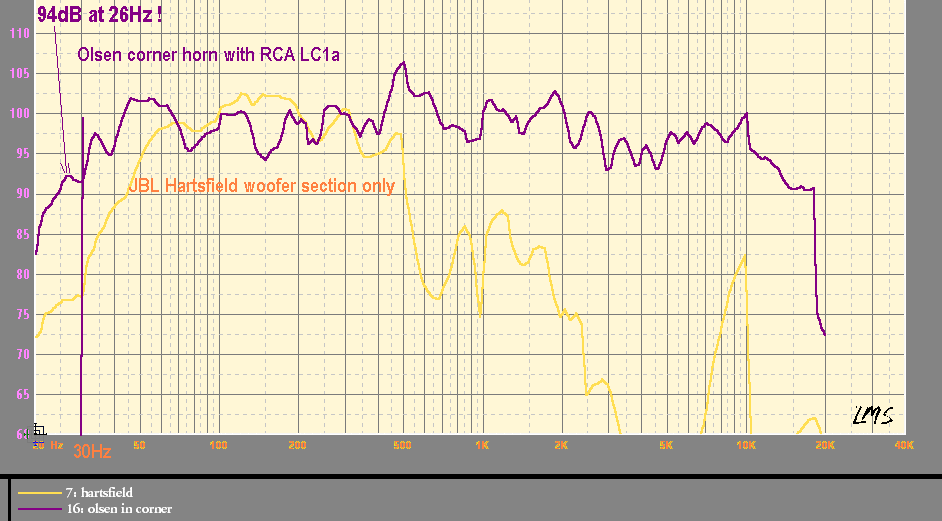

Mostly it just shows that Olson's original BLH concepts load the driver well enough to alter its specs somewhat. IOW design a horn with the desired in-room response and within reason a wide range of drivers will work acceptably well.
His original 15" 'full-range' corner horn studio monitor's response with loading to 30 Hz when recordings could only get down to a rolled off ~50-60 Hz:

Hi Greg,
That graph is pretty impressive for any era! I wish my speakers measured as well.
