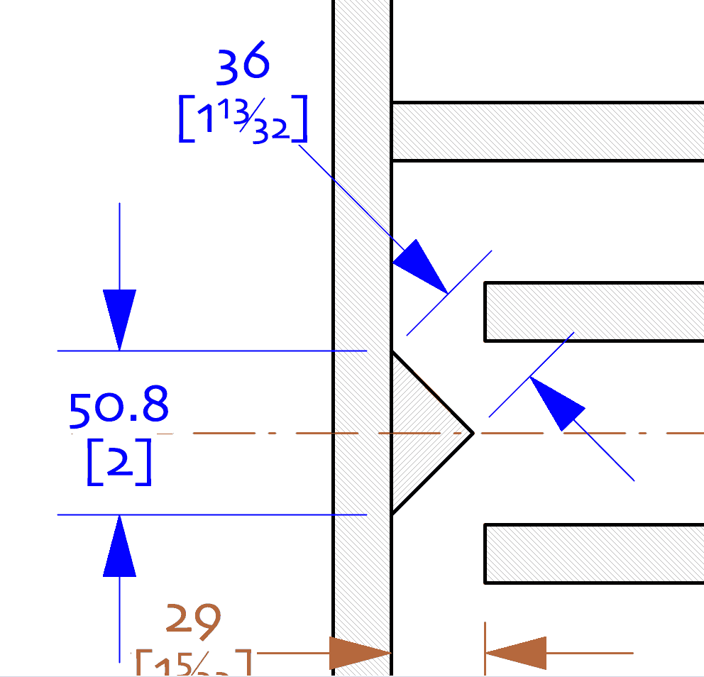

Dave,
I have started the build of the Kirishima 18mm version. The stepped deflectors are glued and ready together with some of the other parts.
What I cannot find are the dimensions of the triangled piece in the middle against the rear.
Can you help me out here?
Thanks,
Jock
Thanks,
Jock

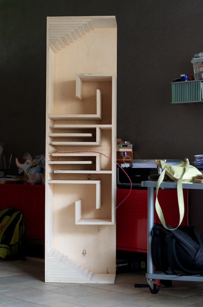

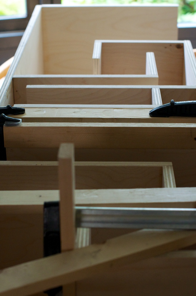

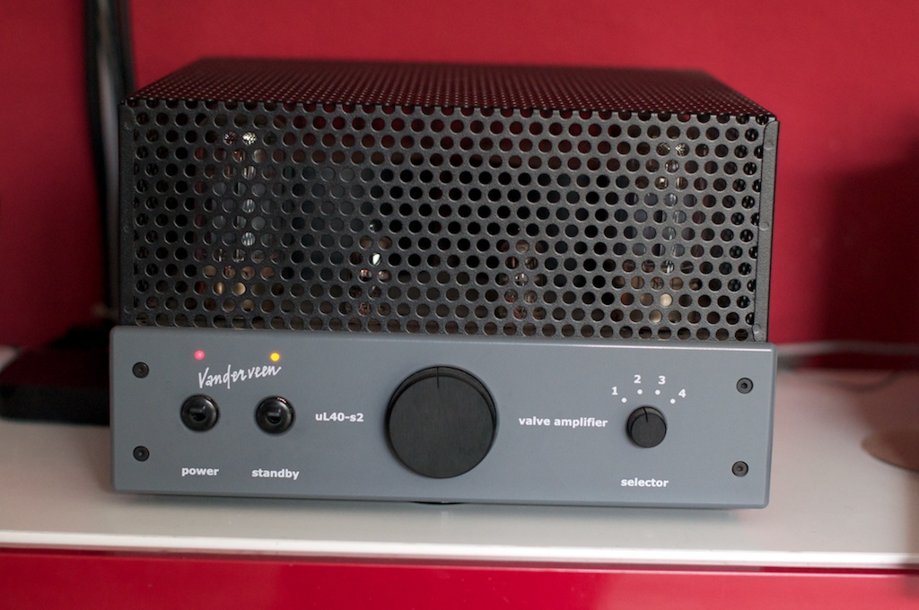

Hello,
I'm building a pair of Kirishima's. So far so good. I'm building them from poplar plywood as birch is really expensive here and these are my first diy speakers so I'm probably will make some mistakes the first time. The plywood has also less layers as quality birch plywood.
One speaker is almost finished and I've listened to it closed with clamps. The second is also ready for about 50%. As amplifier I have a self build Vanderveen UL40-S2 Tube amplifier ( in triode mode. It sound great, more open as my current speakers (old Kef q50)
Finish is yet unknown, that's for later after listening to them for a while ;-)
