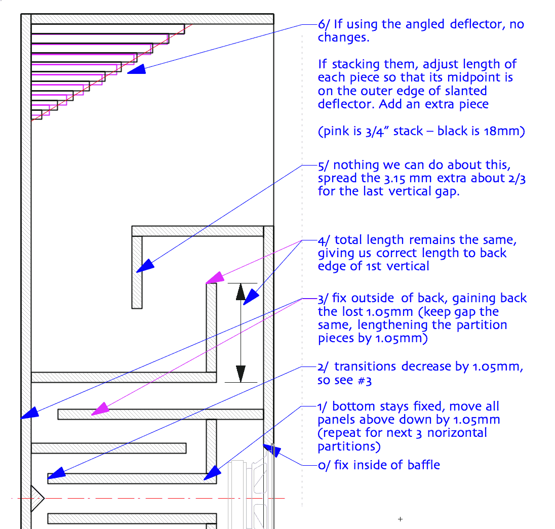

Just out of curiosity, how much would the change from 19mm down to 18mm in line length in enclosures like these?
If I were to re-draw for this material size change, I'd draw the cabinet on paper (1 half), drawing the centre lines of the folds, then draw 9mm either side of these to get the material width.
I've been trying to 'redraw' the Kirishima for 18mm wood trying to keep the sizes of the passages the same.
So far the changes from top to bottom (starting from the centre) seem to be relatively easy. Just keeping the distances the same while adding 18mm instead of 19mm.
But the changes back to front are giving me trouble.
Compensating the outer sides with minus 1 mm on both sides is my starting point. But then compensating for piece B takes another mm wile compensating for G an F takes 2 mm because of their overlap in order to get the passages from rear to G and than from G to F and then from F to the front pannel. So where do I compromise?
Or maybe I my approach is all wrong...
Other that that I assume that the stepped deflector also needs to be changed somehow.
Lastly, it seems to me there is a mistake on the overview drawing at the top where the top measures 17 3/4. Unless I am wrong this should be 18 (plus 3/4 for the rear) as it says on the last page.

At the same time you follow the instructions below, you can fold in change to unit mm (ie rationalize for metric).

Hi Dave,
Thanks for all the effort.
I am going to try to redraw this weekend. So far I am not fully understanding the entire proces partly a language thing (I hope ;)) so I am sure I'll be be back here with some additional questions.
As a starting point for me: You say in your reply " At the same time..." does that mean I do the changes as I described in my mail and than add yours or do I start with the original drawing and than follow only your instructions?
Jock

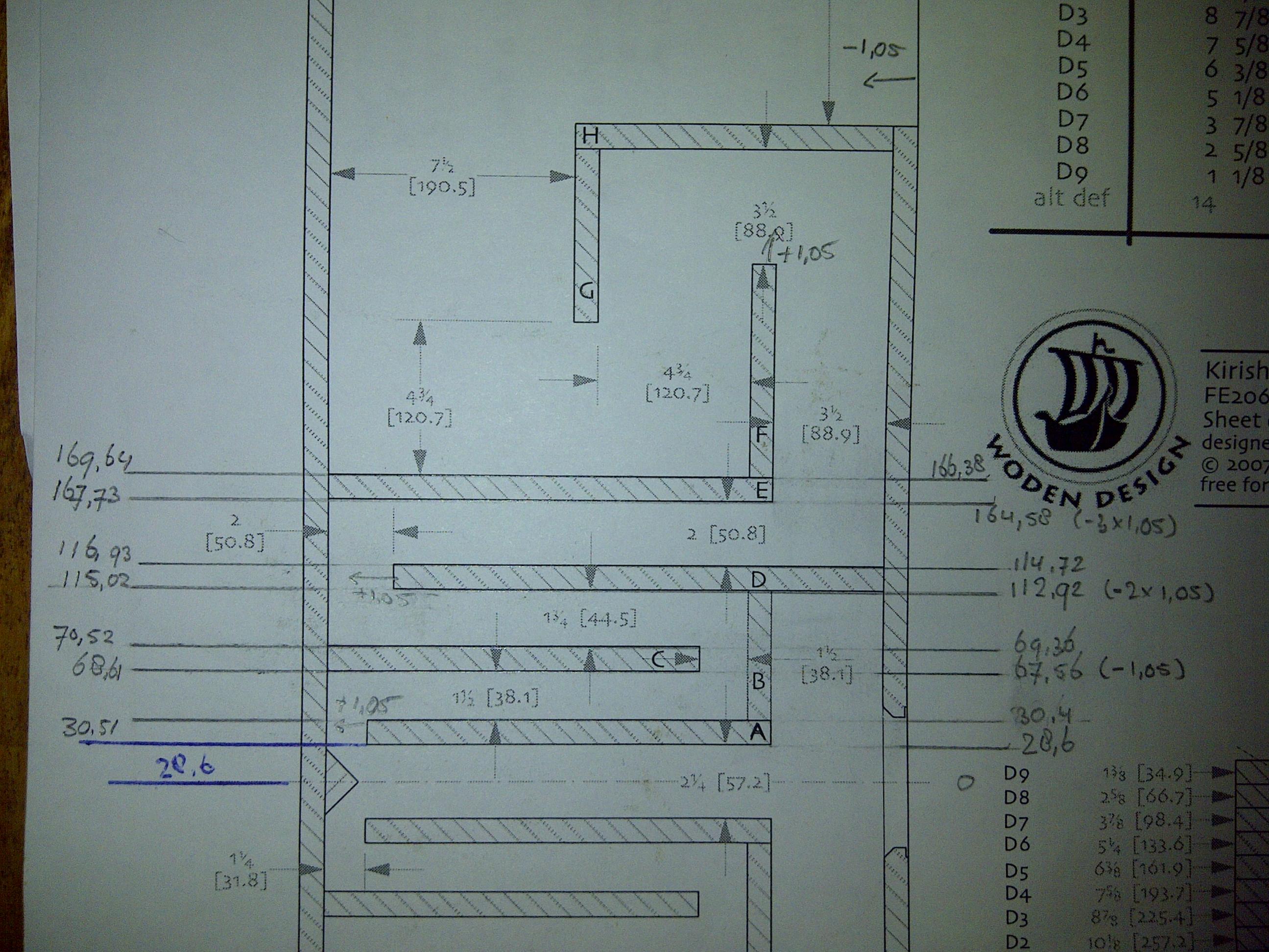

I am trying to do the math according to your instructions Dave and hopefully you can take a look at it.
All sizes are in mm measured from the center (0). The left is the original 19,1 mm the right is my attempt to convert to 18mm.
The 1x 1.05, 2x 1,05 3x 1,05 are there to illustrate the corrections made relative to the centre.
Two additional questions
-I do not understand instruction number 5, could you please explain this once more?
-Am I correct that panel B and C are not changed in the horizontal line?
Thanks,
Jock

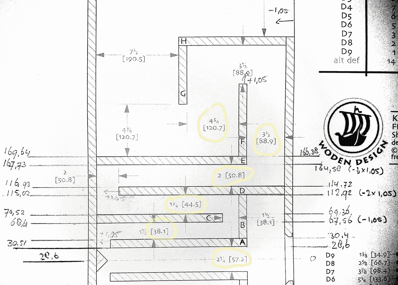

To be honest, i could redraw it faster from scratch than to check your addition, and i have too much on my plate right now to do that.
One thing i do note is that you haven't rationalized the dimensions to metric.
The dimensions circled in yellow should be rounded, ie 57.2 > 57, 38.1>38, 44.5>44, 50.8>51, 120.7>121, 190.5 to whatever is leftover (that is what i man by 5 -- if you find it is increasing too much, you can shift some of the extra to the next narrower passage (ie 120.7>122))
C will get longer, B will get shorter... again the details would fall out of me redrawing it.You need to thing about the space 1st, not the panels.
In the end all the dimensions should be unit mm (in the case of a space being a 1/2 mm (like the 1st bend), increase the space (ie 57/2=29)
dave
