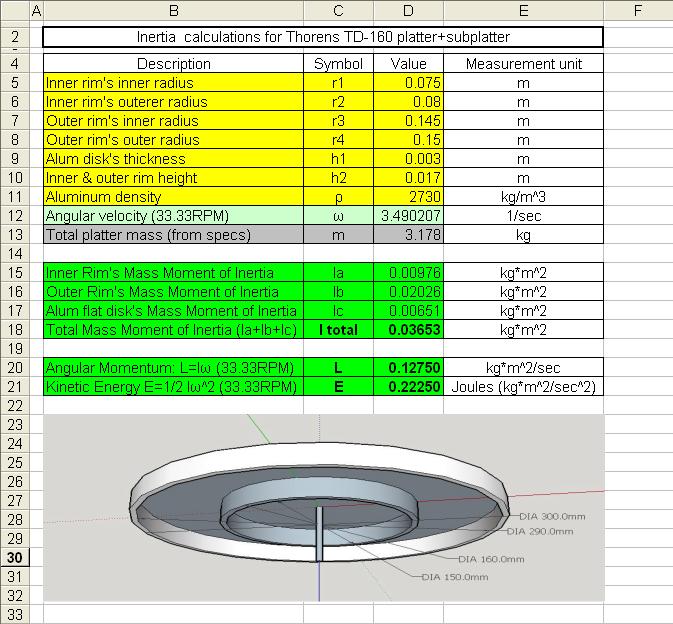

If you take the bearing friction and residuals as linear with the square of angular velocity, and you pick a platter weight, you can easily calculate the answer to your question.
“Take this brother, may serve you well…Number nine?!”
Hiten, such calculations are trivial for Jacco. But he is a special case.
I spent two hours for to get the numbers you see below: D

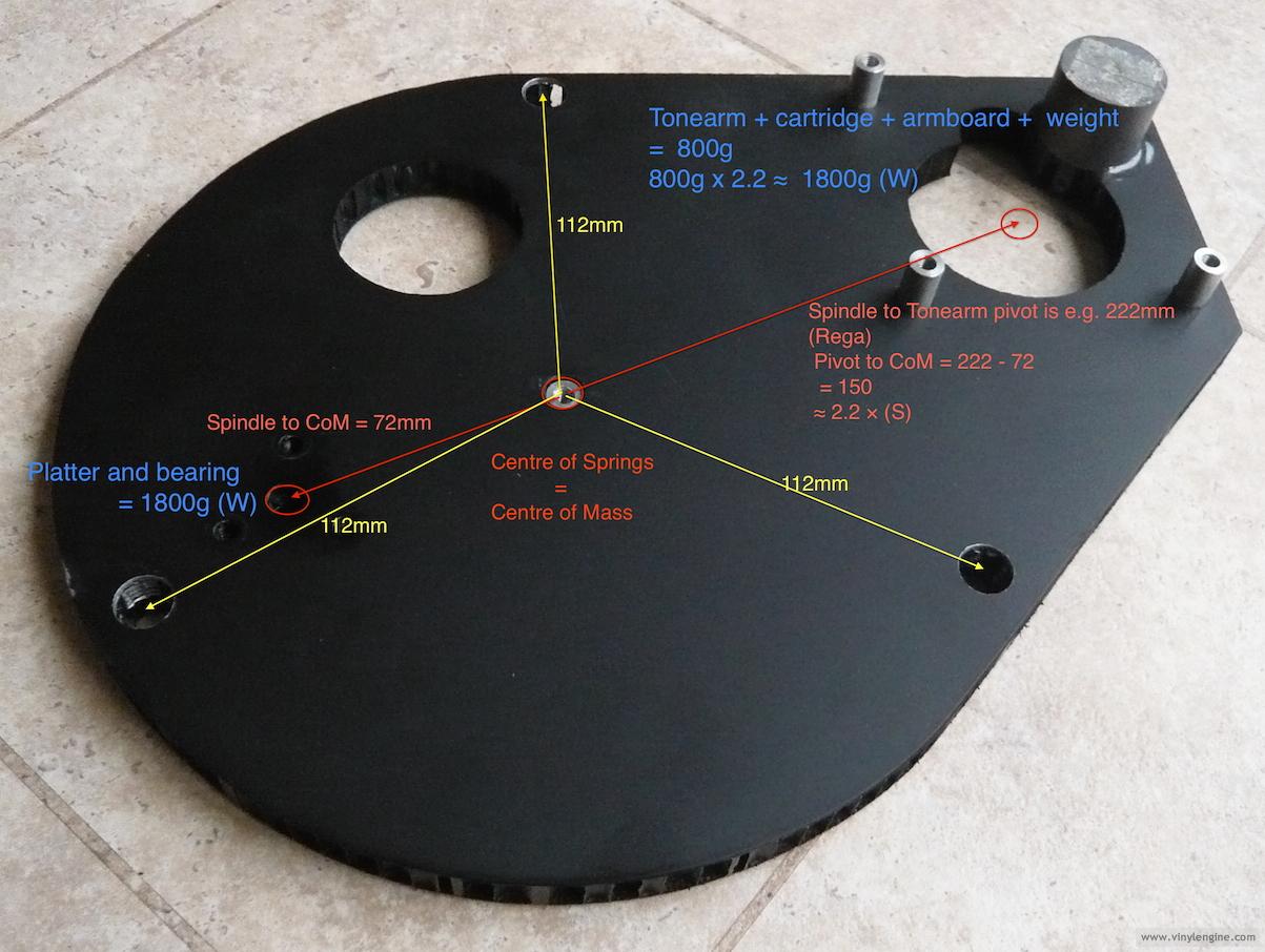

BTW . Ivor deliberately set the springs in the " wrong " position. If you set the centre of gravity at the turntable centre it is not a great solution. Often better to have no springs ( Nottingham Analogue Dias went spring less later in time. He was criticized for dynamic wow). The LP12 " wrong " springs make the setting up very hard. What seems to happen is it makes it resit rotation. It is incredibly easy to reset the mass centre of AR TD150 LP12 RD11. An outrigger to the bearing will do it. You should find the deck sounds worse ( slightly slurred ). As far as I can tell all the LP12 suspension does is isolate the mass of the outside world from the transmission loop. It does absolutely nothing else of great note. It is totally hopeless if badly set. The TD 160 was an attempt to solve it. What Ivor maybe got wrong is the TD160 springs are too soft. When I put the LP12 springs in the TD160(145) it was right in 2 minutes. All springs on centre and job done. No way an LP12 done that quickly.
