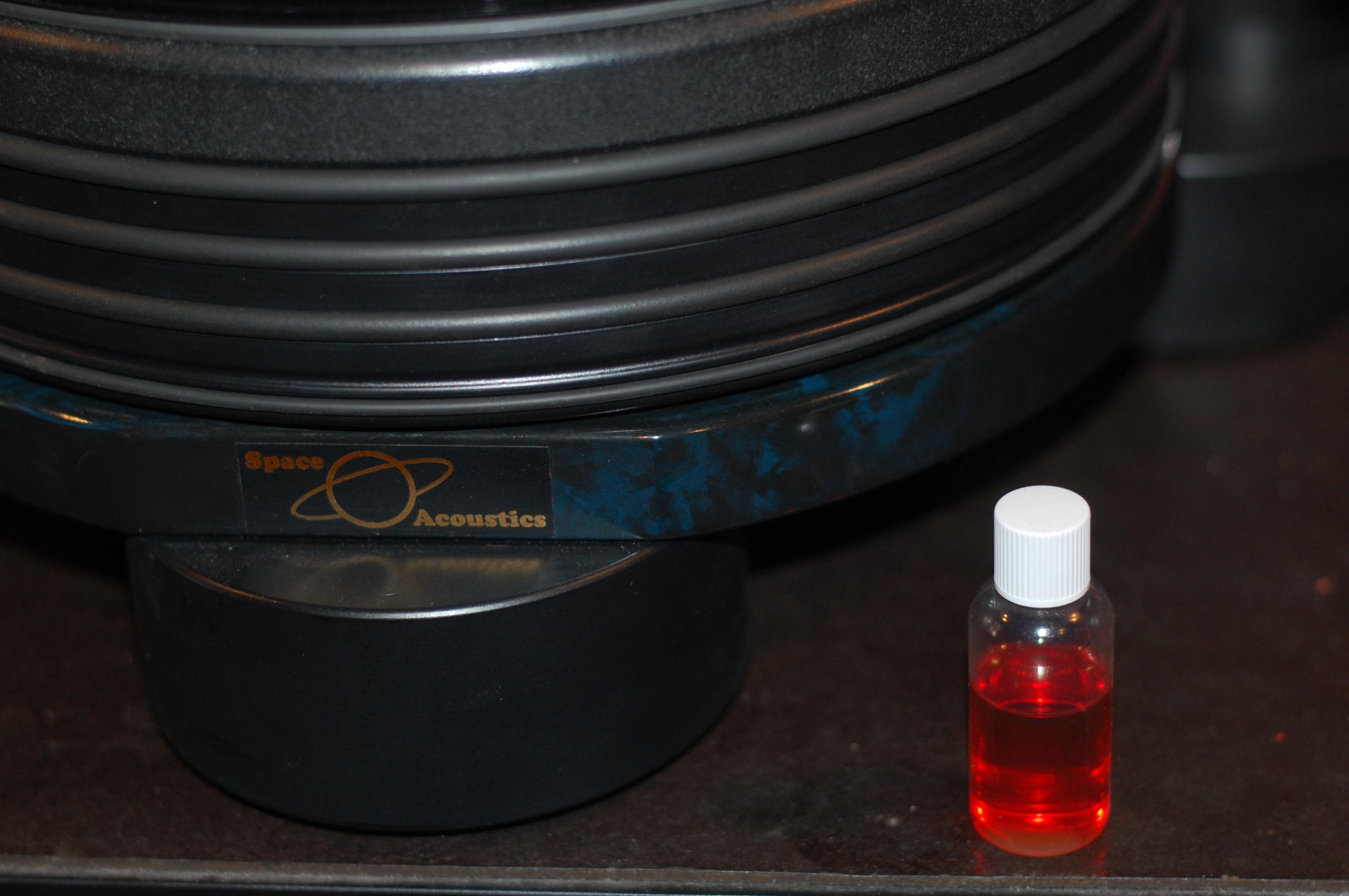

Speaking of oil, someone gave me this bottle of oil, years ago, for Hyperspace, not sure what it is specifically..Can anyone identify it?
There is no technical info for that Hyperspace bearing oil but they charge 44.6 Euro for what you have been given.
That bearing is asking for a low viscosity oil
George
no technical info 44.6 Euro
44.6 Euro
Is there someone who can help me understand this? Do they have to milk fleas to get it?
