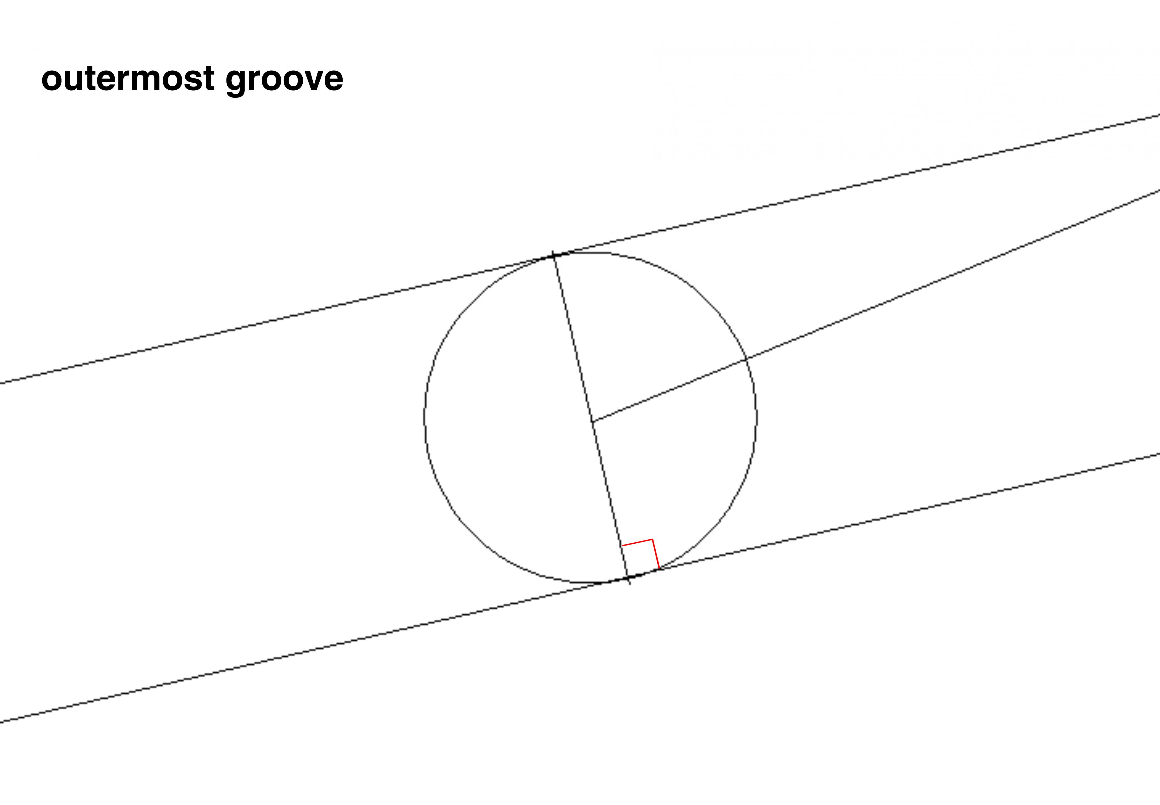

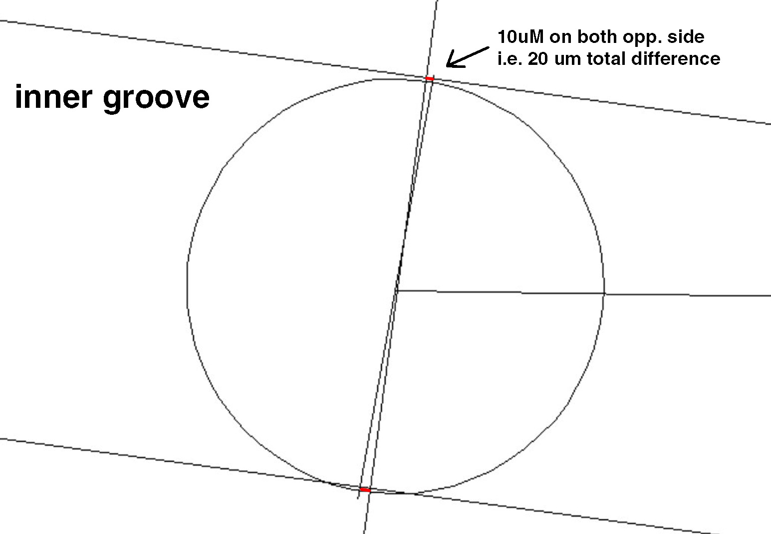

A little different topic. I did a stylus-groove drawing to see how much difference a parallel tracking and pivot arm makes regarding stylus tip touching both groove walls. I put in approximate figures of 213 mm pivot to spindle length, 20 degree offset and 220 mm pivot to stylus length. made a 40 µm groove. And a circle to represnt stylus. If placed on outermost groove both side of the groove wall touches the stylus perpendicularly. When moved to inner most groove to calculate the deviation it makes to both groove walls it came about 20 µm. So how much difference this will make to stereo information/phase difference(if mono)/tracking error (Sorry for bad graphics)
Regards
Regards
