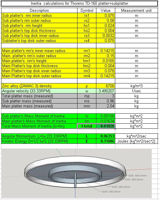

One error in all that: The TD-160 platter was made of zinc alloy, not aluminum. Zinc has a density about twice that of aluminum; I don't know about the alloy used in the platter. (There is also the matter of generations, as MkII and later had, I think, a plastic inner platter.)
Maybe there were more errors in all that :eek: (*). Thank you for the correction.
It is not alum alloy and I should have trusted the ‘signs’ (die-casting fine surface texture and feel of weight).
I have seen plastic sub platter only on TD-166. On all TD-160 I have seen, main and sub platter are metallic. Mine too (TD160 MkII, platter casting year 1978)
Zamak 3, specific weight of 6.7 (~2.5 x heavier)
I measured the volume of the main platter. It is 300mL +/-5mL.
I weighed it. It weights 2.040kg+/-10g. Thus the alloy density is somewhere btn 6.650 and 6.950 kg/m^3 as you say.
George
(*) jacco when you’ll get high, have a look at the numbers in that 3rd revision of calculations. Do they seem OK to you?

Iterations, I total : 0.03653 => 0.05304 => 0.01820
The main and sub platter both have a thickness of 4mm.
Keeping it simple :
-top disc of 300mm diameter and 4mm thickness : 1.8944 kg
-outer rim of 16,5 mm height and 7.85mm thickness : 0.7965 kg
-inner rim of 24mm height and 5mm thickness : 0.3915 kg
(total of 3.0824 kg, without the top disc added, or platter holes subtracted)
Moment of inertia top of platter : 1/2 x mass x (rm2)2
1/2 x 1.8944 x 0.15 x 0.15 = 0.021312 kgm2
Outer rim : 1/2 x m x [(rm2)2 + (rm1)2]
1/2 x 0.7965 x [(0.15)2 + (0.14215)2] = 0.016997 kgm2
(is fast & easy approximation, 1/2 x pi x rho x height x [(rm2)4 - (rm1)4] will be off by a very small amount for such a small rim thickness/diameter ratio)
Inner rim : 1/2 x m x [(rs2)2 + (rs1)2]
1/2 x 0.3915 x [(0.08)2 + (0.075)2] = 0.002354 kgm2
I tot : 0.04 kgm2 (plus something tiny)
