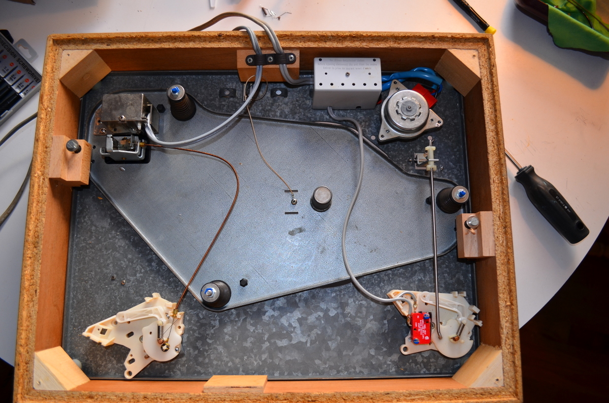

Again, I have no opinion about the Linn plinth, and we weren't discussing the 160S but the 145 (and standard 160). Here is a picture of a MkI TD-160 plinth:
There is no solid wood anywhere except the corner braces, the cable-outlet anchor piece, and the transit-screw supports. The particle board is about 0.5" thick, very light, and rings like a bell. Indeed, when Thorens produced the 160 Super, the changes they made included deeper and thicker plinth material, a thicker, stiffer bottom cover, and damping material on the sub-chassis. This is similar to what I did to my MkI -- thicker, stiffer bottom cover; 0.5" MDF battens glued in to reinforce the plinth; damping material applied to the subchassis. Additionally I damped the top plate and the inner platter.
Some who have added a better bottom cover have left at least openings for access to the suspension adjustments and the underside of the tonearm, and some have combined those into one large opening. The plinth still benefits from the additional mass, rigidity, and damping.
The whole point of the AR/Thorens/Ariston/etc architecture is to isolate the platter/tonearm system from vibration sources, be they motor, structural, or acoustic. Anything that improves that isolation is good, and the structural integrity of the plinth is a good place to start.

The volume of air with the base of a TD 160 removed is not really the point. Being a Helmholtz resonator is. As John Mitchell showed liberating an LP12/TD160 could be better. If anyone has worked on a TD 160 effectively they have worked on a Linn.
I said previously the suspension on an LP12 to my mind is mostly about isolating the stylus from mass. The mass of the platter is far from minimal so that we might call it optimum mass in the right place. Linn favour low mass ridged tables like coffee table to support the LP12. This is a very important thing. I use a very simple device from The Sound Organization made by Fabriweld. As Fabriweld made the Linn speaker stands I am surprised they never sold these tables. If you have an LP12/TD160 try without the bottom. Raise the turntable 1`inch to take full advantage. The TD160's I sold were without base and raised on rubber door stops. I said I didn't sell many TD 160. That wasn't true looking back. I was always at Gill and Co the worlds oldest ironmonger cleaning them out of doorstops. In the Inspector Morse series as part of a murder plot. The arm I fitted was ADC, a close cousin to Linn arms. The pick up Ortofon VMS20E or M20FL. The latter was a giant killer.
Thus the base of a LP12/TD160 is important. It is not just the hardboard bit. People forget the RIAA correction fights us. We have + 20 dB at 20 Hz. Also cartridge resonance. The Platter resonance of LP12 and TD160 is stated as about 25 Hz. It becomes clear that is where the problems will be. The spring frequency is about 6 Hz.

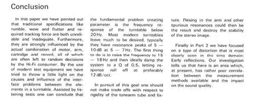

1977 B&K study of what's going on....worth reading every word. TT Design/MechanicalResonances.pdf
