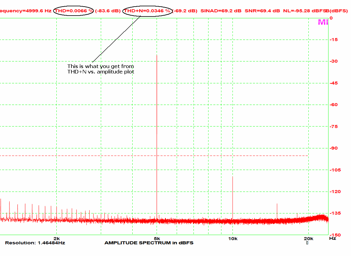

The problem here is that people confuse THD with THD+N, and noise with non-linear distortion.

Although one has to wonder, what's more realistic, a graph of THD only with no noise (impossible in real life), or a graph which includes noise, since it exists anyway and our ear cannot and does not distinguish between the two?
Even when discussing topologies, one has to wonder. For example, "revving" up one's input stage by increasing the input pair bias from say 1 to 1.5 mA, to obtain better performance, is all nice and fine, but one needs to balance that against inscreased noise level in that same stage.
My point is, noise is a realistic existing factor, like it or not, and it depends on several factors, ALL of which also influence our design choices. We can't just wish the noise away, we have to worry about it as much as about everything else.
I would be more concerned with specifications quoting AVERAGE THD within the audible spectrum. Averaging anything tends to swallow up possibly nasty peaks which may occur under dynamic conditions. If your THD is 0.001% 90% of the time, it could well be like 1% 5% of the time, and on average you'd still have like 0.05% THD.
I will easily agree that spectrum analysis is a most useful tool, even one we can't really go without, both for noise spreading and harmonic distortion decay, but as ever, nothing is ever reducable to just one or two aspects only.
As for being able to hear sound up to -20 dB below the integrated noise level, I must admit I am very sceptical about that. If noise is 10 times louder than what we want to hear, I'd say it is drowning in noise. I could be wrong, of course.
