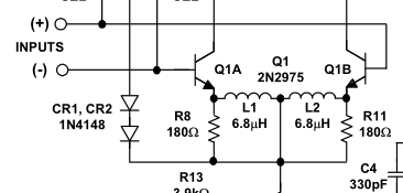

Nige, yes, I do use emitter degeneration, but (I feel) within reason. I read somewhere once a paper by an engineer from H/K's design department, which briefly stated that while degeneration of the input differential stage(s) is highly desirable, it must be kept in close check. This for two reasons:
1. The overall gain of the input stages must never go lower than 3:1, as the absolutely lowest permissible point. Go below and your sound dies on you. In my view, even that is a bit low for me, I typically do a gain of 5:1. This keeps it linear and keeps noise down, at the same time eliminating the need for any special compensation (althought in the end, it might still be needed), and
2. Degenerating the input differential(s) has a price one must pay. Reducing their gain increases the gain the VAS must deliver, and typically, this tends to seriously reduce the open loop bandwidth of the VAS and can sometimes force you to compensate by increasing VAS current to not so good levels. Exactly what that means depends on your overall circuit, but if you are using a three stage Locanthi type circuit (predriver, driver, output), your VAS is relatively offloaded anyway because of the tremednous DC gain of the three stage circuit, when even 6 mA of VAS current is quite enough. In such a case, you do have some current reserve, say off hand to about 10 mA for the VAS, but any higher and you start to need local heat sinks and very soon, you start needing special BJTs as well.
Therefore, it's a compromise you need to work out for good overall performance. Add to this the we don't really want too much current noise in the input stage, but need to balance this with what the input stage might need if driving very low loads at very large power levels, and it all need not a pint or two, but a barrel of cider to work out.
Personally, I like to drive my input differential(s) with bias currents of 1...1.5 mA per transistor, as all BJTs I use have managed almost peak performance by then. If using 2SK170, I usually go for 1.9 mA per FET; I still use it simply because it is one of the few audio FETs still in production, most others are gone, and I can find some hopefully near originals locally. It has proved its worth, so to speak, and its 40V limit is very handy.
On this broad subject of LTP degeneration, has anyone experimented with inductors in parallel with the degen resistors? I first saw this in Deane Jensen's discrete opamp (did he patent it?) - more recently Samuel Groner has picked up the idea in his own discrete opamp design.
This dates to at least the 60's with Dick Burwen. Check out Walt Jung's op-amp history.
EDIT - Model AD121 1966
Cool - thanks Scott, that's very useful. Clip of the input stage attached.

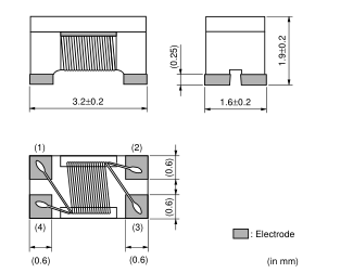

<edit> Next question - those two inductors are obviously begging to become a common-mode choke. Any takers? Something like Murata DLW31 series, 1206. On relfection though, perhaps bifilar wound isn't the best choice.
