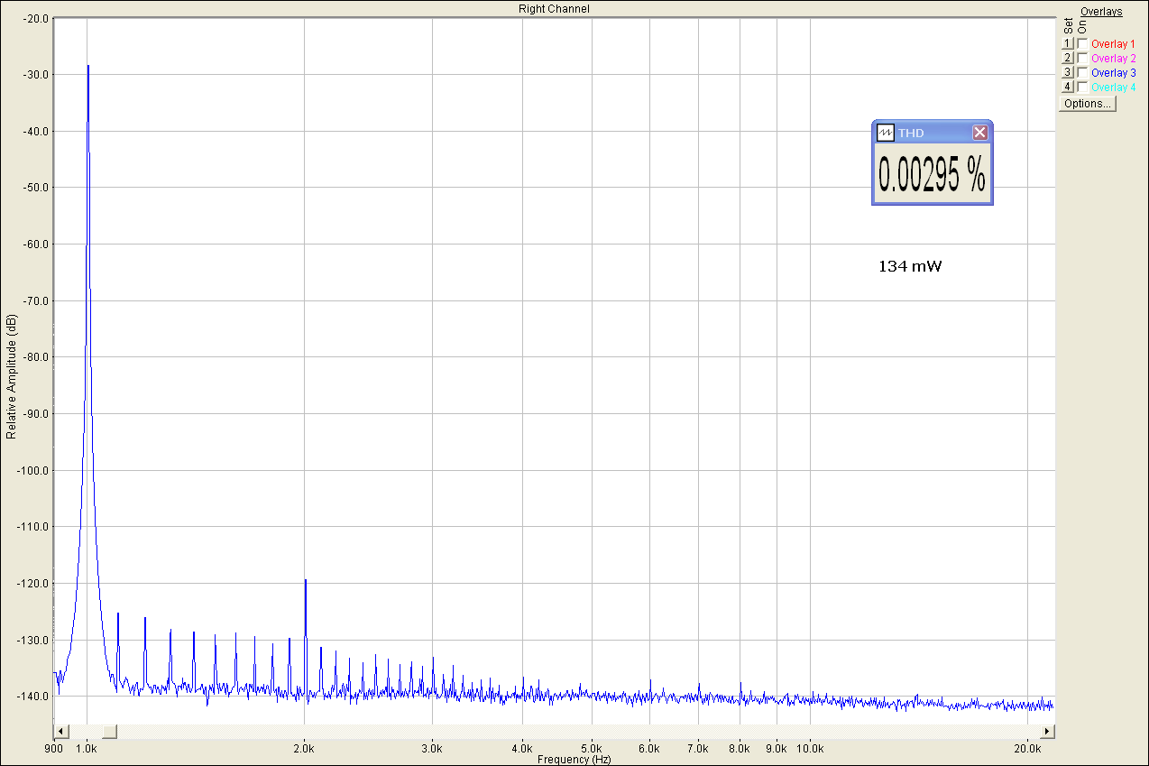

Most amps measure like op amps I find . The first watt is a great story . Alas hard to say it tells me much . Respecting it is good sense , build to optimizes this ( a La Dvv ) . The Hypex has very good sub 1 watt . In fact it goes into noise before showing a great change . Noise is a storm in some ways when class D . It took me a month to build a test rig to see that . Also the switch-mode confused the problems . I am tempted to say don't use the switch-mode . I had to because space was limited . As you might remember I call amps like this Cake Mix . I have modified the Hypex and built systems around it . My Cake Mix uses free range eggs perhaps ? I haven't listened to it yet because some mechanical engineering needs to be right first . Christmas would be ideal . I solved the switch problem . Plan A done better .
Yes , how dare me ask for a link , absurd to say the least ... :rolleyes: well it's not common to see, so forgive me .....
Sparrow's nest, so forgive 100Hz multiples.
Power output / Load ...:scratch1:
Misinterpretation, misunderstanding. You speak about noise and not about distortion. You need to learn to understand simplest measurements.
The fact that the two are frequently presented as a single entity doesn't help matters. And, from my point of view noise is distortion, it is signal injected by the playback mechanism which is not part of the original waveform, the fact that it is largely random in nature is neither here nor there - distortion is distortion ...
