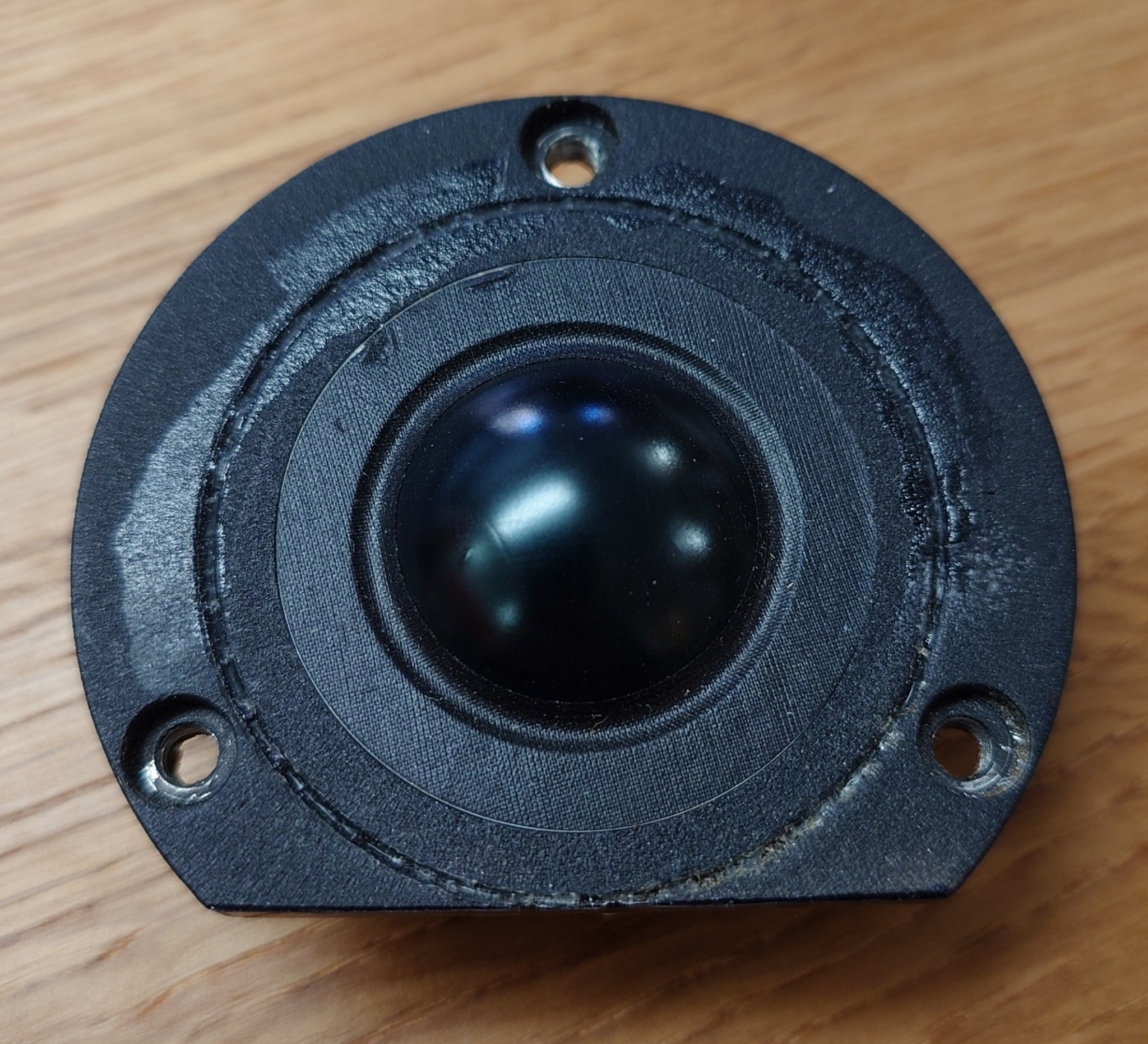

I made tests on Bliesma and ScanSpeak 26mm tweeters, they can take about 10-15W of sine power before blowing up. Power compression is about 2-3dB, ScanSpeaks Membrane get's to 80°C. With crest factor of music of estimated 20dB you get pretty high peak power at 10Wrms.
When you combine a bigger coil with high sensitivity you can achieve at least 6dB more output.
Did you actually blow them up ?before blowing up
Actually ... no.
The Bliesma was a cheap T25A type for mechanical experiments and while still working got a little damage during the process and is probably not up to spec any more. But as it looks like that at the moment ...
The ScanSpeak was actually a pretty expensive Beryllium type - but was already dead when I got it and I could repair it. (often coil "feeding cable" are getting loose from to much heat. You can solder them back on ... VERY gentle). As I was not sure if it's in spec any more it got degraded as test tweeter.
As I'm often doing projects far out of normal use of speakers my testing is a bit different to normal DIY use
