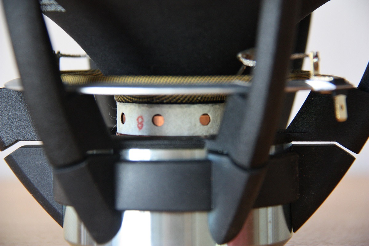

That VC looks crooked and tilted. Also the added on rear basket piece is also crooked compared to the main basket and the gaps between them. If that's what your hard earned cash buys you, then I'd say you're better off with Scanspeak drivers.Just a surround dip, nothing out of the ordinary?
Always happens with a big mismatch in mechanical/acoustical impedance.
Btw, nobody is talking about that the bottom part of the basket is 100% just for looks apparently and doesn't seem to have any function whatsoever? (look at the gap between)
That's also one way to blow your budget up

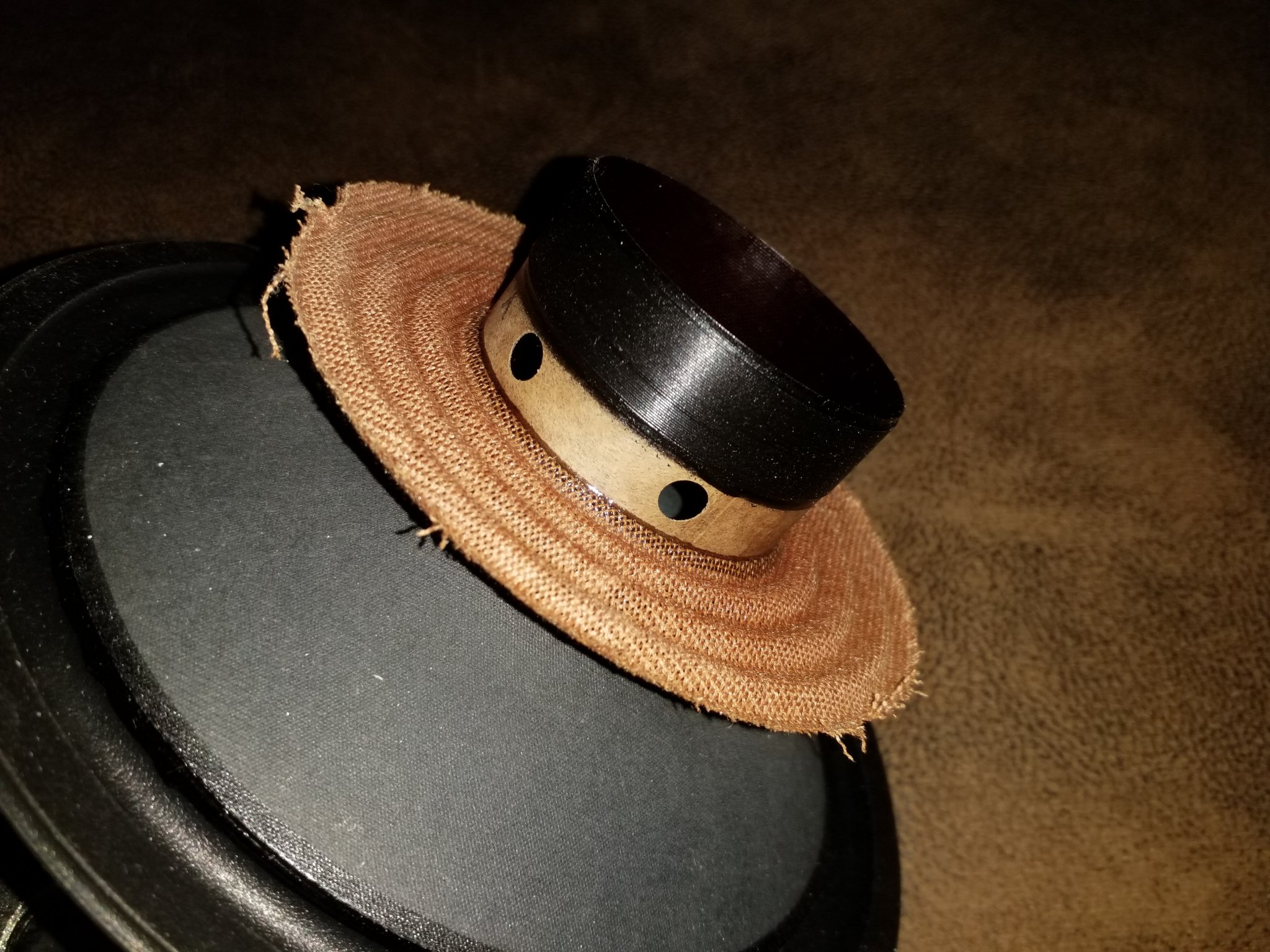

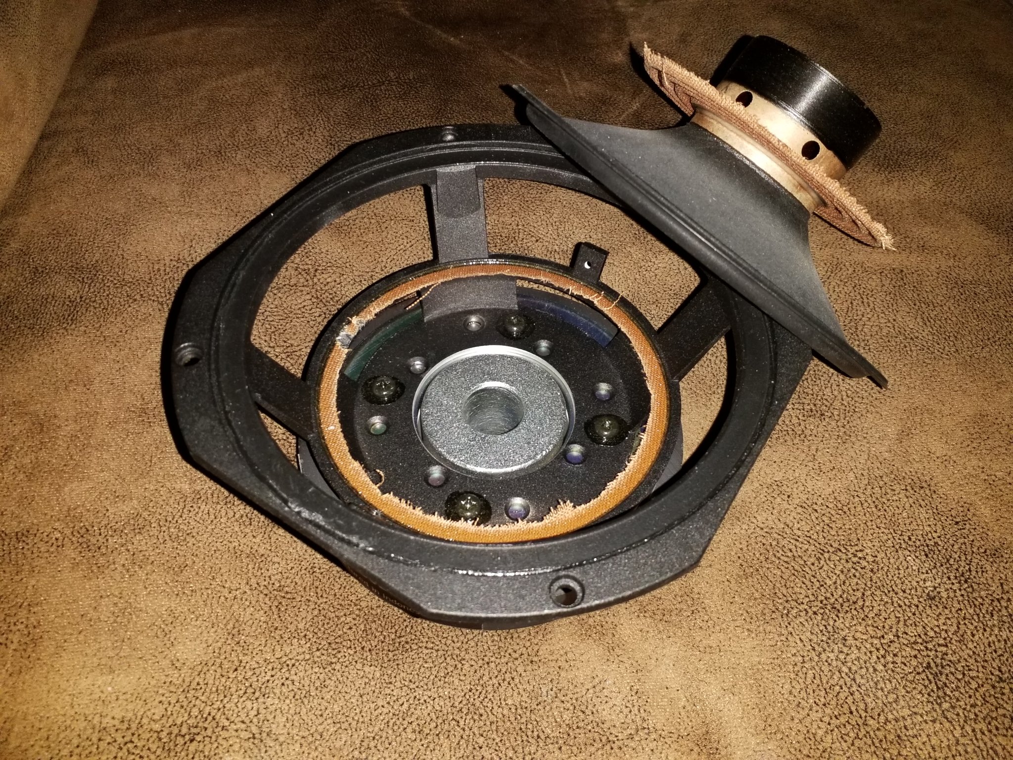

Most SB acoustics drivers are incredible value for money. Every once in a while they slip and there are QC issues. The Satori stuff is expected to be better than the regular SB drivers, especially considering the cost. I only had one driver so far with a rubbing VC, which only acted up when it was pushed harder for a while. Madisound sold me the driver and as always took care of it immediately.
In my case it was a 6MW150D. The VC on this driver is pretty stout for a 6" semi-pro driver. The dark color of the VC is a coating they apply to reinforce it and shed heat more efficiently. It looks like a burnt VC but its electrically just fine. The rubbing was from a misalignment and you could only detect it with a low mid sine wave at high level. I went through 40 of these drivers and this was the only bad one I've had so far. What puzzles me is the spec sheet claims it has a demodulation ring at the gap, but I dont see this to be the case. Perhaps they designed the basket to be part of this. I measured 0.37 mH @ 1kHz, which is low for longer 2" windings.
I can say by experience that there is not likely to be any damping by the plastic fingers around the motor because they do not come in good contact with it. In fact I have used the fact that there is a small gap between the fingers and the magnet to run nylon monofilament (like fishing line) around the magnet via the gap so that the driver can be supported near the magnet when I hang the driver in my nude dipole loudspeaker that uses it.The added on rear basket of the Satori models is a plastic moulding that press fits over the magnet. It's purely cosmetic although I'm sure someone would say something like it helps to prevent the metal from ringing.
