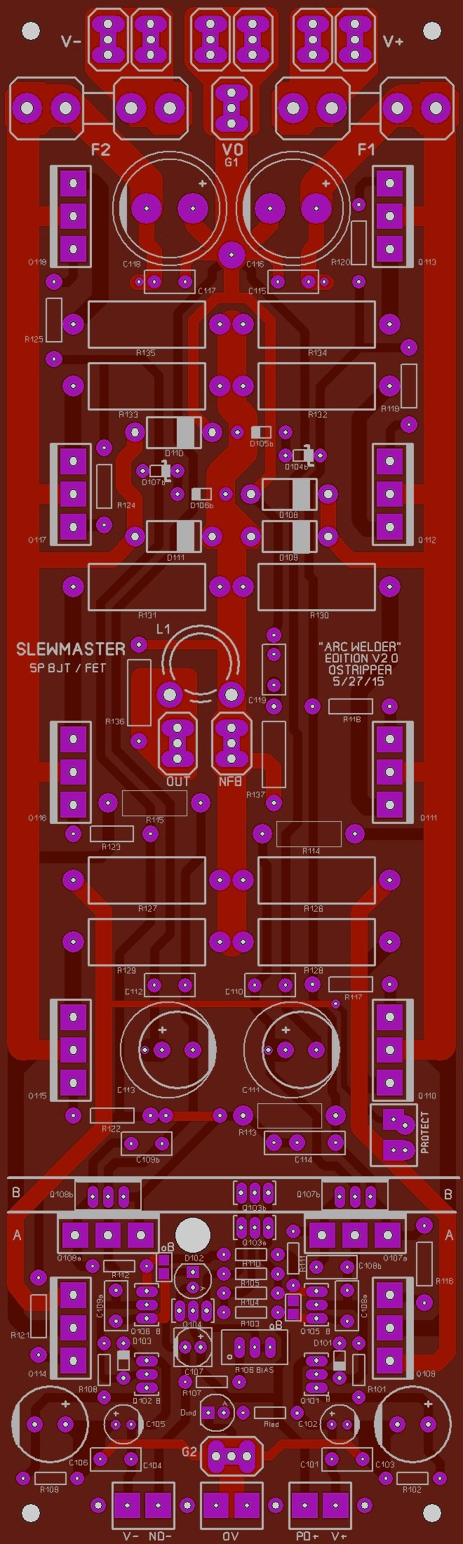

Can someone point me to the PC board layout.
I need to know the size of the boards.
Greetings
I'm not sure this is the final layout but I think the board size is set.
post #7279.
3"x10" if I'm not mistaken.

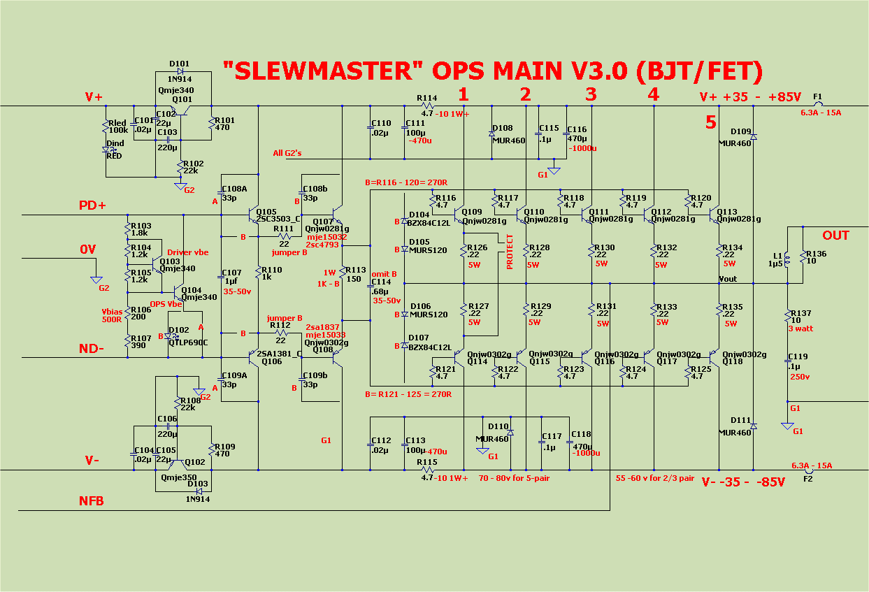

I am starting a new buy of the latest 5 pair output stage...The Arc Welder.

I look up the mentioned layout and that is with 4 pair power transistors.
The GB is for 5 pair.... or I'm wrong
I need to know the size to see if it feet my amp case (enclosure)

Sorry, I messed up that post. I thought I included a link Let me try again.
post 7629
If you look closely you will see that there are 5 pair. One is snuggled in with the front end of it.

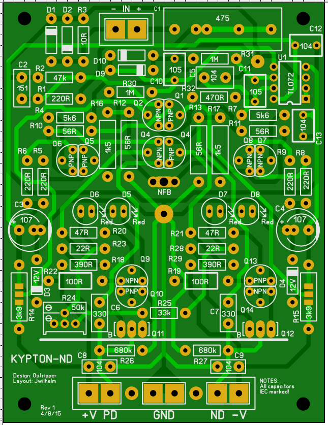

jwilhelm has offered the kypton-c file for production...Still a preliminary discussion.
Evan
I've got Kypton-ND laid out as well but I haven't had any produced yet. I've been holding out for Jason's version. His art is prettier. I can get a test batch done and debug the design if everyone would want to build it now instead of waiting for Jason to work his magic.
