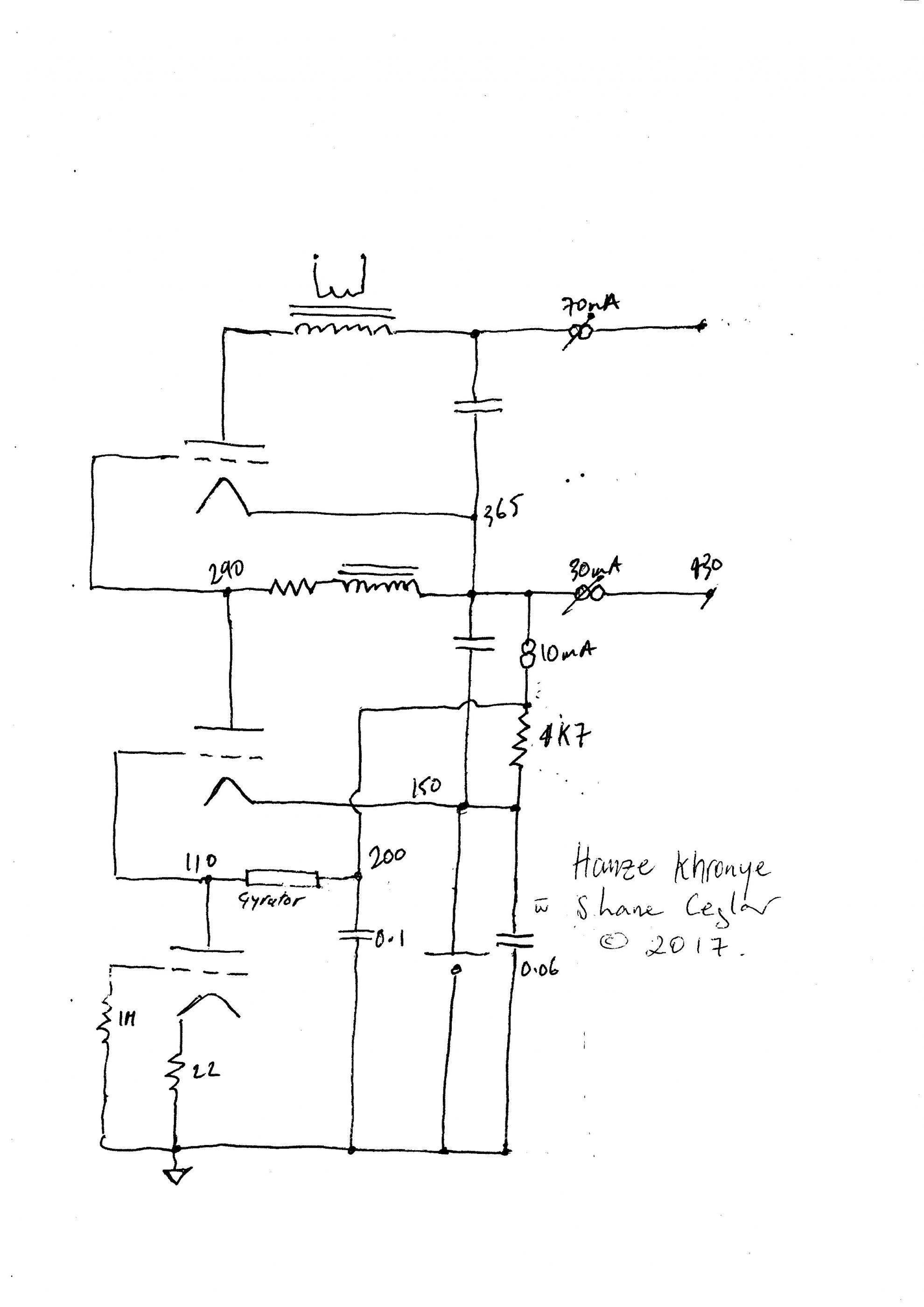

I agree with the other poster about SS devices offering some advantage. Say for example this direct coupled and choke loaded amplifier .. you can see that the whole thing would be lost without the one very unique function that the gyrator can provide... actually - it provides another function as well. Given (Ales) circuit, you can easily limit the LF to the amplifier, all to say that bi-amping - even if that is running a subwoofer to upper limit of 80Hz and limiting LF to the main amplifier itself, can be done on the gyrator board, very easily and NOT in the signals pathway.
To Soulmerchant: Thanks. -3dB at 40kHz with 10R Rk and D3a with CCS load parafeed into TX-102 v3 400H autoformer, just down from flat to (-0.91dB) 20kHz. For multi-bit DAC, I consider this like organic LP filter :)
Anyway, food for thought.. and back to DC circuits, here is my amplifier design, developed in conjunction with a friend - happy to share it.. six Coleman regulators, six 1930's tubes, so inefficient on every level. Yep, just like me !! :)
The SS device could be substituted by an inductive plate load, but it wouldnt work the same way - sorry mate, this is an edit, I added this after I see you 'changed the rules' about loading schemes. This post fully meets with the criteria as set out by the original post, otherwise you might start a new thread. It may offer some insight into how to implement the inductive loads, which you may or may not sell as retail, to help others who do not wish to be confined to a two stage design.
Hanze

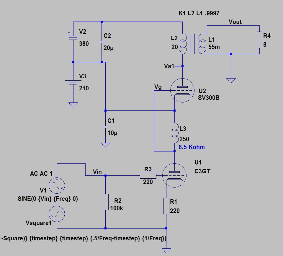

There has been very good discussion about the driver stage and direct coupling, but there has been no discussion about the output stage that I can see. While I have built the monkey/drd several times I am now listening to an amp built with the topology included on the right in message #1. That is to say, employing a big cathode resistor on the 2A3 to bias the 2A3 relative to the driver. Normally, this resistor can be 2.5k ohms to 3k ohms depending on the driver tube's plate voltage requirement. This to me is just plain inelegant engineering. So I would like to consider more elegant engineering solutions to the big resistor. For instance has anyone tried a CCS or voltage regulator tube under the 2A3 cathode. Are there any other solutions to raise the cathode voltage of the 2A3 to match the driver?
Stacked power supplies allow DC coupling and avoidance of the big resistor on the output valve.
t
I'd rather have the simplicity of one supply than double up on all those psu parts for the sake of one resistor. And of course with stacked supplies you just swap one capacitor for another. It also makes it difficult, if not impossible, to use L-W noise cancellation.
