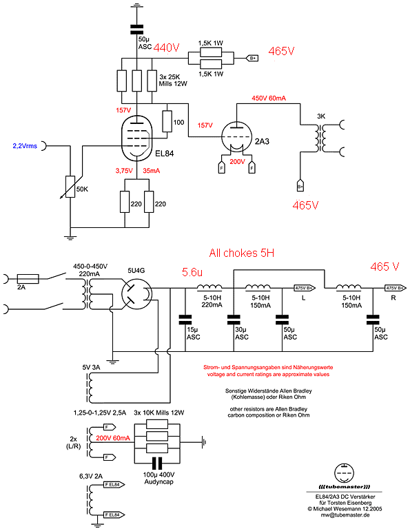

No. C3m plate resistance will be about the same as for C3g (about 2.5-2.6 kΩ in triode mode). See triode curves for both tubes.
No. With CCS (or gyrator in your case) in C3m anode, and with about 1.7Vrms at the input, you get full power from DC 2A3 amplifier.
To drive 2A3 (about 85Vpp) each tube with μ ~~ 20 is quite sufficient.
One finished very very good sounding DC 2A3 amp from my friend.
Some values in PSU have been changed to obtain correct B+ of 465V.
