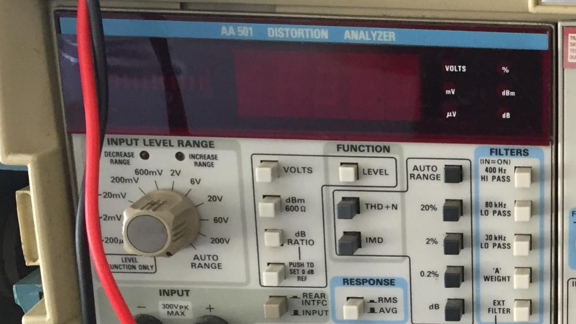

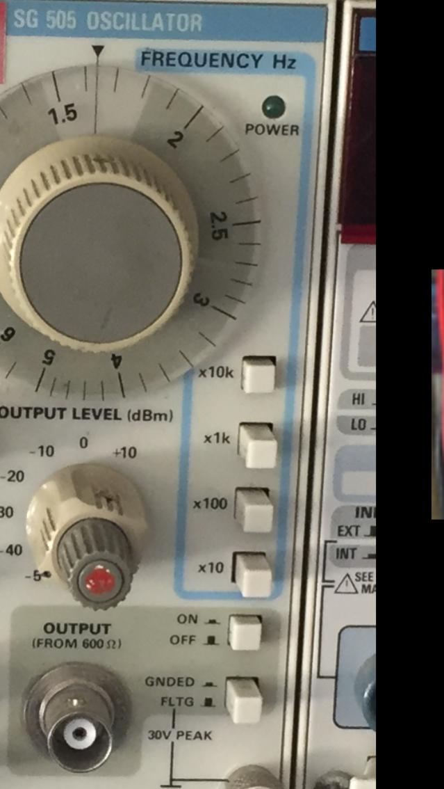

TM515
Hi Hanze
The TM515 is just a frame
The cards needed are the oscillator and anaylizer
This is not a forum for business or producers to argue they're case
Each DIYer needs to build and measure their own gear
Manufactures can measure their products in many different ways
When you build your DIY project it would be great for you to post the results while the OPTs are in an active amplifier
Maybe at 1 watt and full power with a full spectrum set of plots
Amplitude and freq response with distortion
And what test gear was used
I wish you well with this project so as to inspire others to excellence
Many who read these forums need basic info in a form they can digest
I= V/R and a voltmeter and scope from eBay is their start

Hello, I appreciate your question in regards to BW of our Truth amplifier. The fact of the matter is yes it does extend to 140 Khz and is documented as such in our measurements and as specified in our performance published specifications. Our lab tests are real and accurate. We used several test methods to determine this bandwidth. Several including one of our instruments for this measurement an HP Spectrum analyzer model 3585A actually two machines, both our lab and my associate engineers lab have the same models and independently confirmed each others test results. I would just say in closing the (many) that might suggest it cannot be done have not done the actual tests. I would also defer you to correspond with Dr. Ward of Monolith Magnetics Sincerely, Pat Whammerdyne Heavy Industries

Then feel free to mention these OPT's, the manufacturing processes they employ, etc. with real measured data, plots, details of measurements, etc. Believe it or not, there are many people who wind their own transformers on this board and they can share quite a bit of experience.

Also, don't forget the transducer or the source. I do some of my own measurements using a microphone, external soundcard, freeware and a laptop. Quite decent professional spectrum analyzers of yesteryear can often now be picked up for a fraction of their original price too I hear.
