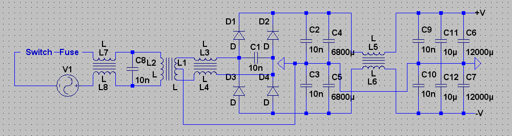

I would separate L5 from L6. There are some suitable 6A
power supply chokes in your box shipping today...
I don't see your transformer couplings K1 etc.. Stated
anywhere in that screenshot.
That said, I don't see the purpose of "K3 L3 L4 1" as this
coupling is already assured by K2. Reading K's left to right.
Everything from the wall up to but not including the diode
bridge, already encapsulated in a metal brick with IEC (PC
power socket), switch, and fuse. This is also in the box.

There are no coupling commands. If the inductors are joined then they are coupled. I didn't simulate this. Why separate L5 and L6? I thought this improved line regulation.

Don't connect any big caps to those power supplies till you have measured the
actual polarity of the outputs. I don't think those supplies are well marked, and
the spec sheet shows entirely different style connectors.
Big caps will create a serious mess if mis-oriented. Considering unknown time on
the shelf and in the warehouse, you might even want to re-form the dielectric
barrier on a lower, safer voltage, before allowing them to charge fully.
I'd also slap a bleeder resistor across each, so they will be safe for screwdrivers
in a known RC time constant. Even if the circuit they are/were in fails to bleed
them due to blown fuse or other open circuit...

Do you mean the switchers you're sending?
I powered up both of those amps and nothing bad happened, so the caps should at least be good at the amp voltages. How would I reform them? I assume I can simply apply a constant current and let them be for say, a day or two (one of those CCS diodes would be perfect for this)?
What size resistor should I use for bleeders? I don't have anything more than 1/4W types, though I could go to Radioshack and get a specific value.
- keantoken
Sending? Sent. You havn't opened the 1st box yet??
You won't be needing no resistors from the shack.
I speak of the 68,000uF halfsize coke cans... No telling
how old those might or might not be? So take care the
first time you apply power. They can release enormous
energy, more than enough to injure your eyes or hands
if one decides to pop... Treat like an M80 firecracker.
Bleeder can be small wattage, 1/8W fine. We speak of
100K to a Meg across the terminals. No large currents.
Just a path of last resort that will eventually discharge
the cap to make it safe for screwdrivers.
