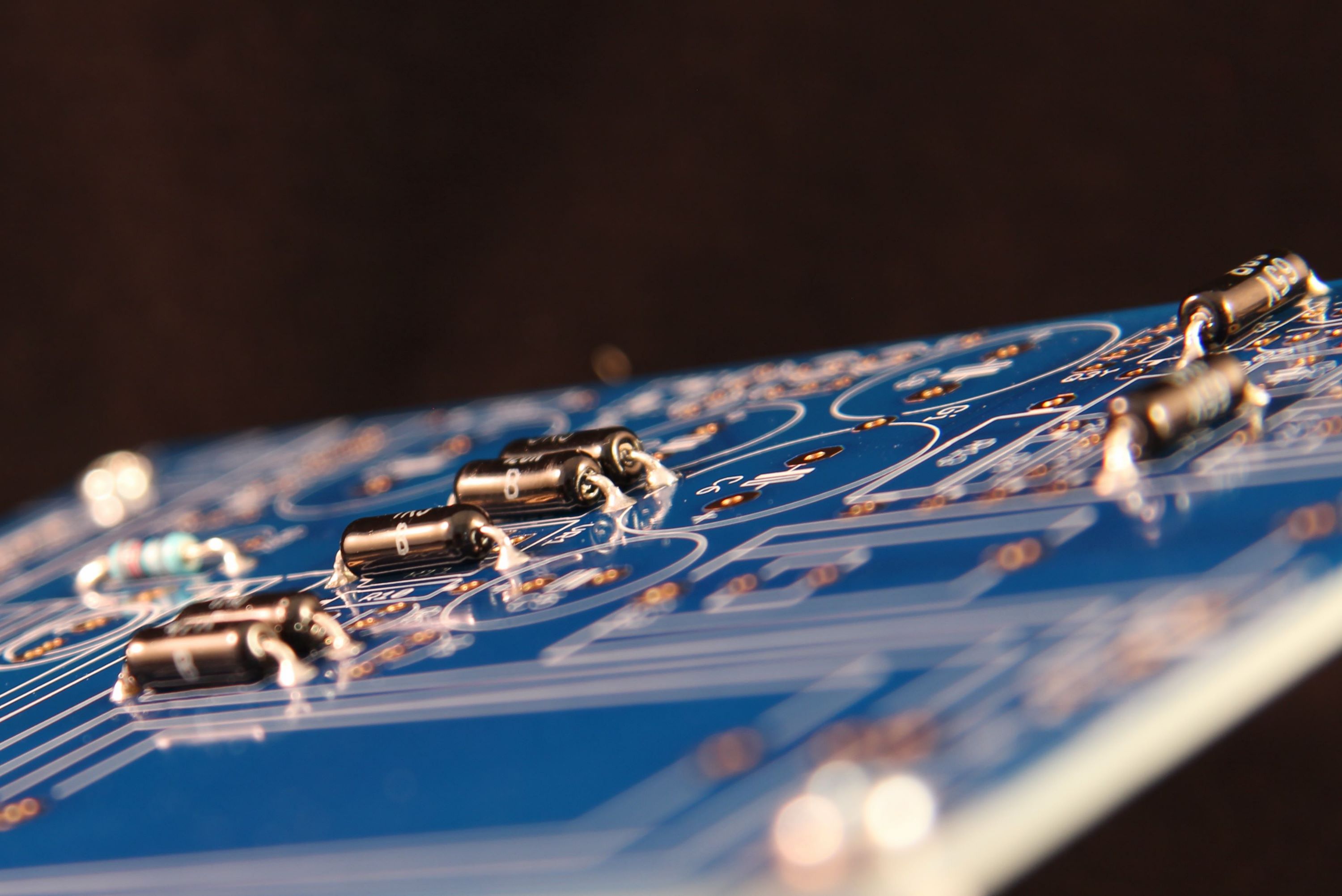

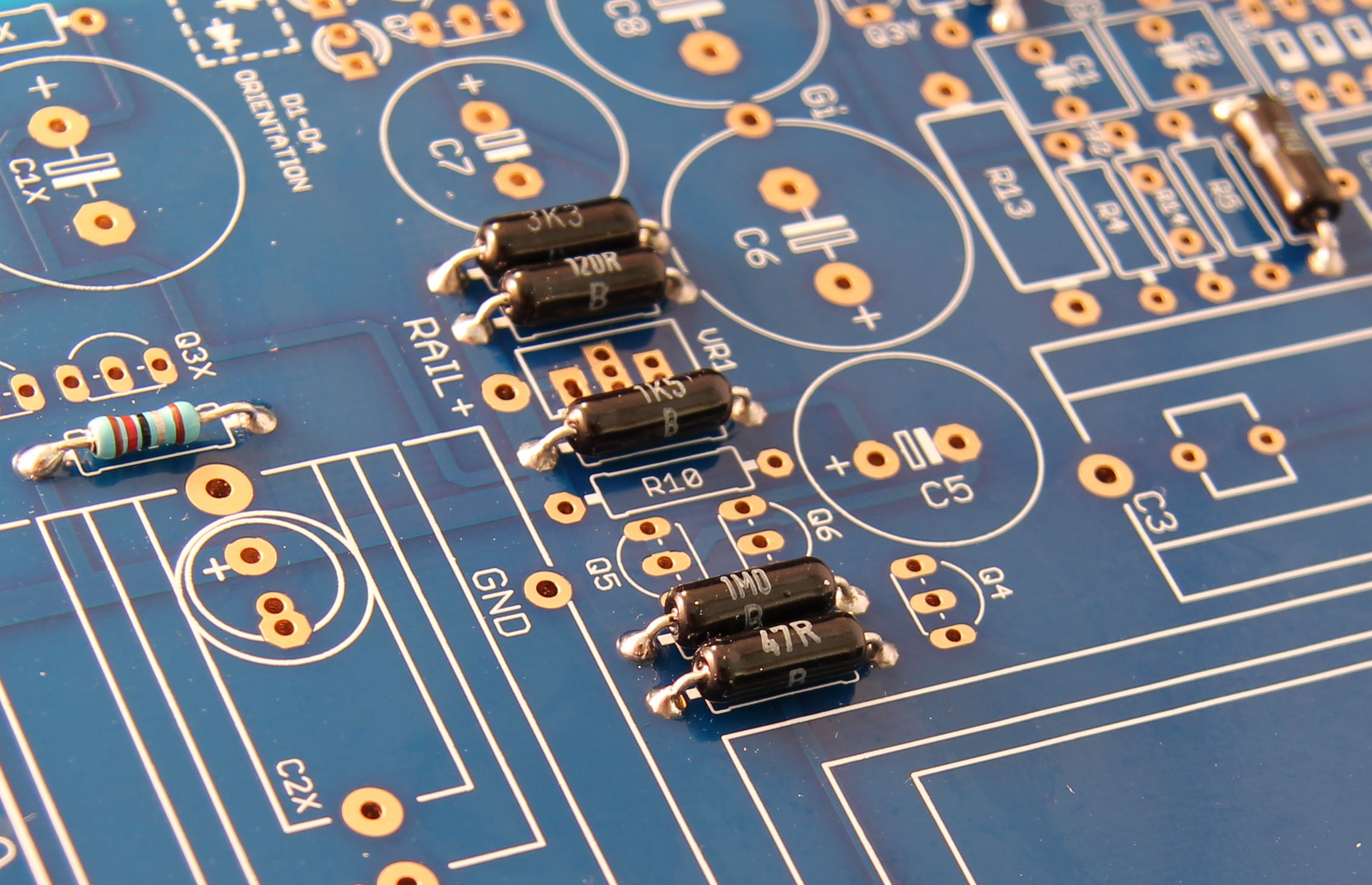

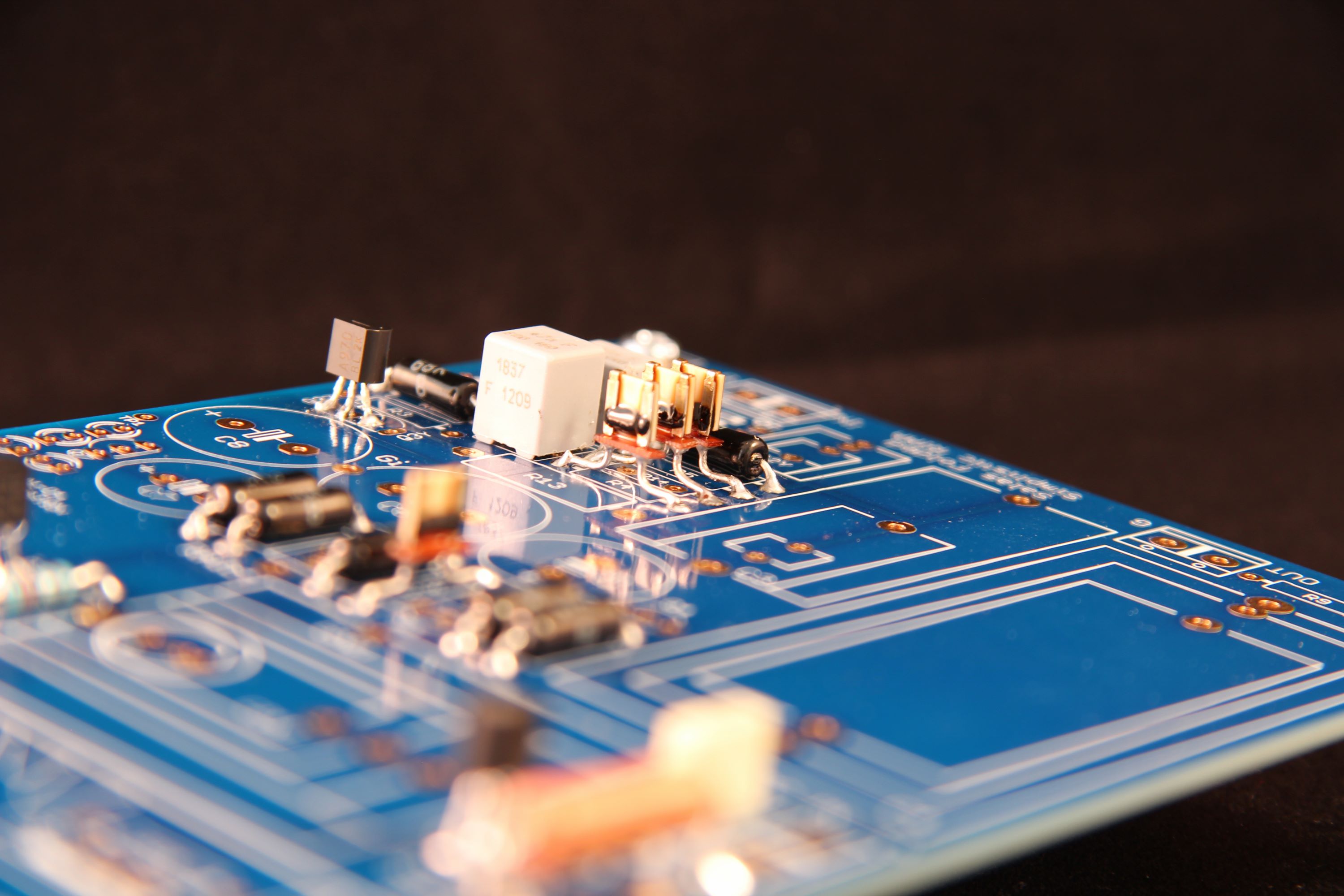

Looking at the parts I got for my second build. A very nice kit indeed - thanks TB! .I believe I'll wait for the watercooling part to materialize before I start :D. As always keeping an eye on things.
Hope to find a quite period where I will change C3 from Obbligado gold+ to Mundorf SGIO's and replace the cooling blocks to standard from what I've been using. As I now have a probably:))) reliant LCR meter I'll check the C2+C2Y combo and better it if needed. Of, course I would like to know if there are other findings amongs the builders that I could take with me in the review...

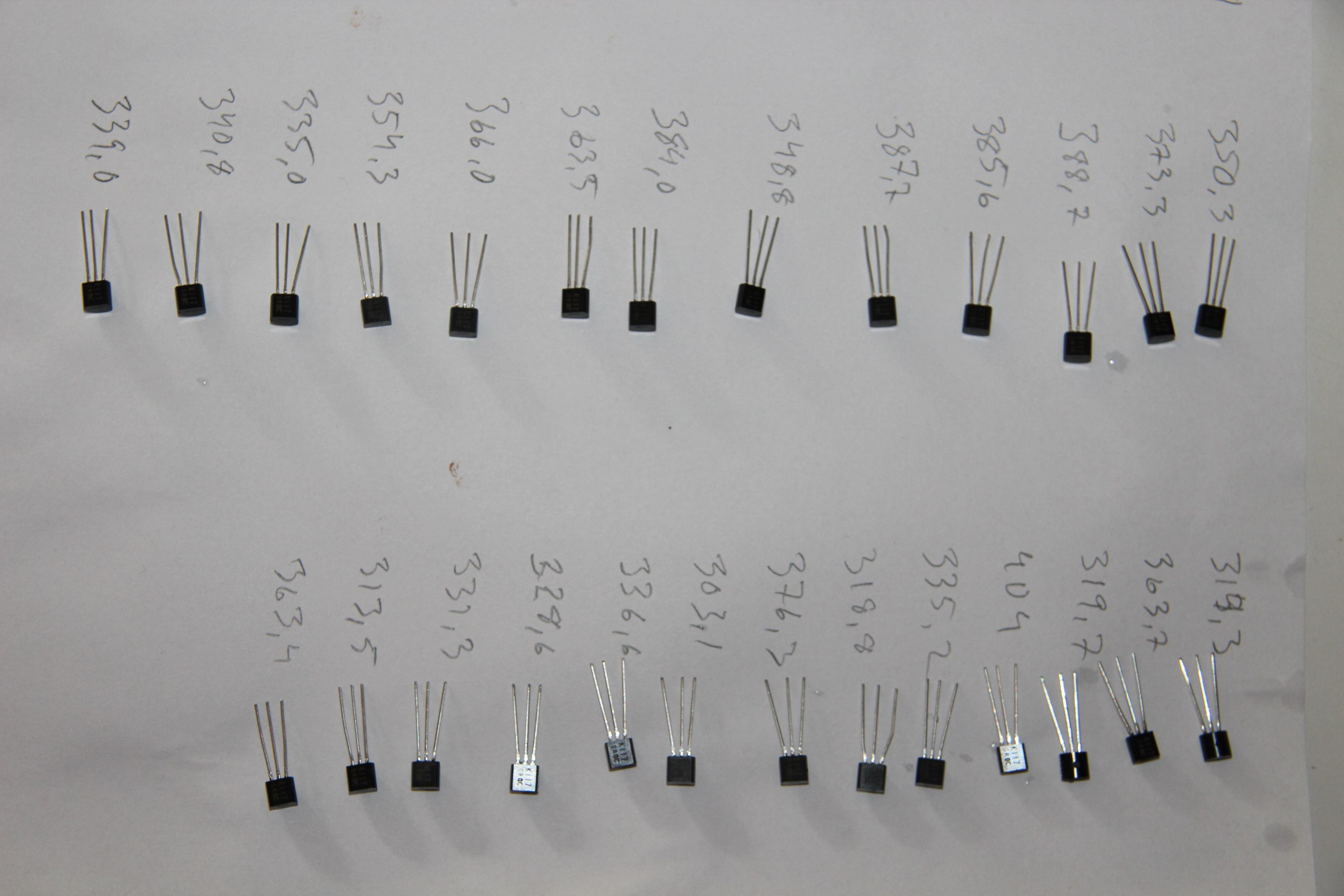

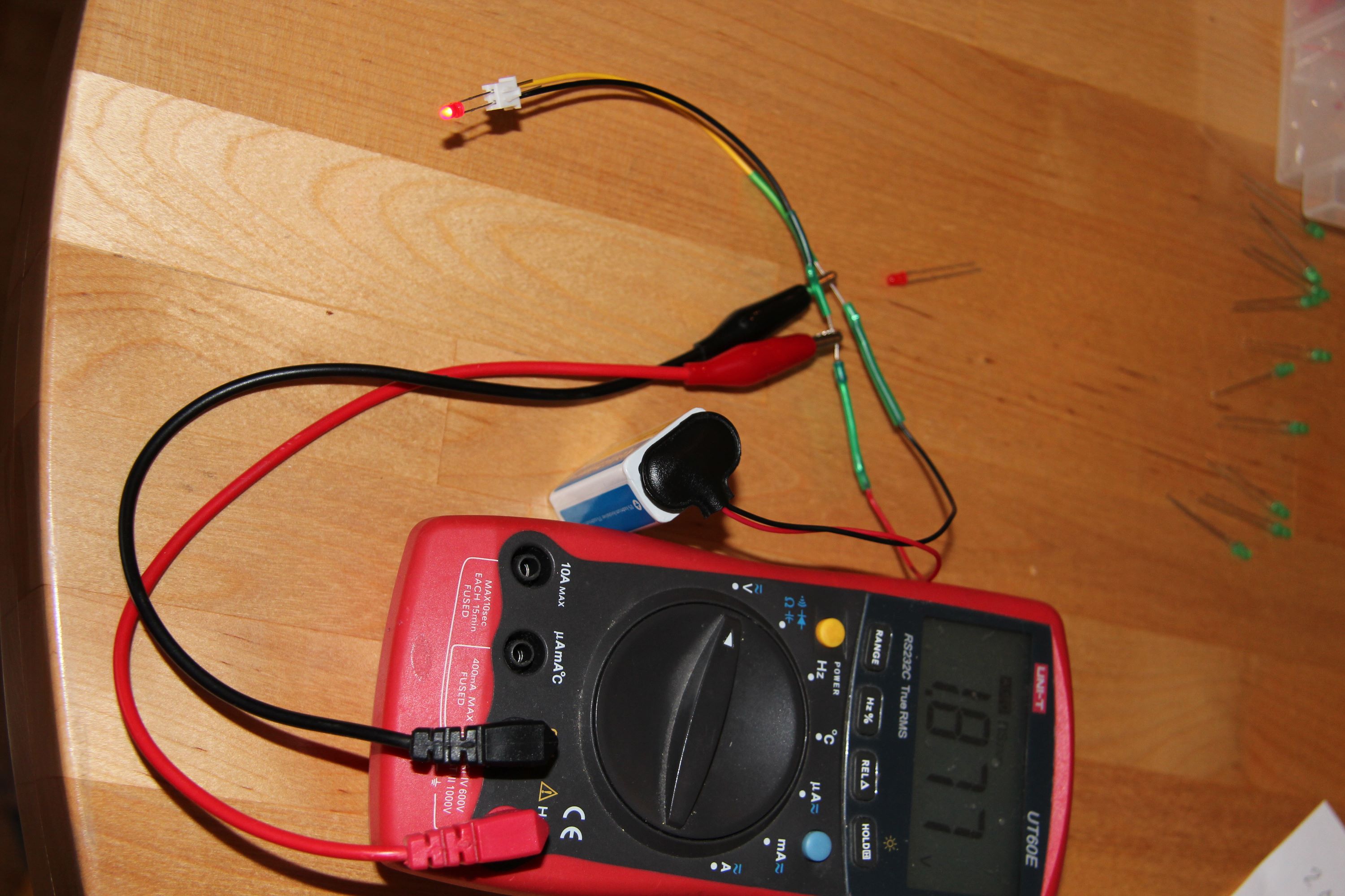

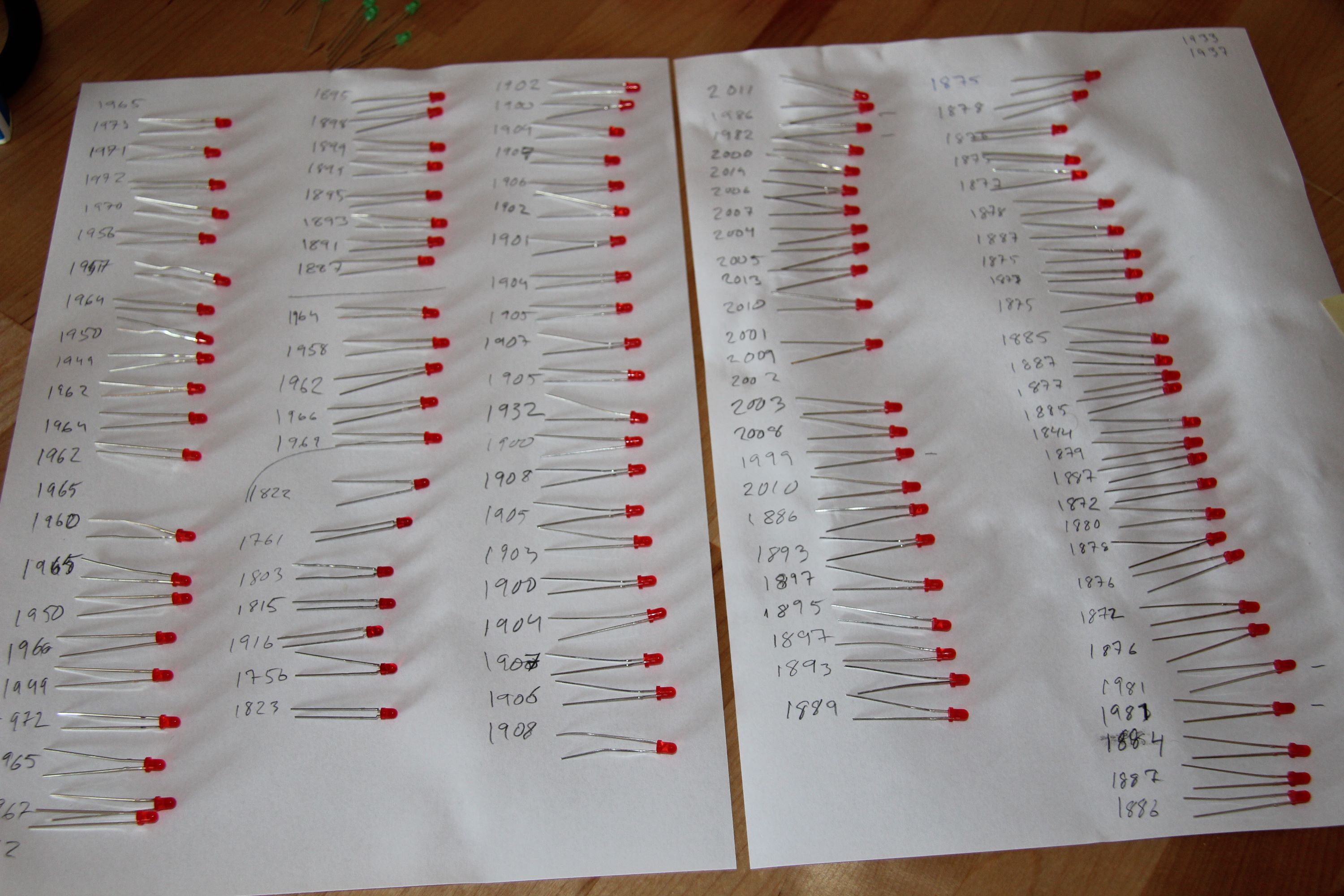

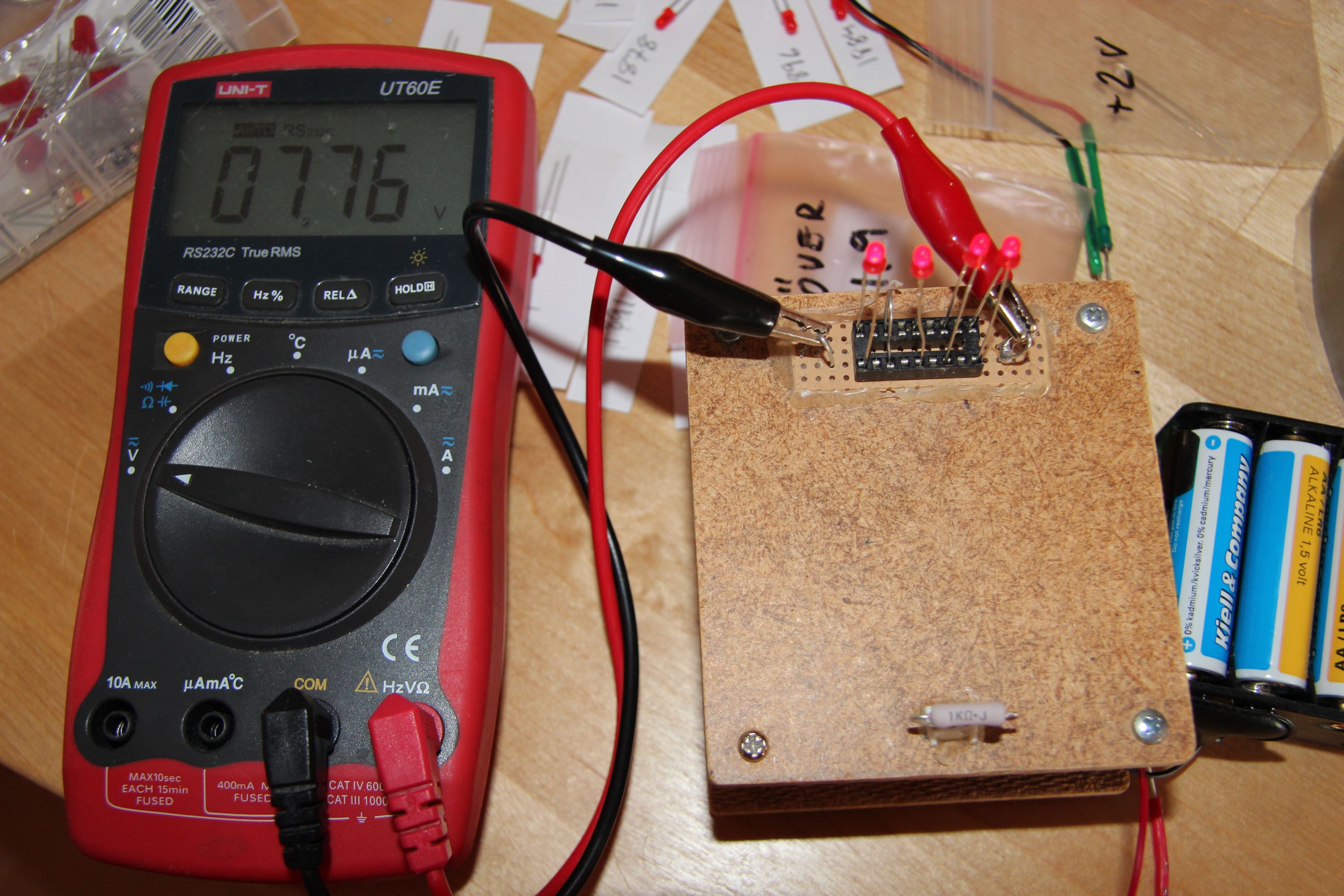

Some population, K117 and LED picking. Is 1k in series with triplets and quartets and a 12(,5) V battery supply a valid configuration for picking the leds? I got 7,76 over the leds in this example and 4,74 over the 1 k resistor. 4,74 mA.

Joined 2011
Thanks Merlin.
I experimented a bit with load resistors and I got some slightly different voltage over the triplets and quartets depending how many milliamps it passes. LEDs usually do this. Does anybody know how much current each shall pass in the build so I know what to load with?
For picking the LEDs, first select your Q7, then rig it up as a ccs in series with 2 x 9v battery and the triplet in sockets like you showed. Then you can measure the Vf drop of the LED string in very similar conditions to the actual circuit.
