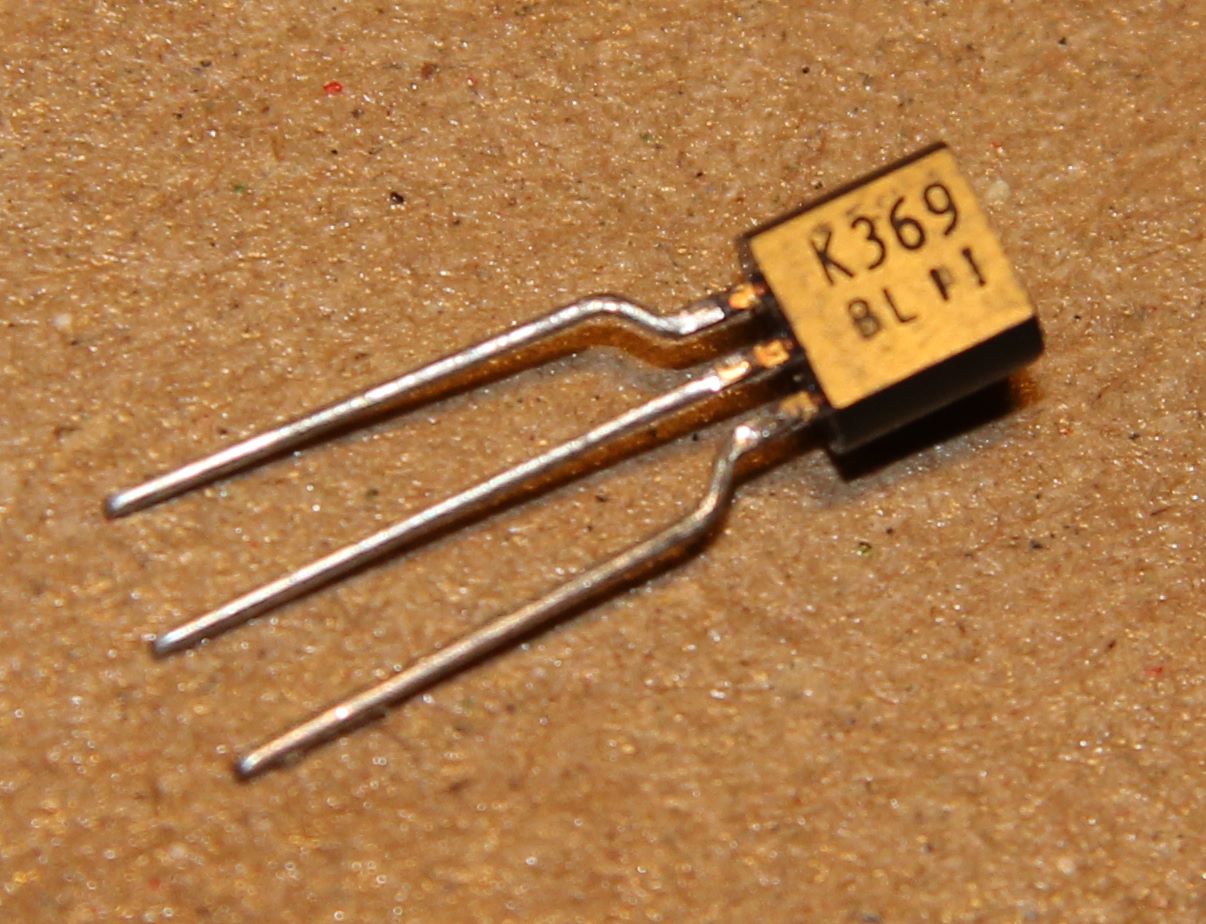

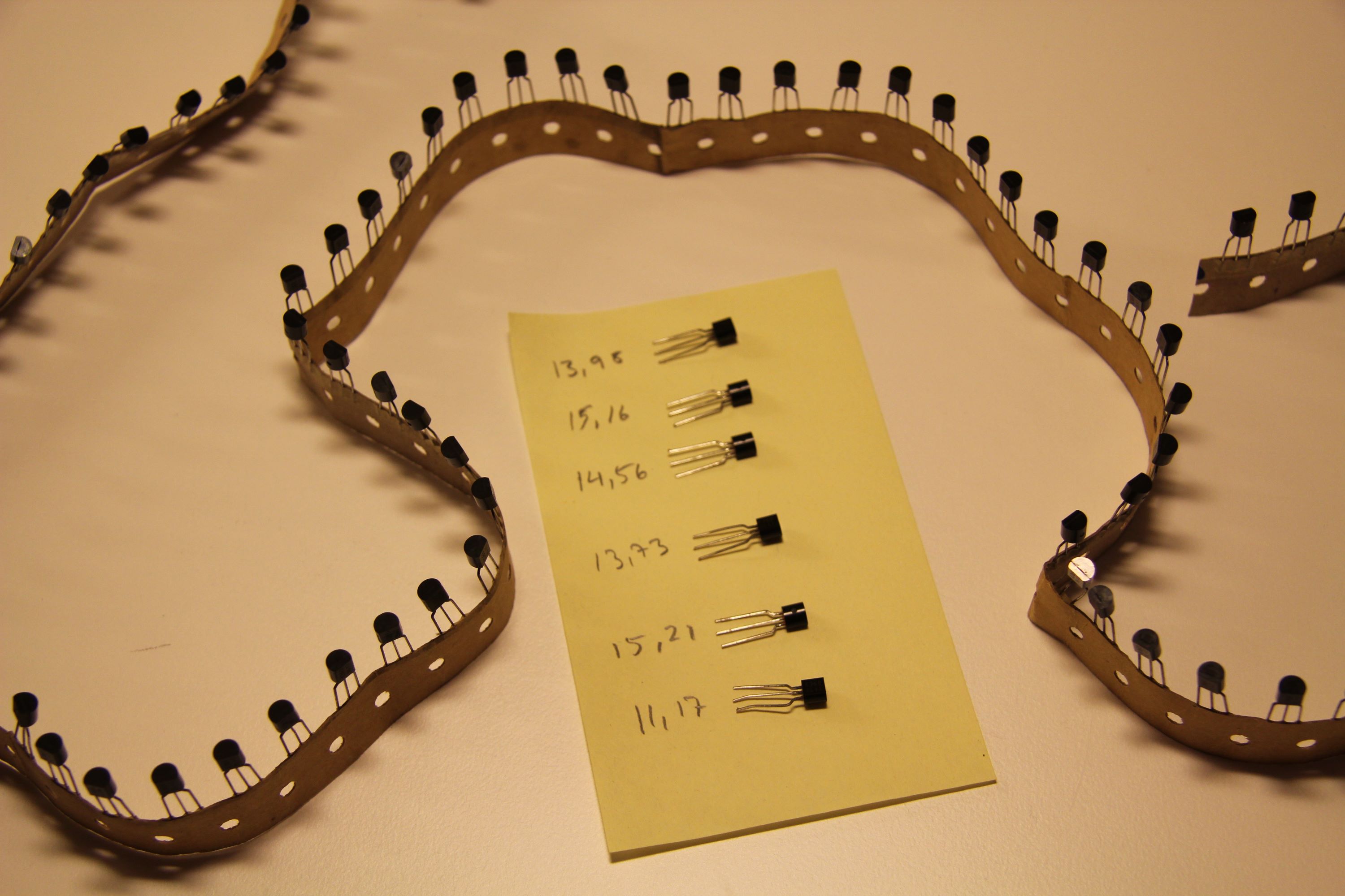

Came home from a trip and found that my china 369BLs had arrived. 100 pcs, I quickmeasured some and got those Idss values. Is there any way to tell if they're the real stuff?
